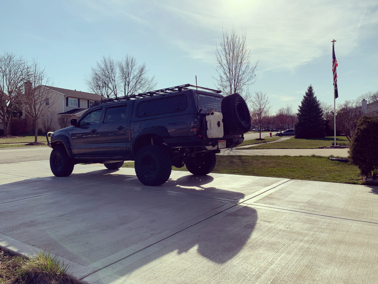

    This. Moved from HD Dakars to stage III U402's

    Rig looks sick! What size lift and tires you running there?
  10. Jun 10, 2021 at 12:16 PM
    geekhouse23
    geekhouse23 The "Liftman" - @DrFunker
    Jul 14, 2013
    #108251
    15,706
    2GMGMDCSB4WDTRDFTMFW!! TL;DR
    mostly stock, grocery gettin' Prius
    3" and 285 75 16's

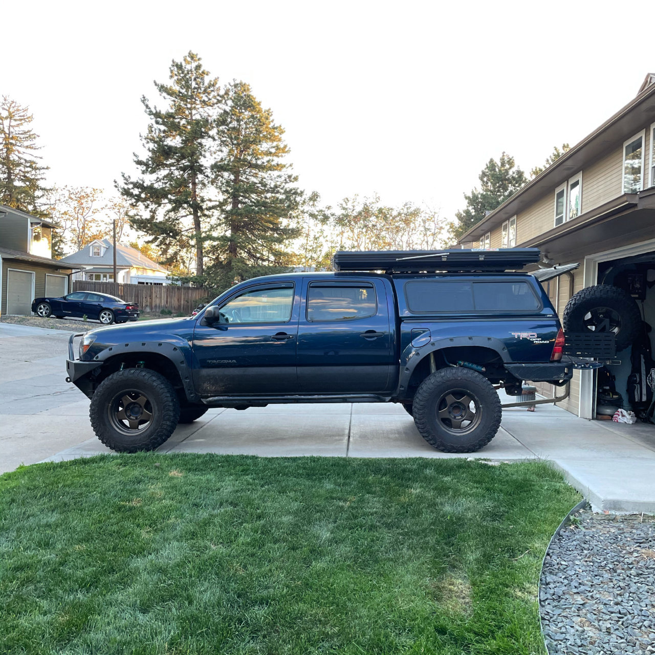

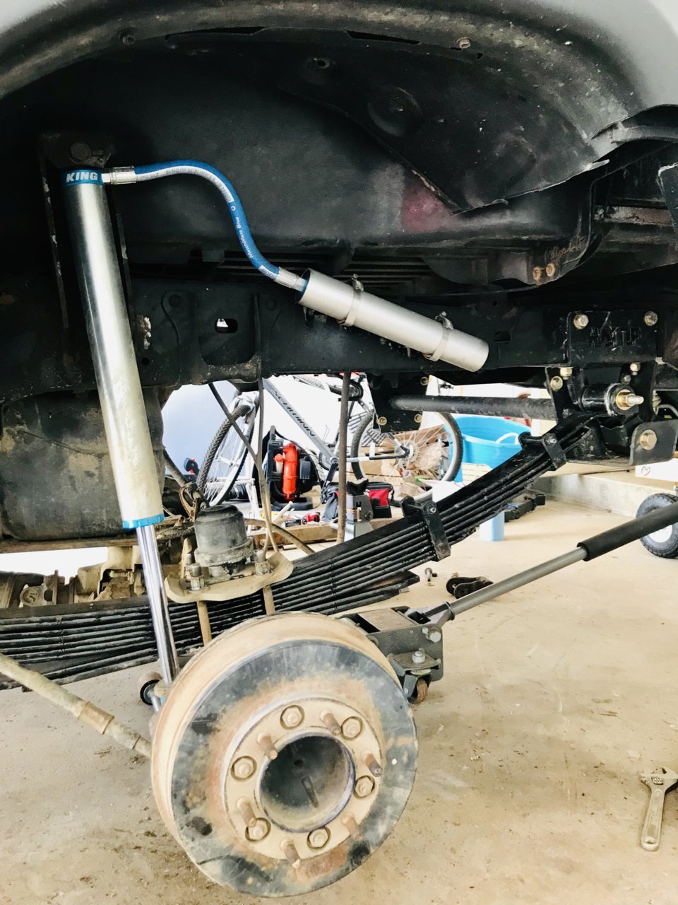

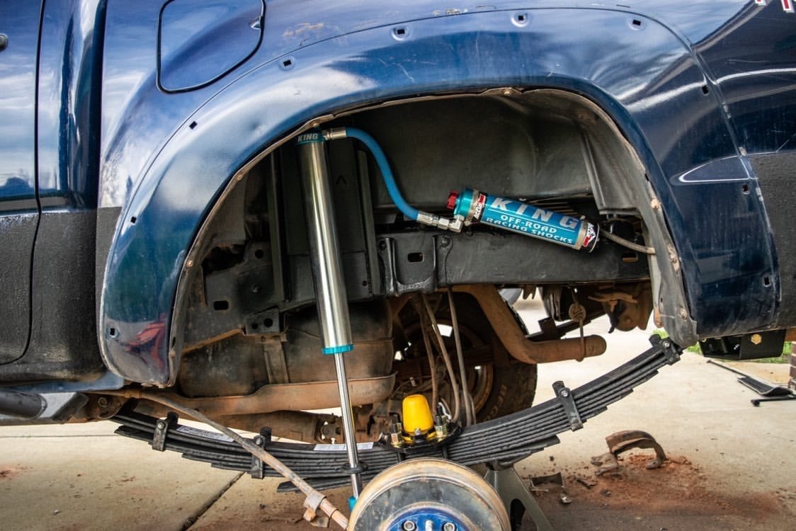

    I am happy to give you a hand if you want to do it during the week, I pretty much camp every weekend but if you want to tackle it after work hours I am more than happy to help. I did a full lift (UCAs, leafs, front and rear suspension) on my buddies 2021 in 6 hours on a sunday so we could easily tackle it over a couple days... I love working on trucks so really no sweat if you want to give it a go.
    I don't have a cement so that wasn't me, here is my rig. AD080929-ADEB-4EAF-89C1-E1EEABE54393.jpg

    These deavers are recommended for 3 inch lift, most folks that run them have either a lift or shock relocation, its one of the few progressive leaf springs on the market, also I did a shock relocation so I can use the full 12 inches of travel and I actually didn't need to strap my rear smoothies due to the deavers acting as limiting straps. Probably wouldn't hurt to strap it but more than likely overkill.
