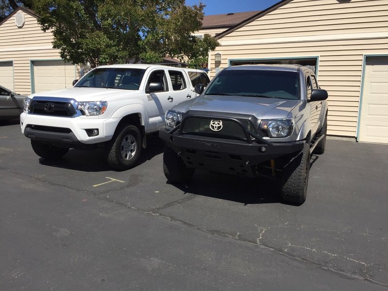

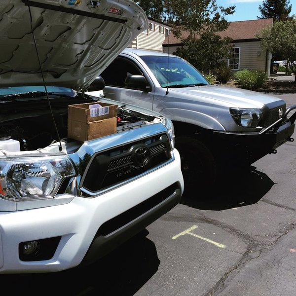

    @JimboAnz
    885 on a DCSB with plate bumper, sliders, RTT and a bed rack.
    About even with my front end. I may be a little taller but not much.

    Worth mentioning he also had some audio mods done and guessed his overall weight increase to be around 1000 lbs over stock.
    My lift up front is 1.75" in those pics and an 885 is a 3" coil.

    Since I'm rolling in info and have a minute.
    My measurements.
    DRear 23"
    DFront 23"
    PRear 23.25"
    PFront 23"

    @tacomgee went with All Pro standards.
    He owns the silver truck I posted above. He hasn't installed them yet but may have some info to share at least on why he went that way.
