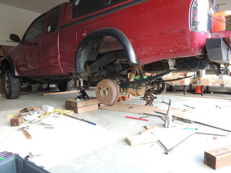

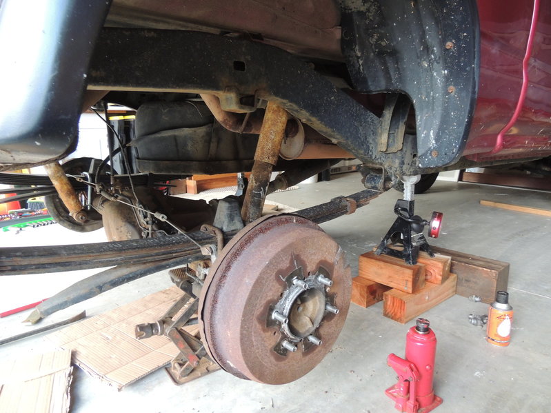

    I carry alot of weight around in my rig- around 500# with a topper, I just swapped the second AAL- first broke in 2 places during the full OME w/AAL install. Before the swap I had a 2 " lift with the hill country shackles- 1/4" x 1.25" strap substitute-previous owner- they pack had a negative arch with the AAL and 2" with the shackles- So far so good, shocks are next on the hit paradeDSCN2854.jpgDSCN2857.jpg
