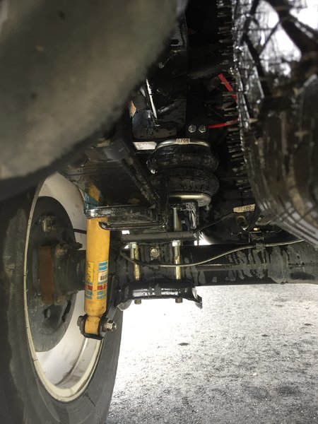

    Get ride rite air bags, load whatever you want and level it out with more or less air.
