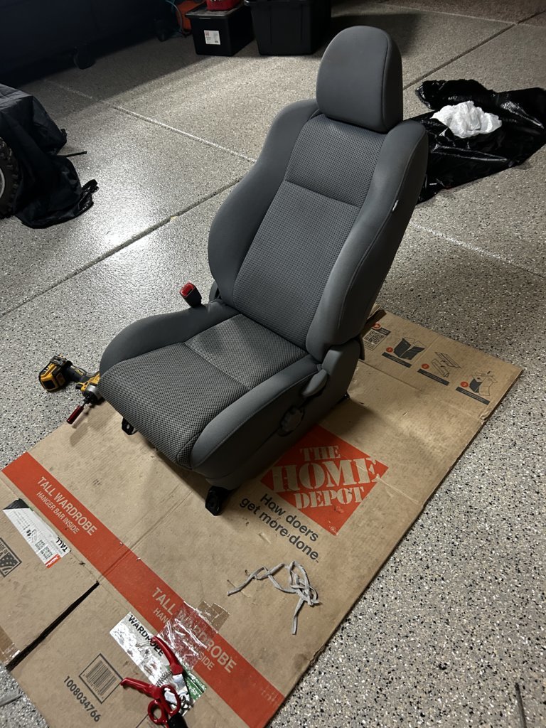

    I put new fabric on the lower portion of my seat it was easy but annoying Toyota sells the foam and other companies do to the foam it’s just held on with Velcro when
    seat fabric is off.

    Sorry to derail but what replacement fabric did you go with? Looks good

    One off eBay
    One from eBay that someone recommended to me it’s not perfect fit or color but close enough .it will probably fade and match the top part of the seat. Make shure you get a hog ring tool to secure the seat fabric.
