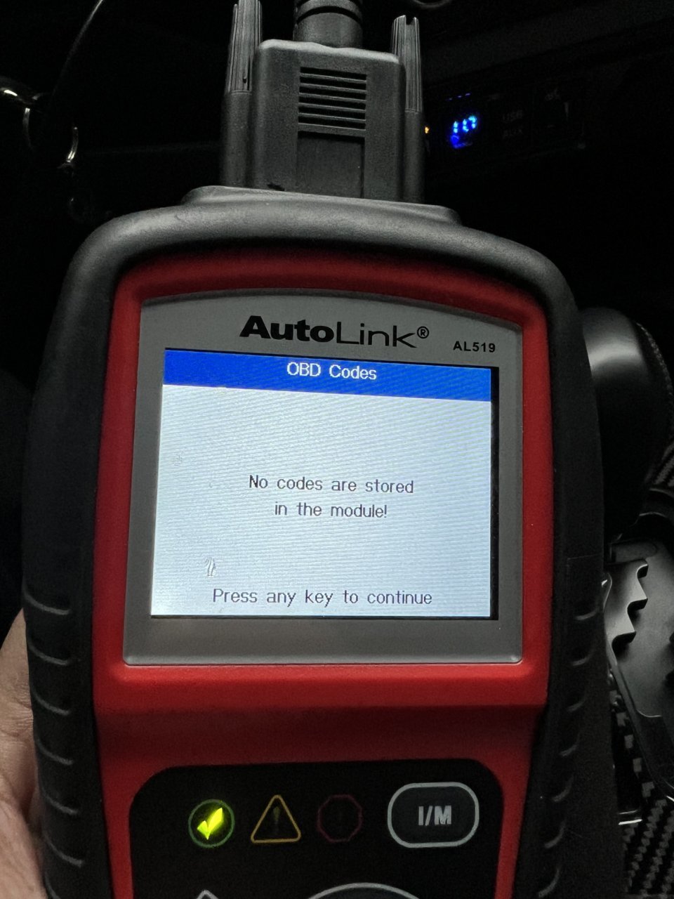

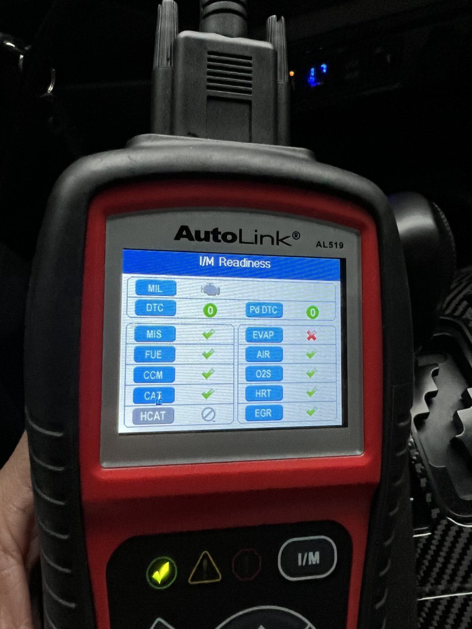

    Awesome kit guys! Very well built, quality product there! Pretty straight and check engine light was gone as soon as it was started up!
    I scanned the truck, still getting the P0418, P2440 and P2442 under permanent but no check engine light.

    @TegoTaco Thanks for the feedback and glad you got your truck back up and running. Depending on how you cleared the error codes it could take a few drives cycles for the Permanent error codes to clear. That said, since we are not seeing a Check Engine Light or Active error codes then that is a good sign. Please let us know if there is anything else we can assist with. I have also included a few links below and would really appreciate if you could share your experience.

    We are good to go 100%!!!
    Thanks you @hewitt-tech
    Quick question, I can remove the pump now right? Do I just remove the hose that’s connected to and leave it unplugged on the end connected to the valves?

    @TegoTaco Yes, you can remove the Air Pump(s) if you install the Gen 2 Bypass Kit. That said, you can also remove hose that runs to the Air Switching Valves. If you ever wanted to remove the Air Switching Valve you would to Purchase (2) Pressure Sensor Addons. That would be a full delete of the Secondary Air Injection System.
