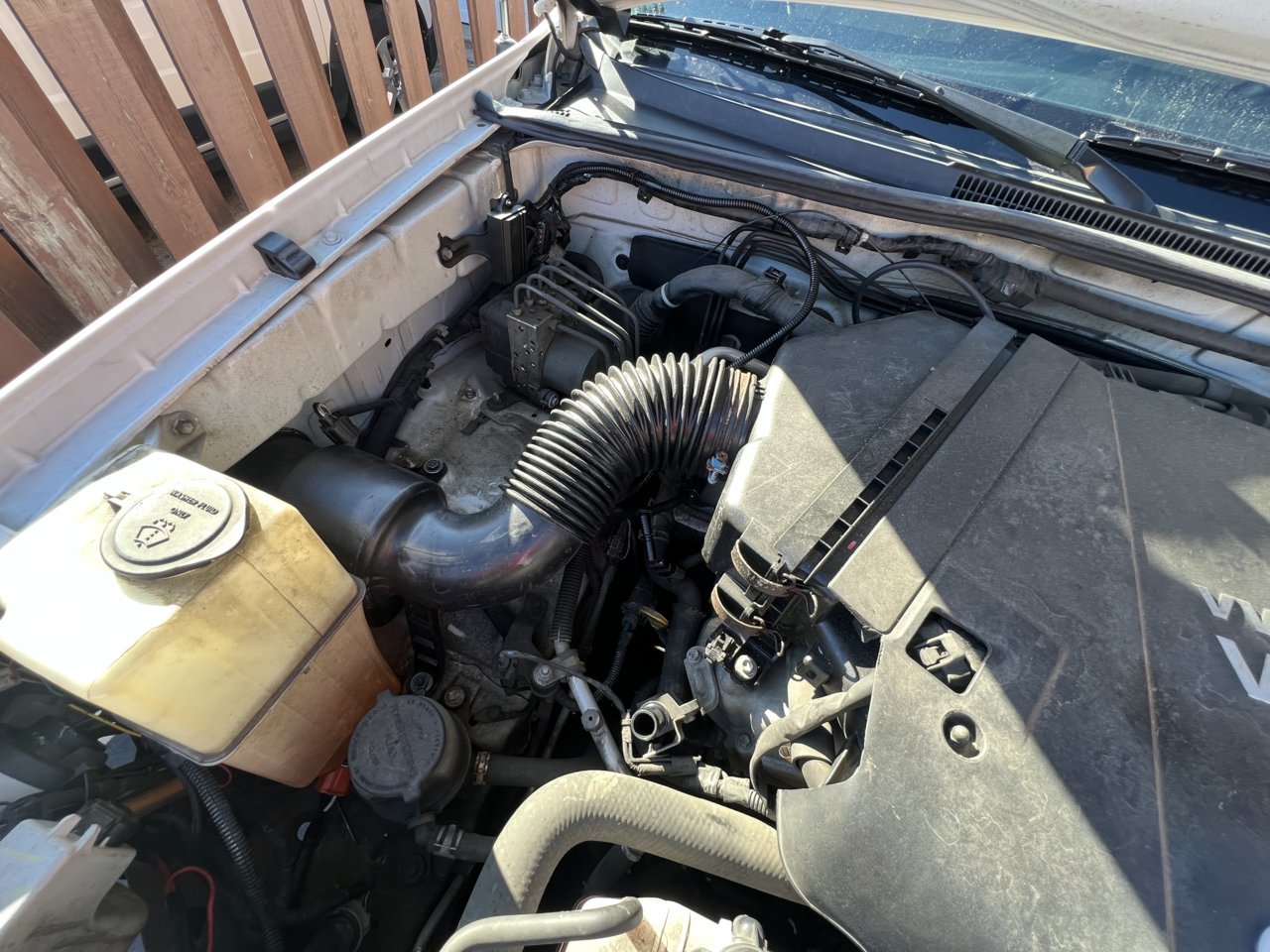

  8. Feb 12, 2023 at 4:36 PM
    #48
    TegoTaco
    TegoTaco Well-Known Member
    Sep 29, 2016
    #198555
    7,099
    Ontario, Canada
    ‘13 Super White S/C DCLB TRD SPORT
    Don’t mind the dirty engine lol!
    Officially out!
