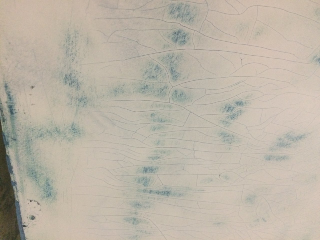

    Anyone have gelcoat repair experience? I've been sanding off the bottom paint on my new to me Venture 17 and found all sorts of crazing in the gelcoat. Someone had already patched a few small spots when it was painted last. Now I want to fix it correctly but also realize it's a low end boat. One thought is to build a jig to flip it over, epoxy the cracks, epoxy prime and paint. Other thought is to epoxy prime and paint over what's there (fill in the worst spots with peanut butter consistency epoxy first).

    I would sand the whole thing and do an entire coat of a 2 part epoxy marine barrier coat then paint it with topside or bottom paint. If the crazing is thick hit it with a dremel and put thickened epoxy filler in it.
    Edit: I have been a big fan of the Jamestown marine Totalboat products. Most even have video instructions.

    I have a full gallon of West Systems 105/205. Unless it's thickened, it'll drip all over. i was thinking, unfilled would potentially fill the cracks. If I go this route, it looks like I may be trying to flip this thing over.

    If you sand the crazing down and you can barely feel it you can get away with out adding filler for the barrier coat. But using west system alone won’t be very good for a barrier coat. You want something designed as an underwater primer like (interprotect) or other primer. You could try to add west system 422 to your current epoxy to make it less prone to water penetration. But I find it easier to buy a ready to go product.
    You can always do a light amount of silica filler if you don’t have deep gouges. Will still be runny but it adds strength epoxy without any filler tends to be brittle and will fall out chip away with time.

    Thanks. I was planning on using a primer (2 part epoxy) over the hull before the bottom paint regardless. Maybe I'll try a bit of thickened West epoxy in an area to see how well it fills without excessive sag. I appreciate it.

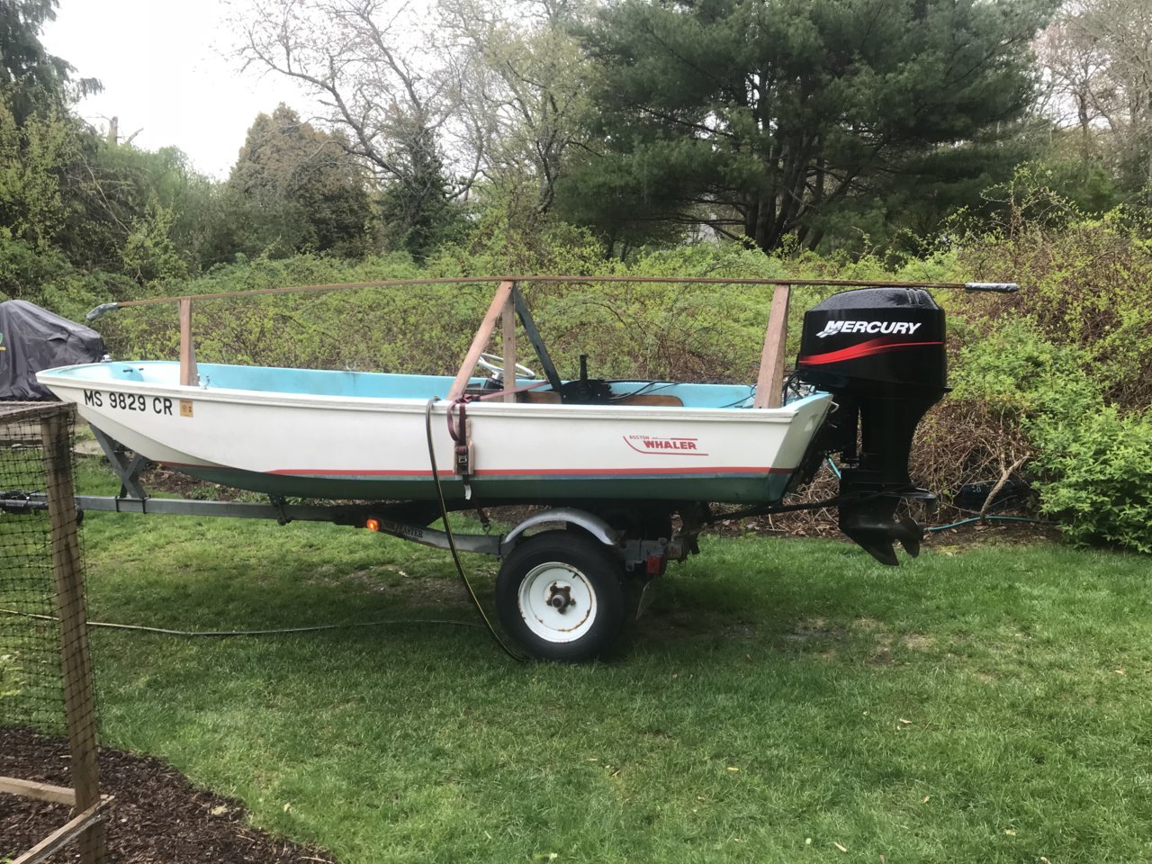

    So I got a new spinnaker but I haven’t gotten any photos taken of it yet. But my Whaler restoration project is going well.E300E66D-BE6F-4E41-BE65-6CD5421ADBDB.jpg
    When I got it looked good but needed work. Running way late though was supposed to be in by now. But needed barrier coat bad.
