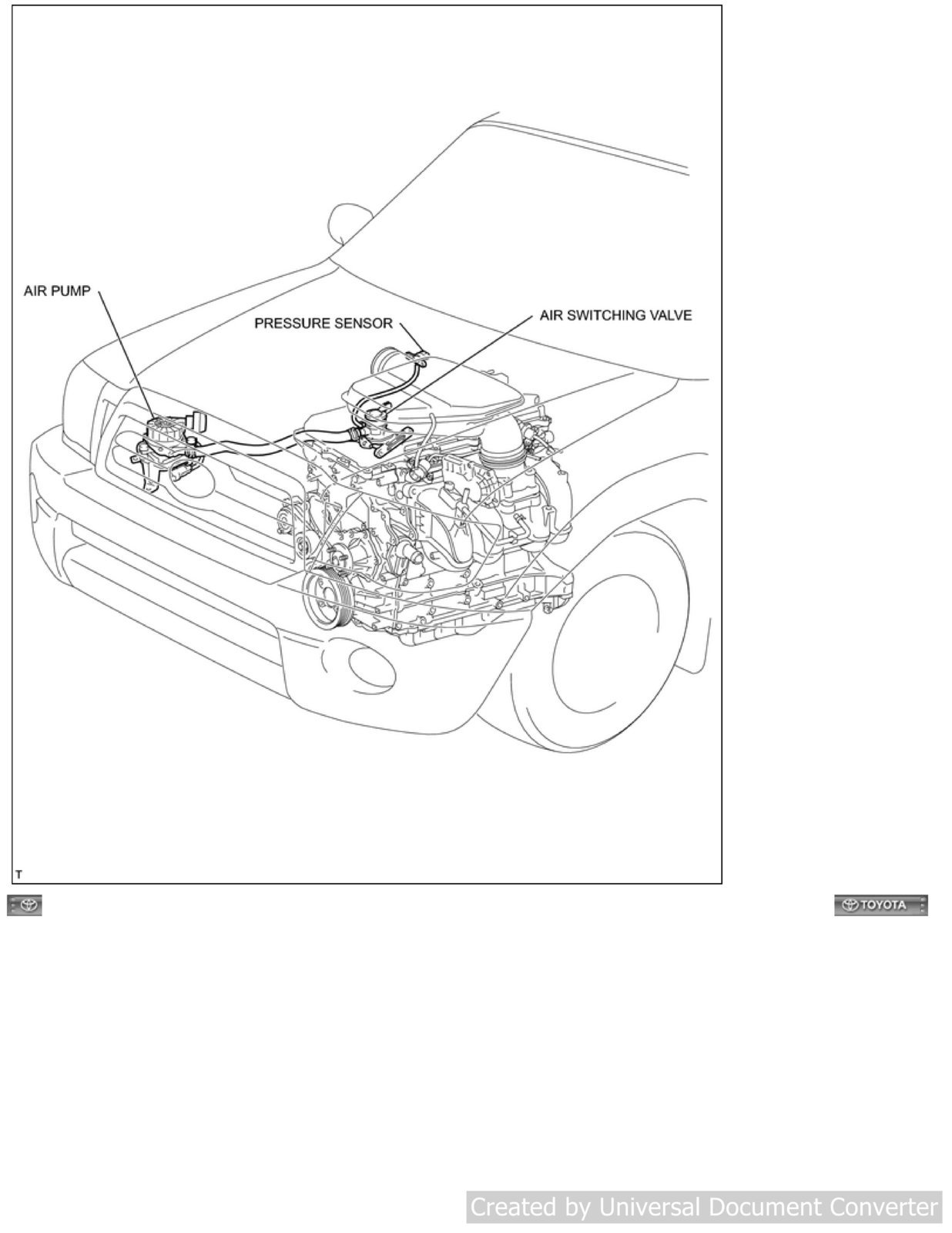

    It sounds like a vacuum cleaner running under the hood when it's on, it will only run during a cold start for 30-60 secs.
    The pump lives behind the passenger side headlight, you can also unplug it, jump power and ground to it, and see if it runs.

    I found the pump and opened up the hood to listen to it right after I cold started the truck. I've got a squeaky belt right next to that pump so it was a little tough to hear, but it definitely sounded like it was running. The pump sounded like it could have been a little weak but I don't have a reference for what it sounds like when it's running as expected.

    Pop the covers off and see if the foam filter is still in there, hopefully it didn't get sucked into the valve.

    Yeah you're right, definitely an issue with the pump - I'm going to replace it. Found a couple options for a replacement on Amazon, for anyone looking:
