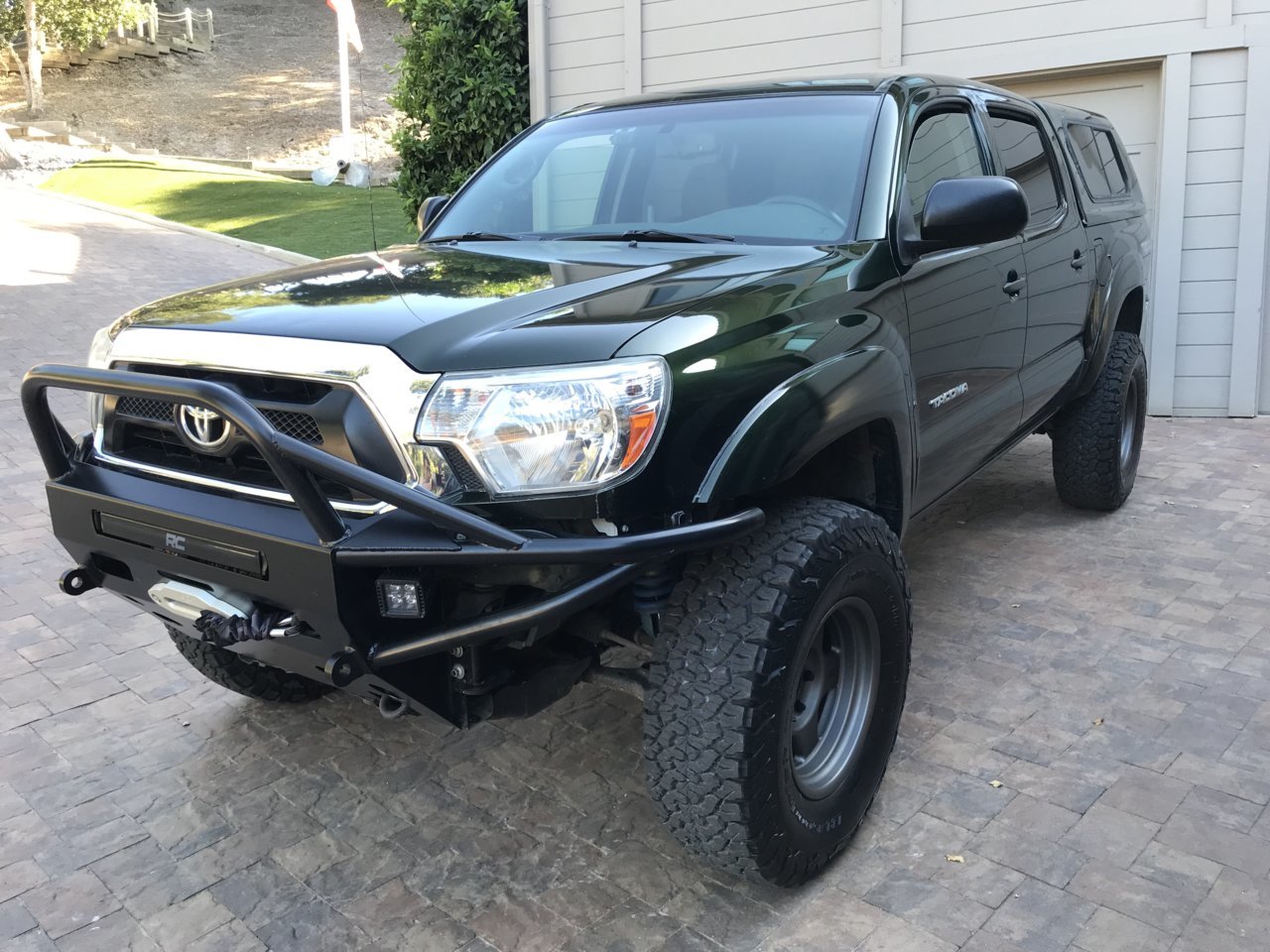

    Started a new project a few months back (oct18). I've been creeping on TW for a while so I figured I would show my truck off a bit. It's still a work of progress of course but I've dubbed it the _Rip_Bob_ build because it's turned into the bastard cousin inbetween of @Ripcord and @Jim Bob .(maybe less now that they have their campers rocking, I'll defiantly be doing one down the road as well)
    I got the truck in October, a buddy purchased it through through his work, it was a retired field truck for a seed company in Oregon. He brought it down to California and I scooped it up as fast as I could. 2013 125k miles TRD Off Road Spruce Mica Double Cab Short bed. I would prefer a stick shift or a long bed even more but I was happy to have it. I'm coming from a world of BMW's and Vanagons. My van has let me down too many time to trust on long weekend trips anymore so I was drawn to the reliability and 4 wheel aspects of the Tacoma's.
    It's a fairly short build so far but I'm very happy with what I've got done. I absolutely love this thing and it's nice to have this revamped excitement with a new vehicle.
    Wishlist:
    Racks for campershell + Rodvault
    High clearance rear bumper
    Skids / sliders
    Lower control arms
    Current look:

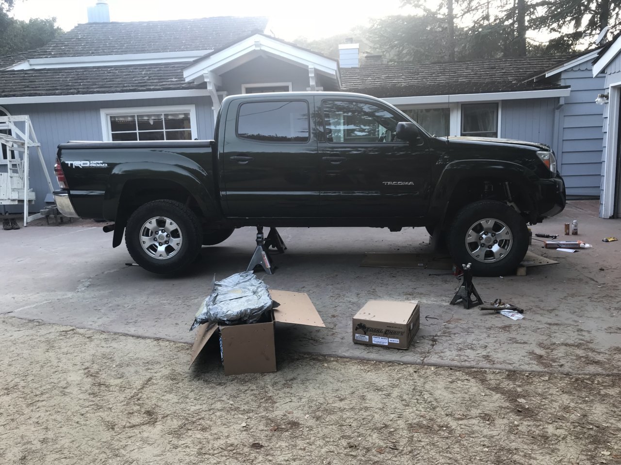

    First day:
    (disclaimer handicap parking was just outside my work for 5 minutes to show off)

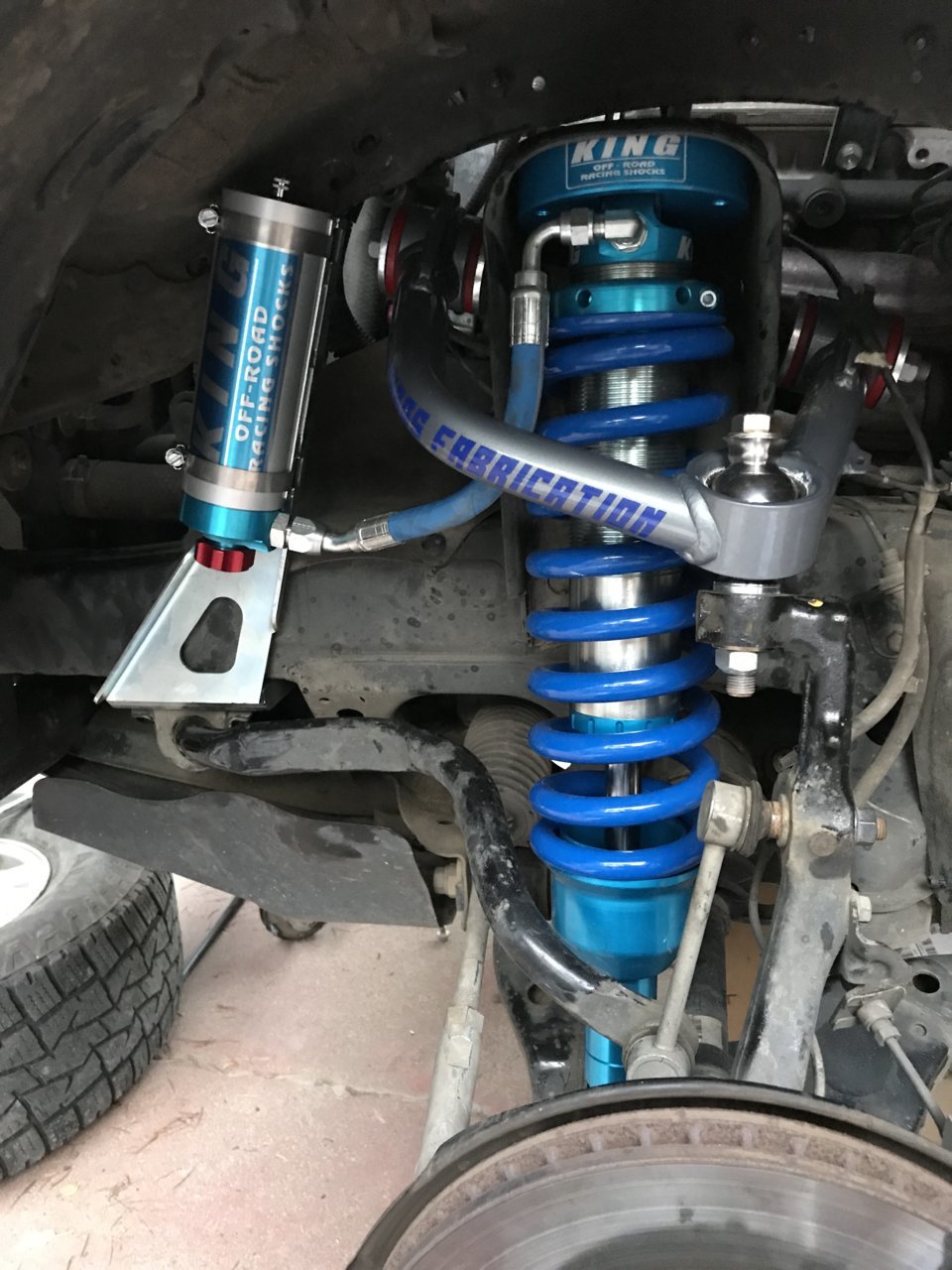

    First things first, king 2.5 shocks and @TOTAL CHAOS from @ToytecLifts :

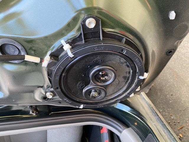

    Finally got around to installing the old speakers:
    had to do some hacking for the rear speakers since i didnt buy the mounts:

    Picked up some new Wheels and Tires this week (august19)

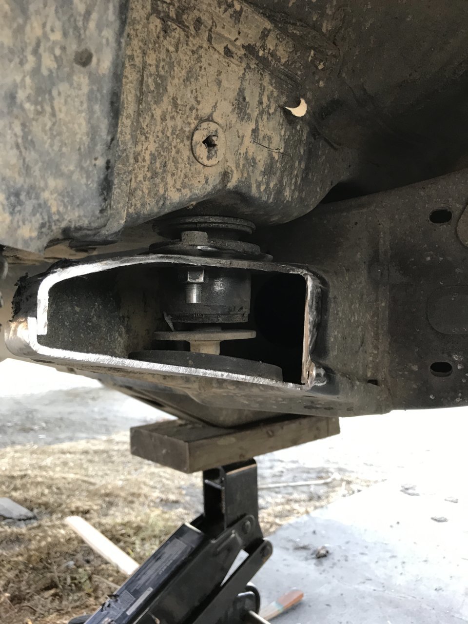

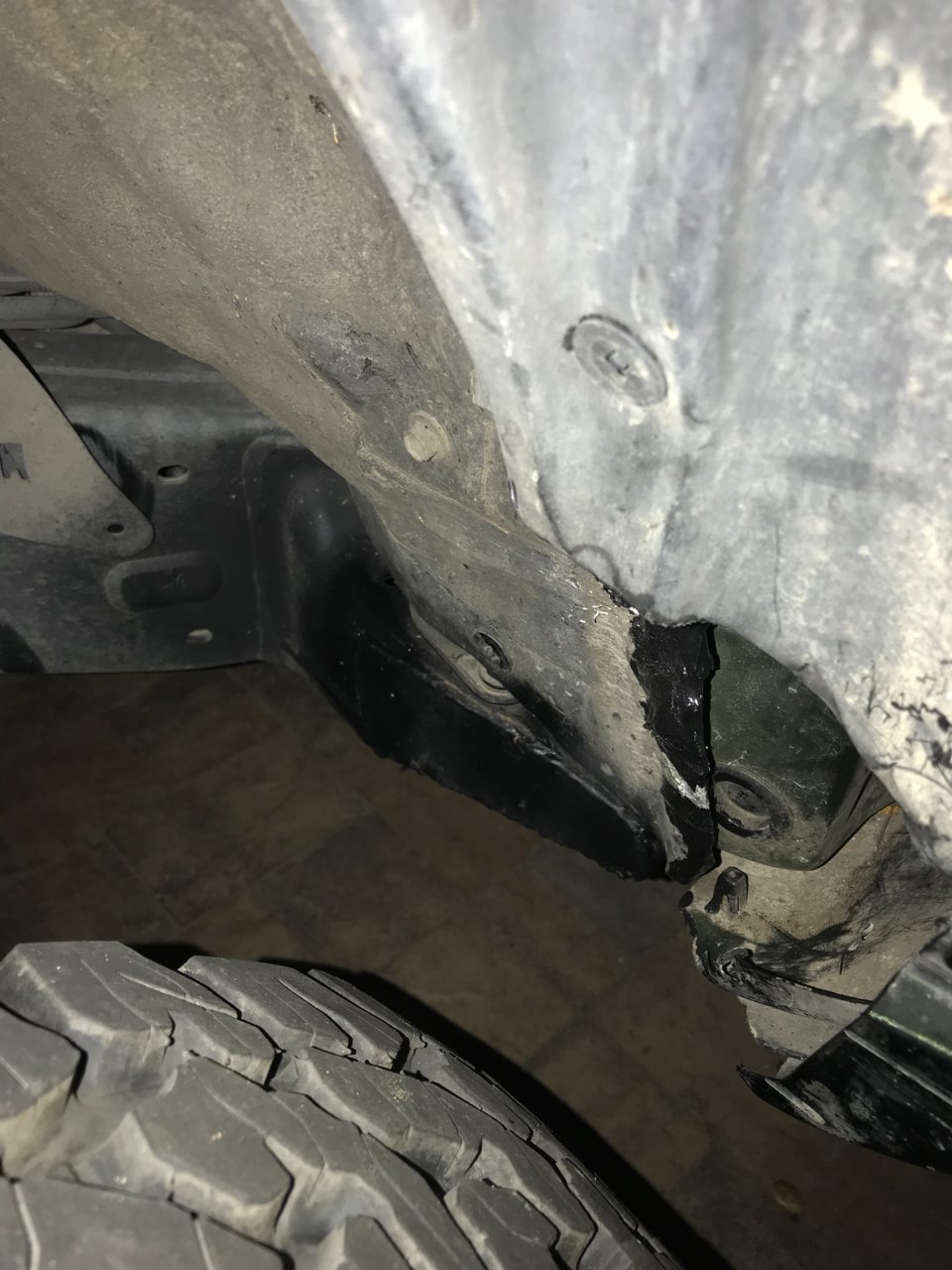

    Cab mount chopped
    SCS f5 3.5 bs -25 offset
    KO2's 285 75 16
    4A1B2C79-6FC6-4930-A85E-7F64293F8AA9.jpg 01D04C0F-D5E5-42ED-9502-231C5CD7E0C8.jpg 7C964361-56C9-49F8-A6AA-BA8A3FA39913.jpg 864E10E9-C88A-43C1-A7DC-2C62E50083FB.jpg
    Love em!

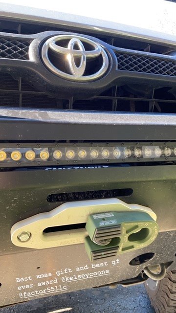

    Factor 55 winch shackle for xmas!

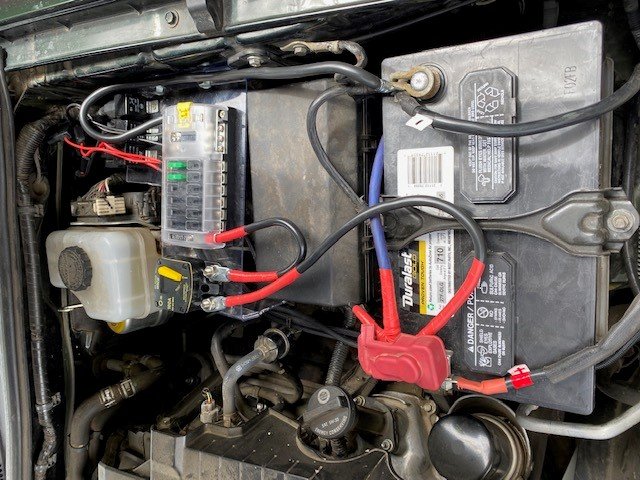

    Did a little work the past weekend.

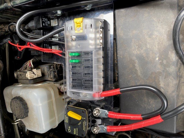

    Blue sea fuse box and bussman circuit breaker to help clean up some wiring under the hood.

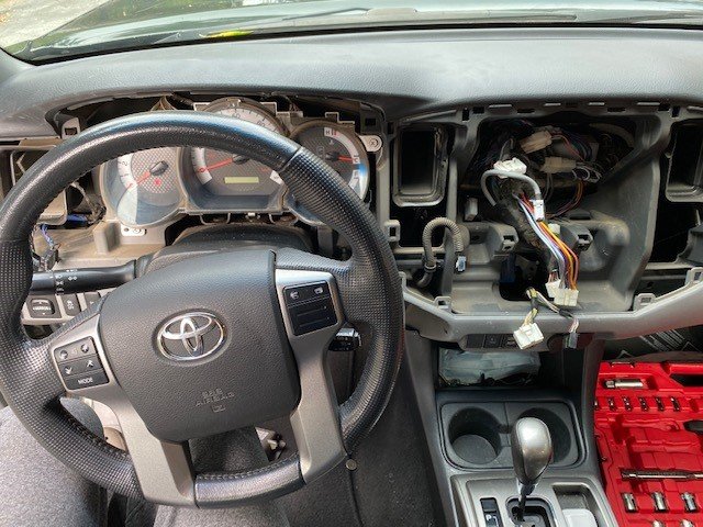

    Needed to fill some spots on the blue sea so i got some more accessories for the interior:

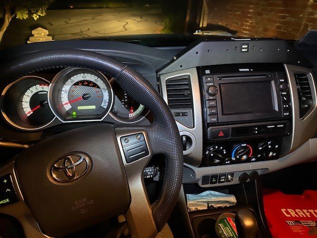

    Expedition essentials 2TPAM with iphone holder

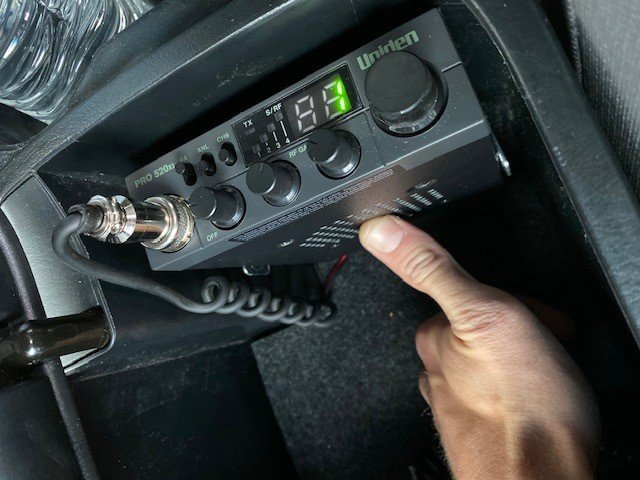

    Uniden CB radio hidden in the center console with external speaker in grill

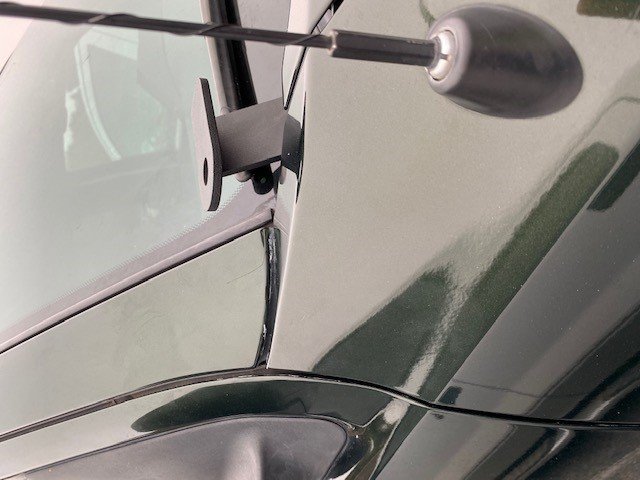

    CBI antenna mount ( a little too low profile for the coaxial i bought, waiting on firering)

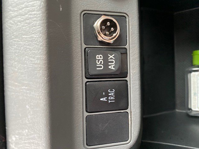

    CB mic input rewired to empty dash switch

    Rib Bob is sweet! Quick question for you. I am running 33" skinny's on a 2" lift, and am thinking of getting the standard 285-75-16's.
    How much chopping did you have to do? Did you have to run spacers with the 16" rims?

    I really didn’t have to do that much chopping of the cab mount but I went ahead and did it anyway. Plenty of clearance now. I bent back the pinch weld to be even with the rest of the wheel well and the cab mount. I posted some pictures in the thread. I’m getting a little bit of rub on the fenders, it will be easy to trim a small amount off to stop it. But, I think I’m going to hack the flares a bit, maybe an in or 2. It will allow it really clear everything when I’m banching.
    As for your tires, you’ll need a 1.25 inch spacer to fit and make your wheels have the same offset as mine. I don’t have spacers my offset is just crazy. It defiantly spreads it out but I love it. If I were you I would wait and get new wheels when you get new tires just cause; some Micky Thompson’s or procomps are pretty reasonable!

    When getting 285's, Is it automatic to have to do the cab mount chop? Or is it possible depending on the wheel / off-set, I can avoid it?

    If you aren’t going to wheel at all. And you leave your sway bars on and have a less aggressive offset you don’t NEED to do the cmc. To me, it’s automatic. Why not? Fun little project.

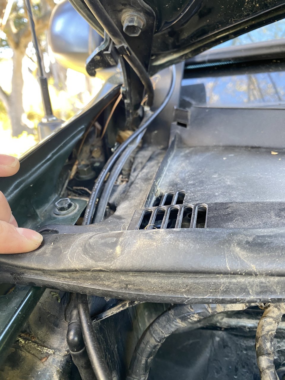

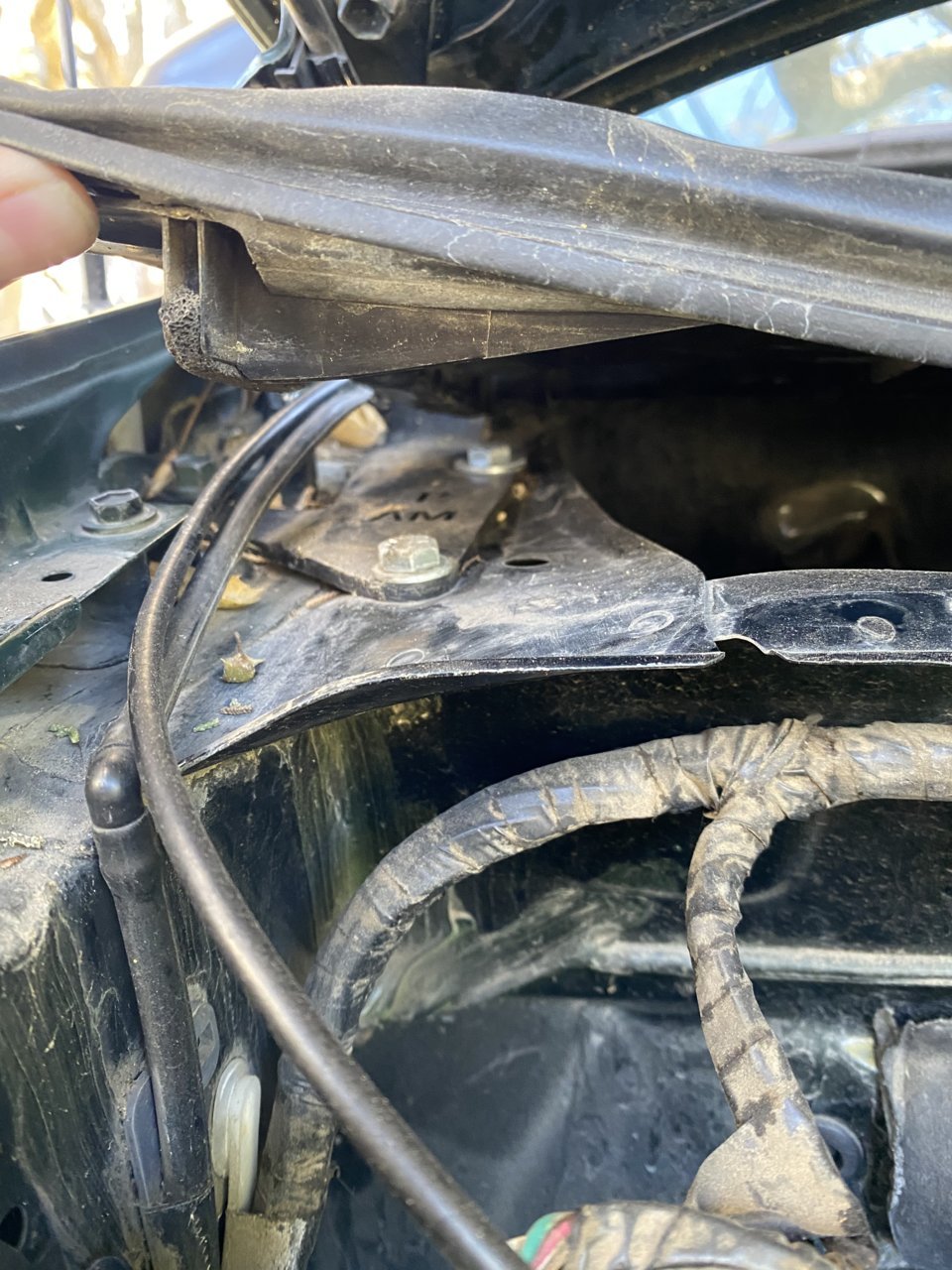

    I just got one of thes and can’t figure out how it mounts. Nothing seems to line up. Any tips?
    Toph
  19. Feb 7, 2021 at 10:04 AM
    #19
    SalinasTaco
    SalinasTaco [OP] Active Member
    Oct 9, 2018
    #268879
    27
    2013 Spruce Mica TRD-OR
    DETAILS
    CE47BB26-006E-4562-9B52-3266F19252A7.jpg A81CE84E-45F2-4D87-A2E0-C3D9B2787913.jpg
    it goes under the plastic rain guard you have to take all that off and cut it to make it work, you’ll see the bolts it mounts to once you get it off. I’ll go out and take a picture for you if you’re still having trouble.
    ***correction.**** I don’t think you have to cut anything. Here are the pictures.

    Salins, thank you. That makes sense. The pics help a lot.
