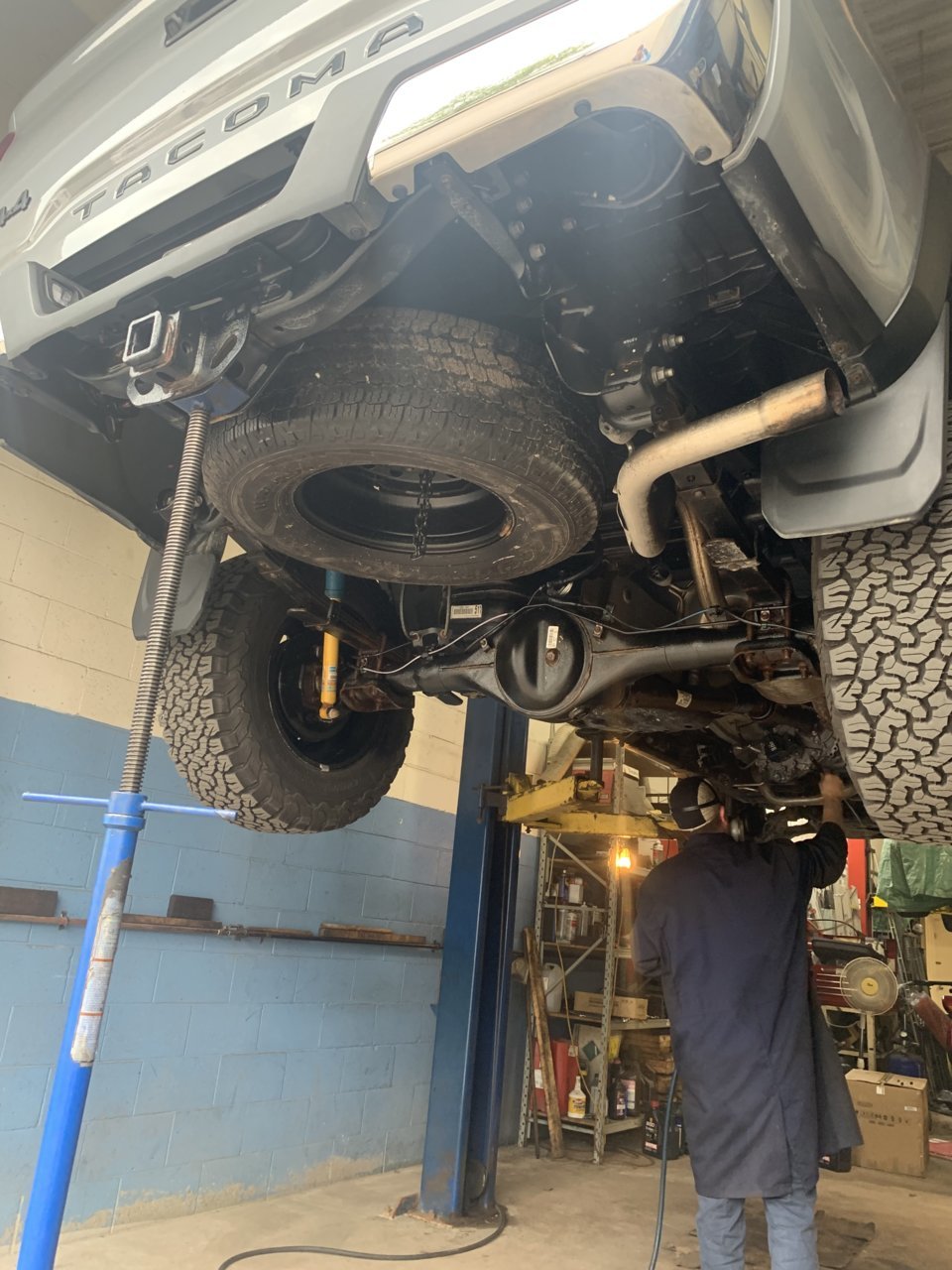

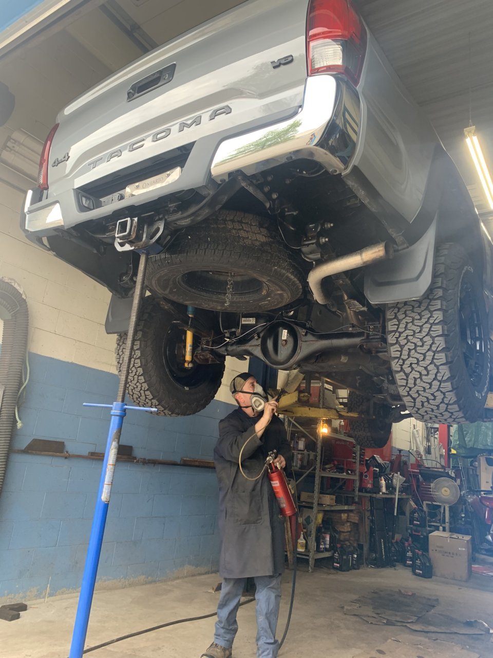

    Cost of getting the rig rust proofed….PRICELESS in the 905!
    Sadly winter, the salt, sand and brine are coming don’t put it off lads :)

    What the hell kind of lift support is that in the back? Looks sketchy as hell

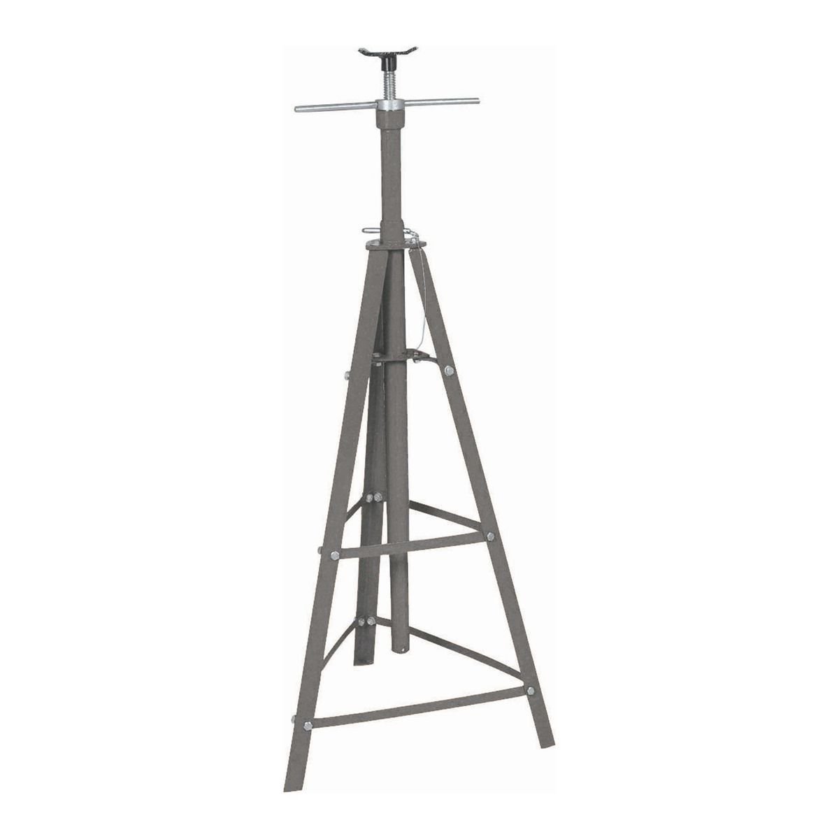

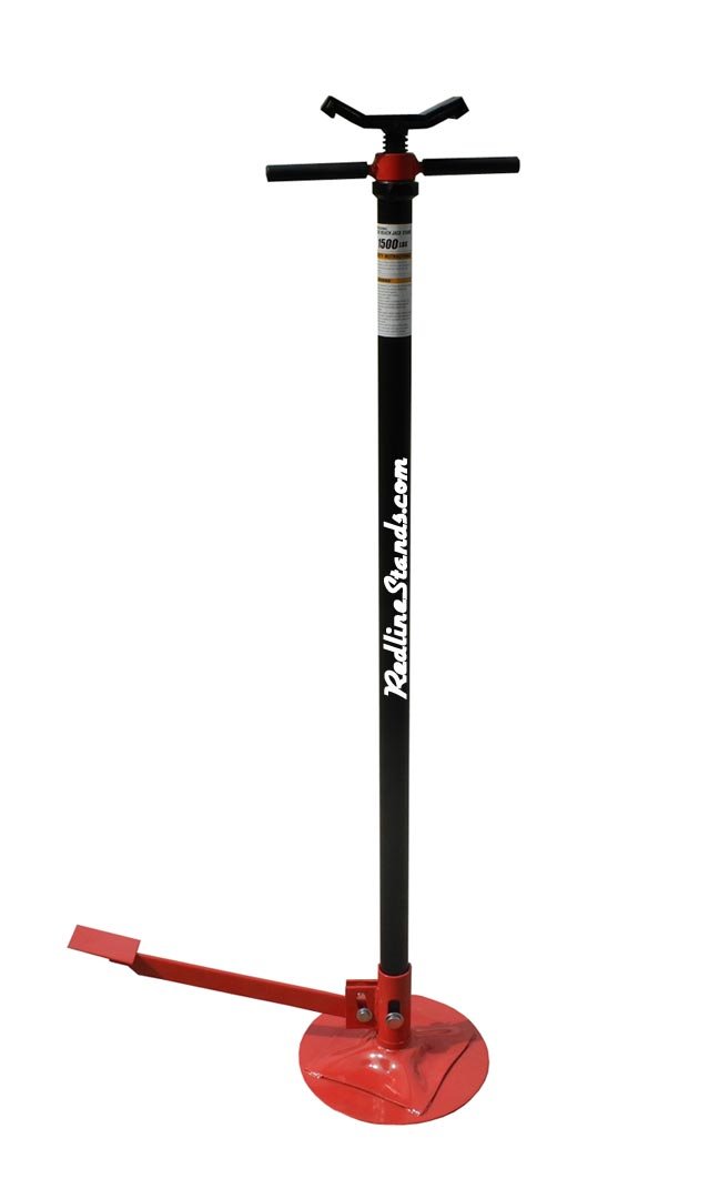

    Pretty common to use an under hoist support, it isn't (shouldn't be) holding anything up but does make the vehicle, especially a longer one more secure. Only takes a minute to set up.
    Different styles are available.

    Maybe the picture is deceiving, and I see the lift in the front, but not the rear. It just looks like this hoist is almost maxed out and the only thing holding up the rear. I'm sure the guy know what he's doing and I'm not seeing the whole picture, but I'd be leery about getting under there as shown

    Zoom in on the yellow lift arms visible above the operators left shoulder, there are two, one to the front of the frame and one to the rear.
    The safety stand is probably close to the top of the range, that style goes lower so it can also be used as an extra hand to hold an exhaust system, gas tank or rear axle with the spring removed.
    That style is probably rated around 1500 pounds, remember it is intended for holding, not lifting, just like having someone hold the base of a ladder for extra stability.
    I would have confidence standing right next to the gentleman -- except for the chance of getting sprayed. ;)

    I had some gear in the bed too so it was a little back heavy but just in for an oil spray so he wasn’t going to rocking the truck around doing the suspension or anything but exactly what he said… “ya never know”

    Oh I see it now it’s two points of contact - I didn’t catch that the first time around. Disregard

    I got under it a snooped around so totally confident he’s cautious but he knows his s*#t he’s a bus and heavy truck mechanic too he’s no rookie by any stretch
