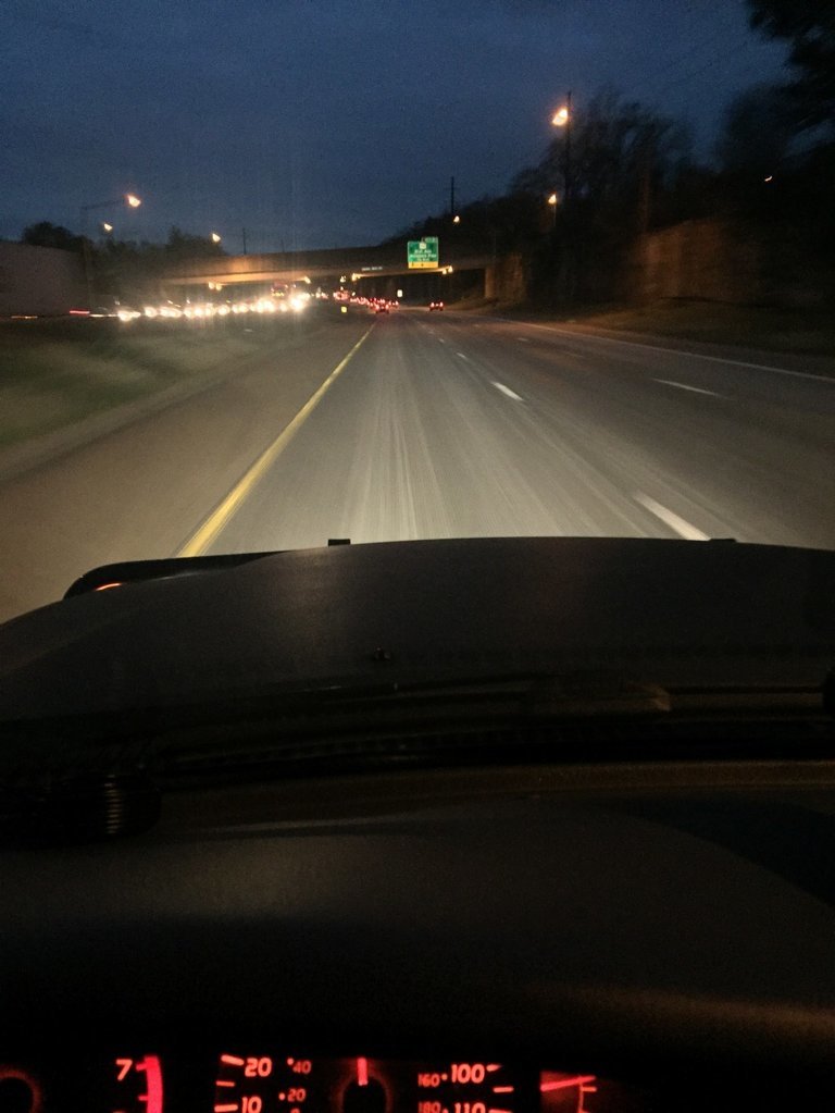

    Well there isn't even any precipitation yet and it looks like they've already coated the roads :(
