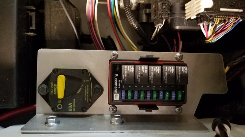

    Finally, another step forward. After two unsuccessful tries I finally got a Bussman unit and Circuit Breaker. A big thanks to @paranoid56 for his assistance and making a panel that fit around that big-assed master cylinder. Now all I need is something to hook it up to.

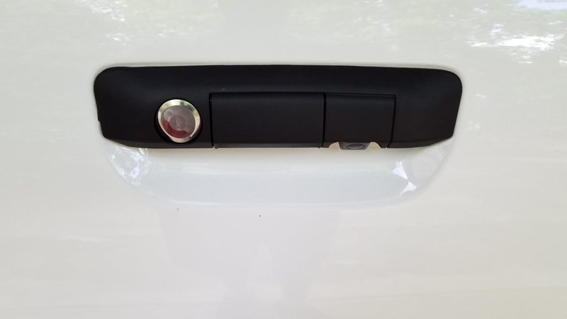

    It's amazing how much work you can get done when your wife is out of town.

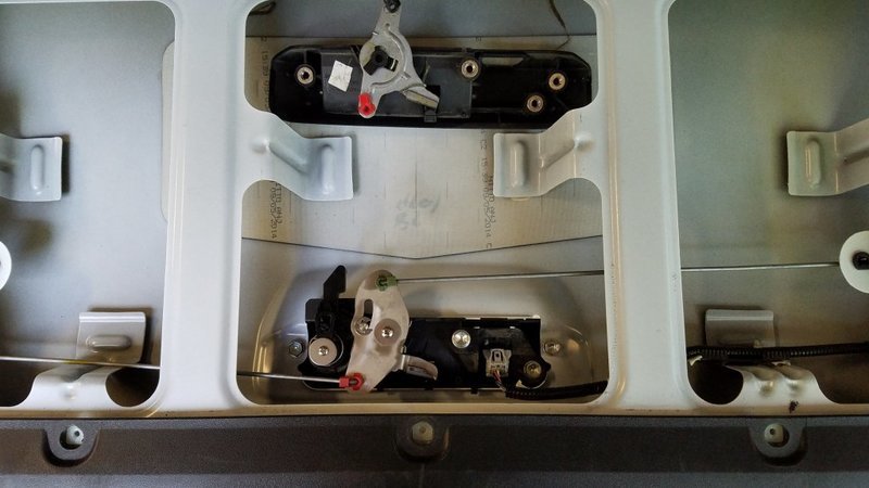

    Installed a Pop-N-Lock lockable tailgate handle. Went in very easy; directions were very clear and concise. Only took about 1/2 hour.
    Now I can lock my tailgate so I won't get my shit stolen.

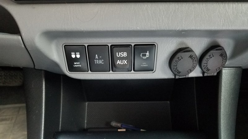

    First up, A few weeks ago I did a mod where I hardwired a GPS power supply behind the dash and ran the power cable out through the defroster vent. It was wired up such that the power supply was always on even if I wasn't using the GPS. I decided that was not a good idea so I ordered a switch from CH4X4 and installed it in a spare spot in the switch bank at the head of the center console.

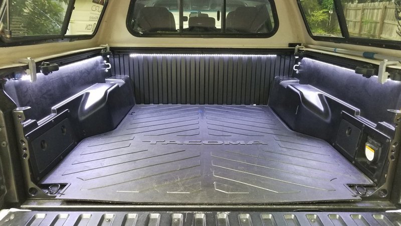

    Then on to the bed. I had bought a set of LED strips from @mattgecko with the intent of powering them off the same power wire that powered the light in the shell. Then I discovered that whoever installed the shell tapped power off a tail light wire. In other words, the shell light would only work if the headlight (and tail lights) were turned on.
    WTF?
    So the first thing I had to do was find a new power source that was always hot. But there weren't any. So I ended up running a wire from the battery to the rear of the truck. This meant crawling under the truck (more than once) and I don't bend like I used to. But I finally got it done and hooked up the wires. Amazingly, it worked the first time I turned it on.
    The power switch for the LEDs is mounted in the same recess as the AC outlet.

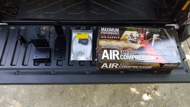

    Today's project.

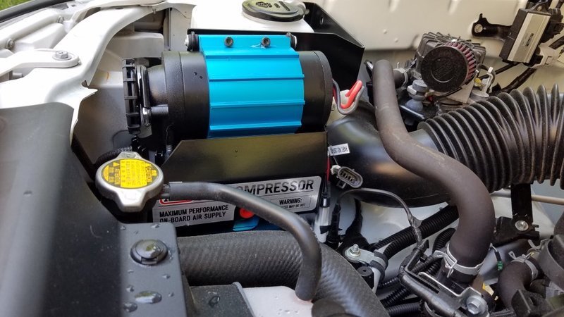

    Got it installed. The physical installation, anyway. The next challenge will be to figure out how to connect the wiring to that Bussman relay/fuse panel I bought. If anyone has done that, your advice is most welcome.
