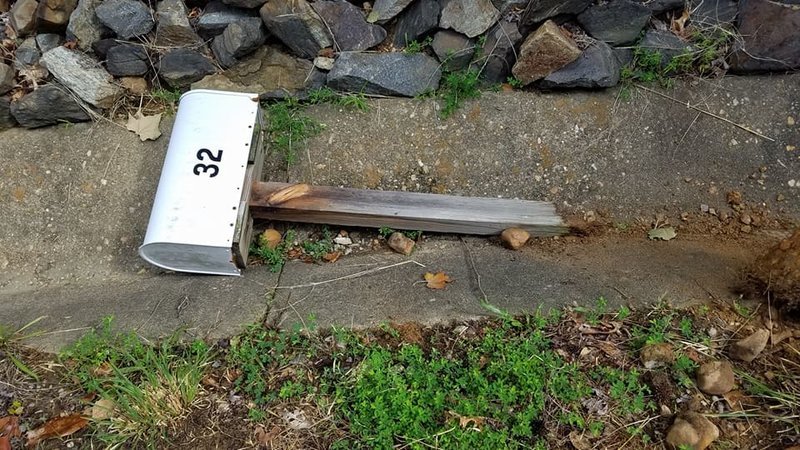

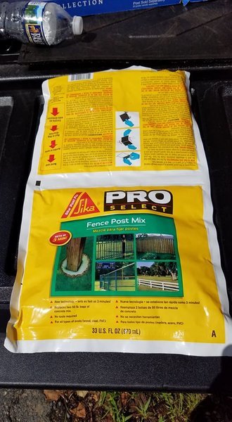

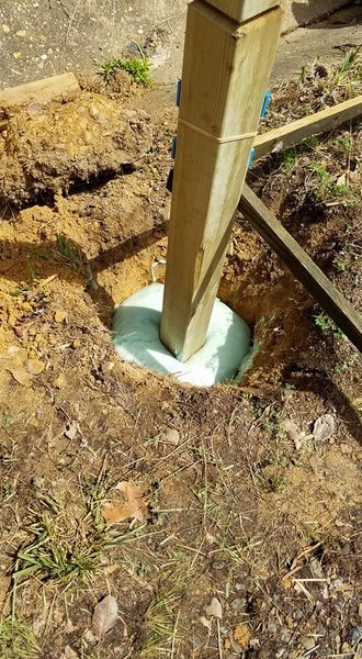

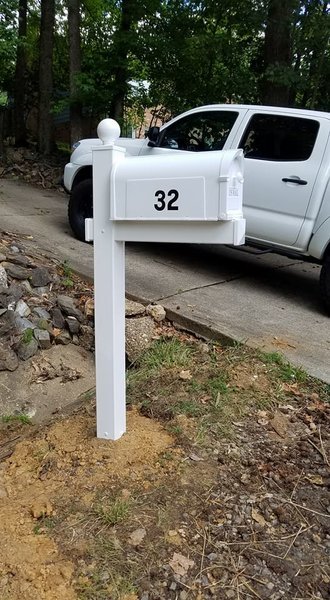

    Was gonna work some more on the air horn project but my mailbox had other plans. After 30-some years the post finally rotted off underground so I had to put up a new one.
    After digging out the remains of the old post I decided to try this new stuff I had heard about instead of mixing up concrete.
    This "Post Mix" comes in a two-part bag. You break the inner seal by squeezing it, allow the two chemicals to mix, and then pour it into the hole. It starts to expand into this styrofoam-like material that secures the post in place. No muss No fuss.
    Then you just backfill some of the dirt on top of it.

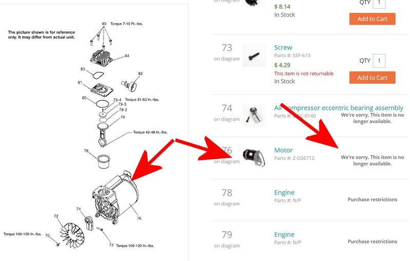

    My Craftsman shop compressor decides to go tits up. Smoke started pouring out of the motor housing. So I look it up online. I find the motor on SearsPartsOnline: "We're sorry. This item is no longer available."
    :annoyed:
    Fuck.

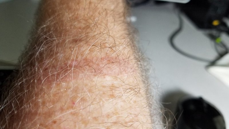

    And while tearing the plastic hood off the old compressor motor, my right arm made contact with the hot metal air tube that goes from the air cylinder to the tank. Got me a nice little burn scar.

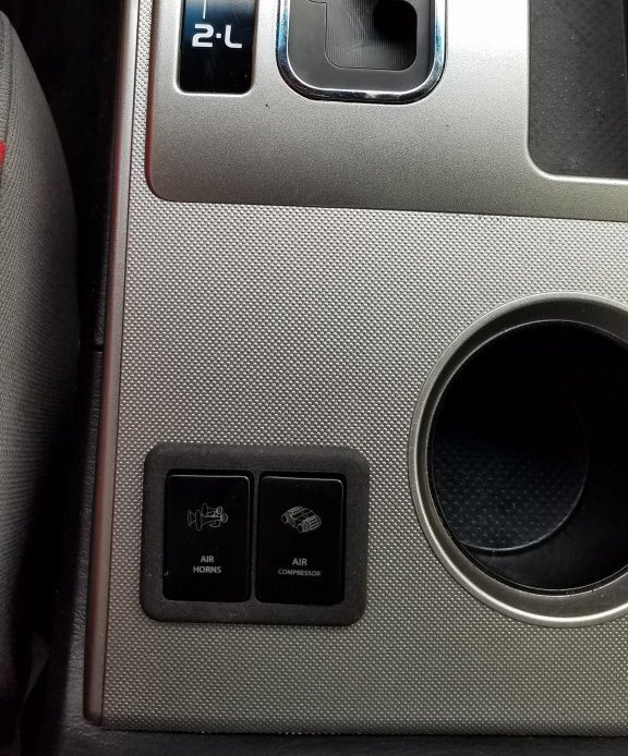

    The next step in the continuing saga of the Air Horn/Compressor project has been completed. I got the switches installed in the center console.
    Ever see that movie "The Right Stuff"? Remember when Scott Glenn as Alan Shepard was sitting in the first Mercury space capsule? Remember when the reporter says "And what could be going through the mind of America's first astronaut as he is about to blast into space?" and the scene cuts to Shepard and he says to himself "Dear Lord, please don't let me fuck up."
    That's about how I felt when I began to cut the hole in the console. But between a Dremel Tool, a small cordless jigsaw, and a very sharp knife I got it cut and it's even straight.
    A big shout-out to @docloco for his patience with me constantly changing my mind about what I wanted to do.
    docloco and ChadsPride like this.

    Glad you're happy with it.

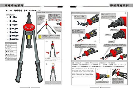

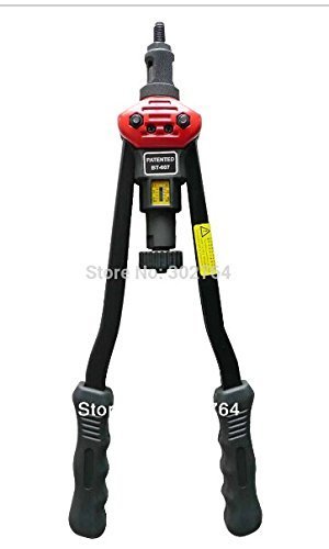

    The Rivnut Tool arrived today courtesy of Amazon Prime.
    Here's what it looks like:
    https://www.amazon.com/gp/product/B00R1FYLWU/ref=oh_aui_detailpage_o02_s00?ie=UTF8&psc=1
    Once I figured out how to change the bit, I was able to install 6 Rivnuts under the driver's side area of the cab. It's amazing how well things work when you have the right tools. Now all I need to do is fashion a bracket or two to connect the feet of the air tank to the rivnuts.
    No pictures yet, it's raining outside so I was working in the garage and there was not enough light to take any good ones. Stay tuned.
    EDIT: I ended up abandoning the idea of mounting the tank here. Turns out it would end up hanging too low.

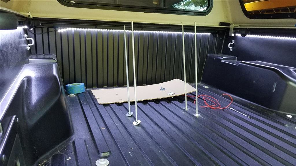

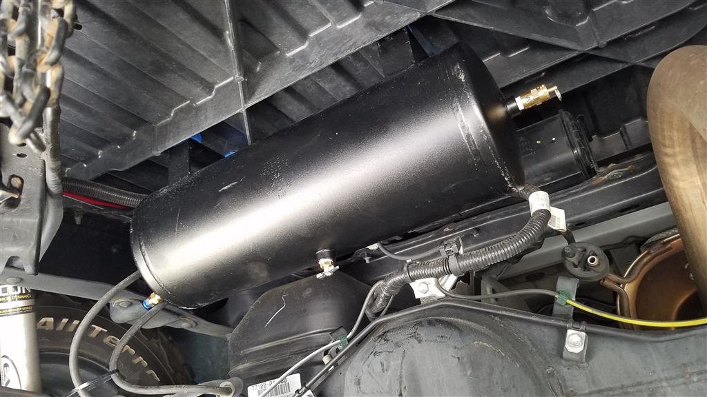

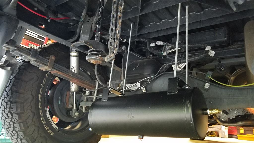

    Finally! After two unsuccessful attempts to install an air tank I finally got it done today. It is bolted to the bottom of the bed ahead of the spare tire.
    Installing this presented a bit of a challenge. The tank is mounted inverted and actually hangs from the bed by its legs. The problem was, aligning holes to drill, and then holding the tank up from the bottom and inserting the bolts from the top. Since I obviously cannot be two places at once, I came up with a rather ingenious (if I may say so myself) way of hoisting the tank to the bottom of the bed and doing it all from inside the bed.
    First thing I did was make a cardboard template of the position and measurements of the mounting holes in the tank's legs and after careful measurement both above and below, drilling the holes.
    The next thing I did was to bore out the mounting holes in the tank's legs to 7/16th inch diameter and then I installed a Rivnut designed for a 5/16th inch bolt.
    Then, using 4 3-foot threaded rods (same bolt size as the Rivnuts), I screwed the rods into the tank legs below and then turned nuts on the rods on the top side. Cranking about 2-inches at a time I was able to raise the tank to the bottom of the bed. When the tank was tight against the underside I unscrewed the rods one by one and replaced each with a 5/16th inch bolt down into the Rivnut.
    Top side:
    Underside:
    The final product:
    This was a good stopping point for today so I called it quits for now.
    Running the air lines will be the next task. Trying to route them into the engine bay (where the compressor is) without getting them too close to the exhaust pipes will be the tricky part.
