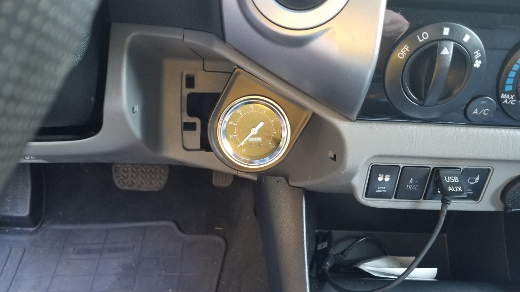

    Was up this morning at the butt-crack of dawn to get a few things done on the Tacomeister. They say "Make hay while the sun shines" but lately I try to make hay while the sun is NOT shining. It's been so bloody hot outside you can't hardly breathe, let alone work.

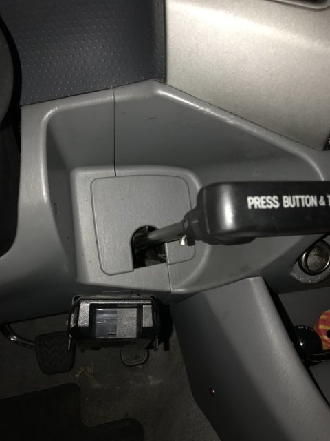

    First up was to re-install the spare tire after the air tank installation. WOO HOO! It fits. The forward end of the tire just barely touches the tank but the two are not in conflict with each other. That's one worry out of the way.
    Second was to install the air pressure gauge in the cab. I yanked out the coin tray at the lower right of the steering column and mounted it there. Perfect location.
    I also ordered Toyota part number 55548-04010-B0 which is the plastic cover that mounts into the same holes as the coin tray. This is the cover used on Tacomas with the manual hand brake.
    This is perfect. It trims out the area nicely yet leaves an opening for the air hose and the wires for the gauge light to pass through.

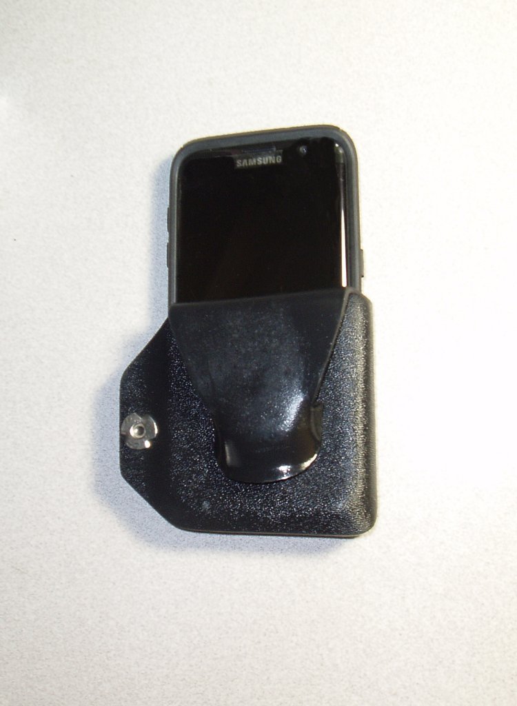

    My latest toy.
    A belt holster for my cell phone made out of Kydex.

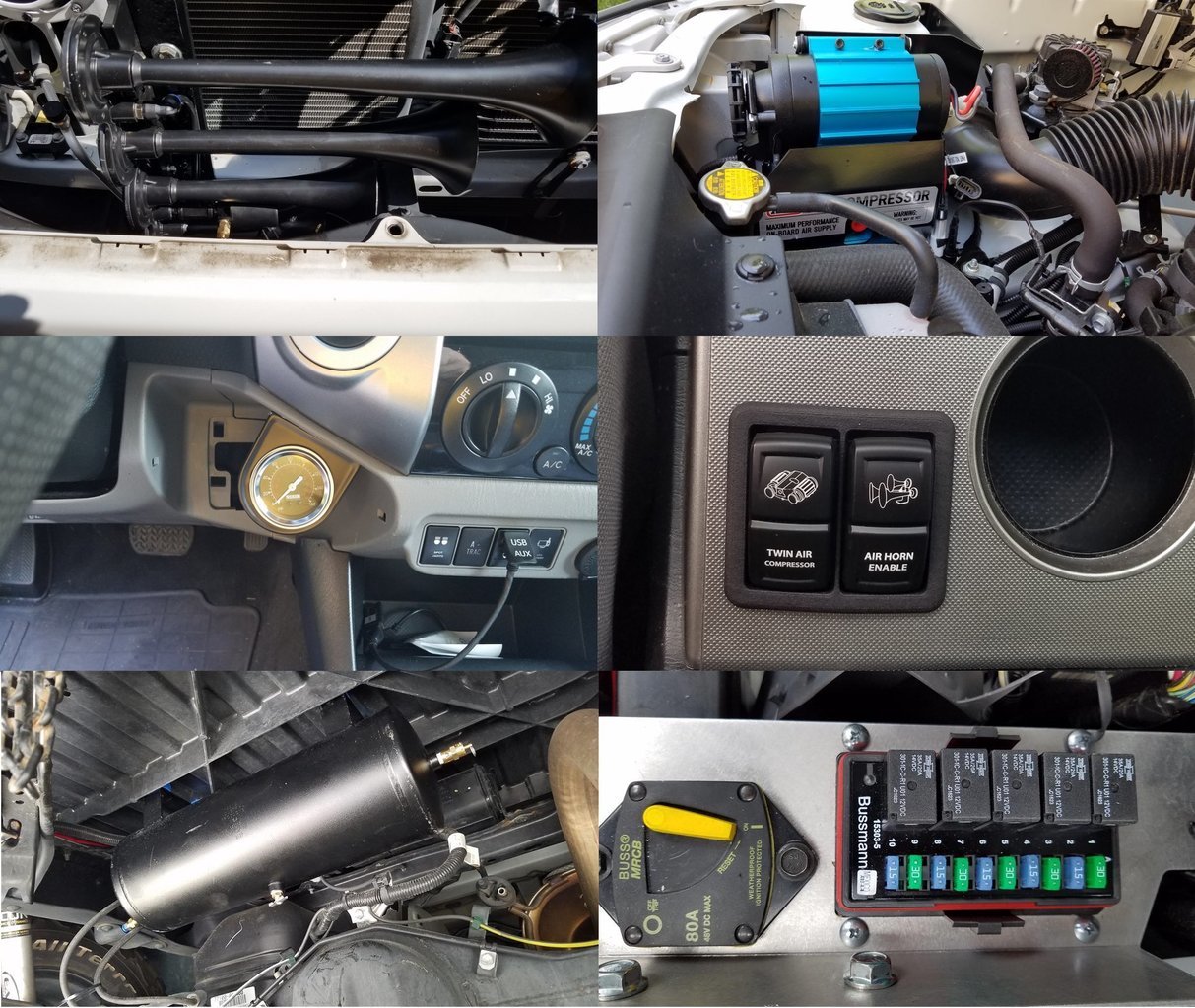

    The Air Horns project is 99.999% complete! Pictures and details (and maybe a video with sound) coming soon. Only things left to do is connect some wires to light up the switches and the pressure gauge, and I seem to have a small air leak I need to track down and secure. Otherwise the horns are functional.
    Stay tuned.

    I figured out the air leak. It's actually coming from the compressor. I thought these ARBs had a built-in check valve but I guess not. New leader hose with a check valve is on the way. Should have it tomorrow.

    Air horns are done!

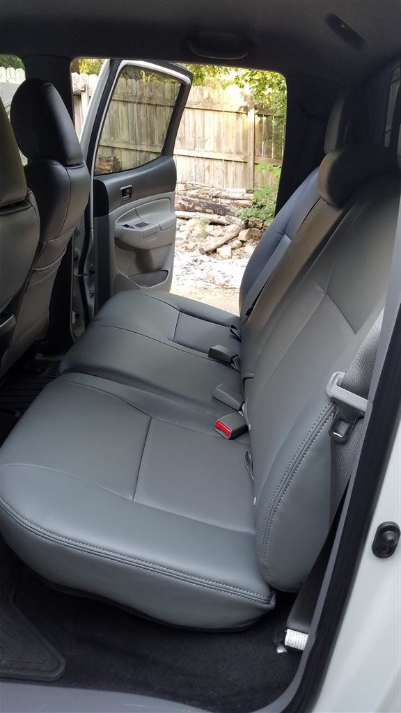

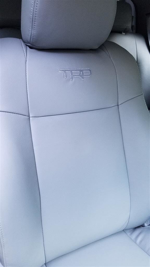

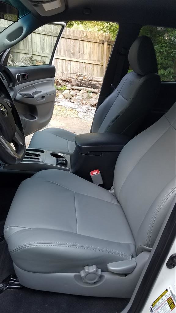

    New Katzkins!
    20170824_181110.jpg 20170824_181027.jpg 20170824_180945.jpg 20170824_180924.jpg

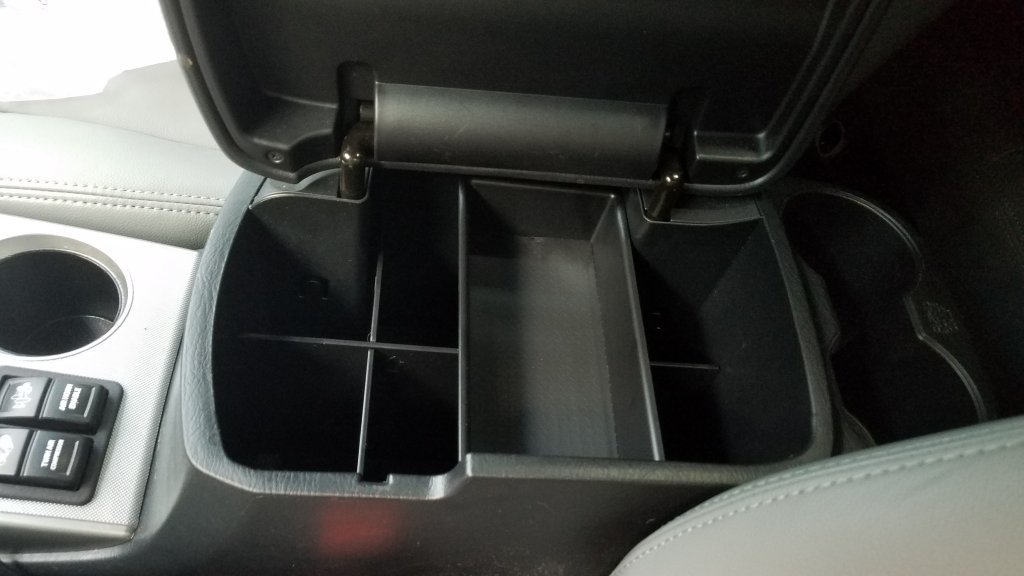

    Got the Center Console organizer and tray from @salex installed.

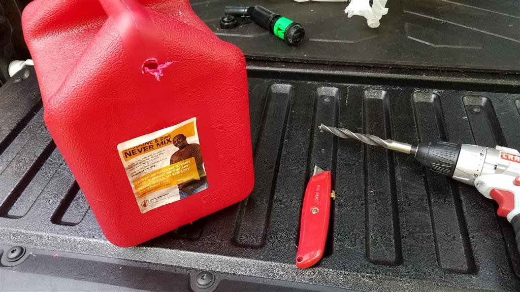

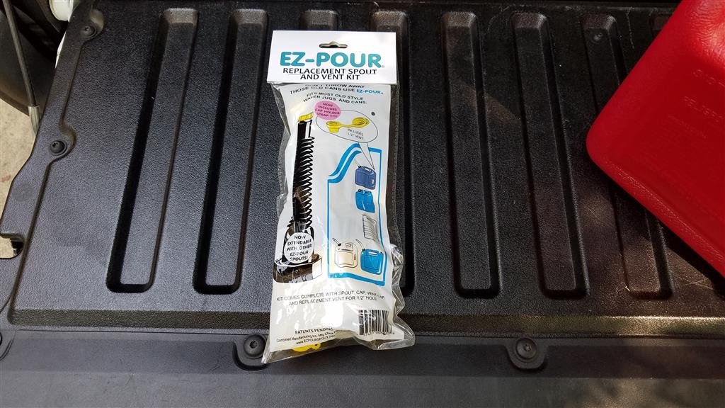

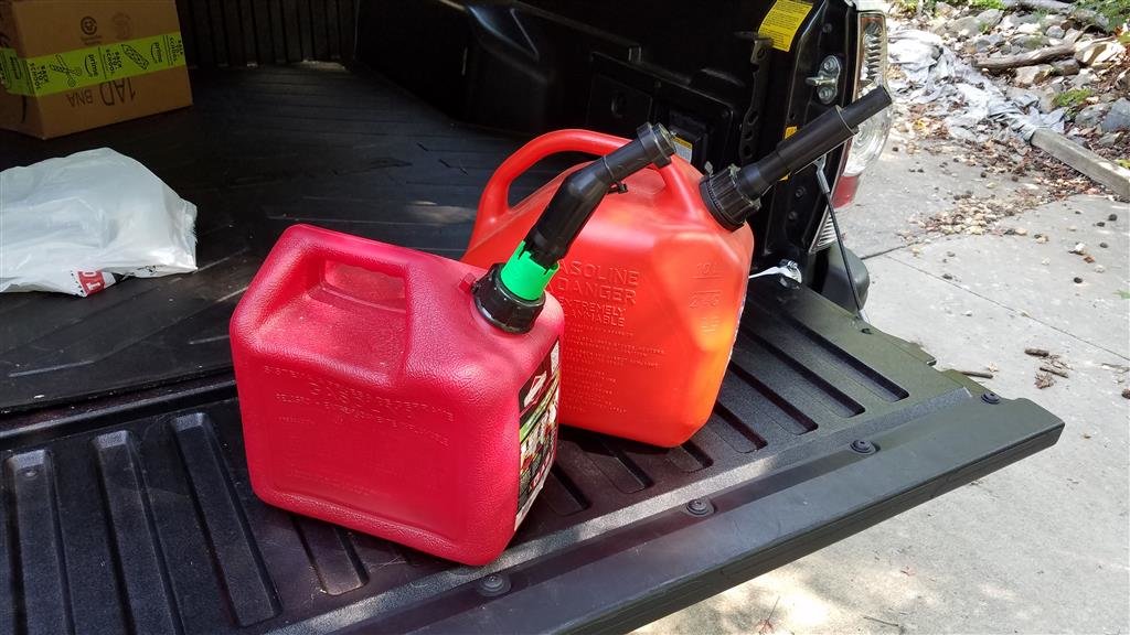

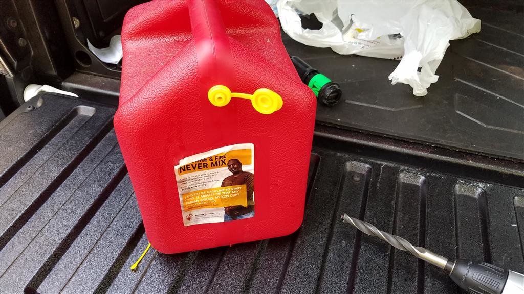

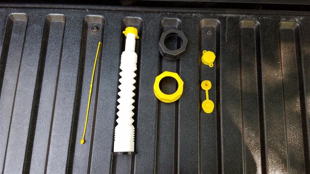

    Only the U.S. Government could take something as simple as a plastic gasoline can and regulate it to the point of near unusability.
    All gas cans sold after 2009 must be equipped with spill-proof vapor-proof pour spouts which usually require three hands to operate: One to hold the can, one to pull back the slide valve on the spout and one to aim the spout where you are pouring it.
    Then a couple weeks ago while browsing some YouTube videos I stumbled on a solution to this awkward problem in the form of the EZ-Pour Spout Replacement Kit. It seems that selling gas cans without the spill-proof spout is illegal but selling non-spill-proof spouts by themselves is not.
    The kit comes with a 6-inch flexible spout (with cap and spare cap), two screw rings (with different threads sizes) to screw the spout to the can and a vent opening since the spill-proof spouts have their own venting system.
    In my case neither of the screw rings fit the threads of my cans so I just used the original rings which worked nicely. Then you just drill a ½-inch hole in the can somewhere above the full line, pop the vent unit into the hole and you are all set.
    Pro tip: Install this when the can is empty. Then rinse it out with a small about of gasoline to wash out any plastic particles that may have fallen in when drilling the hole for the vent.
