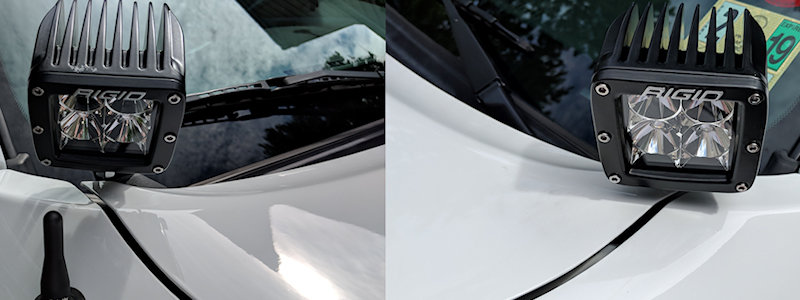

    Busy day at the Dog House today and hotter than Papa Bear's Porridge. Simply standing outside in a white T-Shirt and I begin to sweat like a whore on Dollar Day.

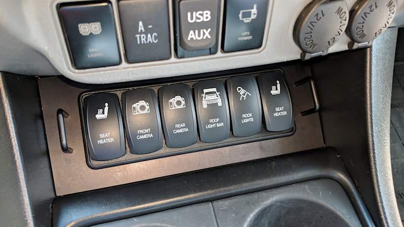

    So anyway I got the ditch light brackets that @Dhannah sold me along with some Rigid floods I picked up at Carlisle two weeks ago. Don't have them operational yet; I need a new way to get the wires through the firewall. The big grommet where the main wiring harness goes through is completely max'd out so I'm working on a second pass-thru. Ordered some parts but probably won't have everything until next week.
    Also figured out the right switches to use with my @Iggy panel. Only the seat heaters are hooked up at this time but the rest soon will be.
    Stay tuned. The best is yet to come.

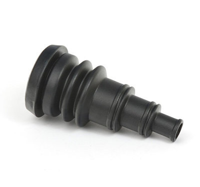

    By the way, I solved the more-wires-through-the-firewall problem with one of these guys:
    https://www.amazon.com/Daystar-Univ...8&qid=1535335891&sr=8-1&keywords=daystar+boot
    I drilled a 1-inch hole kind of Southeast of the factory pass-through and inserted this. Tore the shit out of my hand reaching up to grab the wires (the parking brake pedal bracket is in the way and it has sharp edges) and it was bleeding like I was competing at a Blood Bank but I got everything through OK. The ditch lights work now.

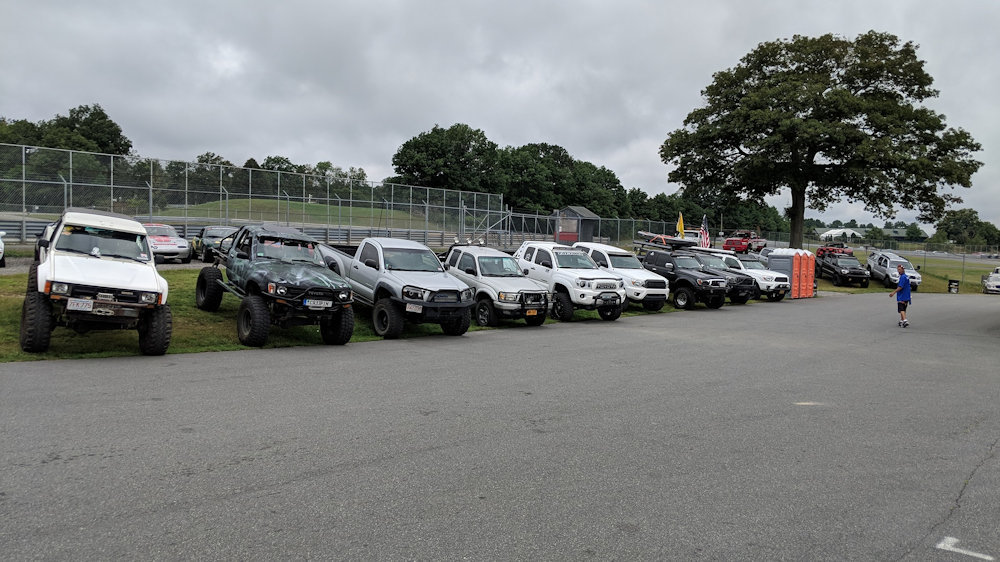

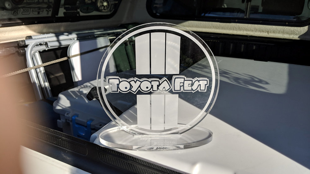

    The dog and I went to ToyotaFest - East at Thompson's Motorsports park in Connecticut this past weekend. I took Friday off from work, left at 4:00am and arrived in Hartford, CT around 2:00pm. Hartford was the closest place that had a decent hotel but was still an hour away from the Park. I had e-connected with some Taco guys through a Facebook page and we all gathered at 9:00am at a shopping center about 10 minutes from the park, then all rolled in together.
    Lucky me, they put me at a spot right next to the Porta-Potties. Actually, it turned out to be rather convenient.
    My ever trustworthy dog Scooter got right down to business with his Chick Magnet duties.
    Here is "Tacoma Row". A few more Tacos showed up after this pic was taken.

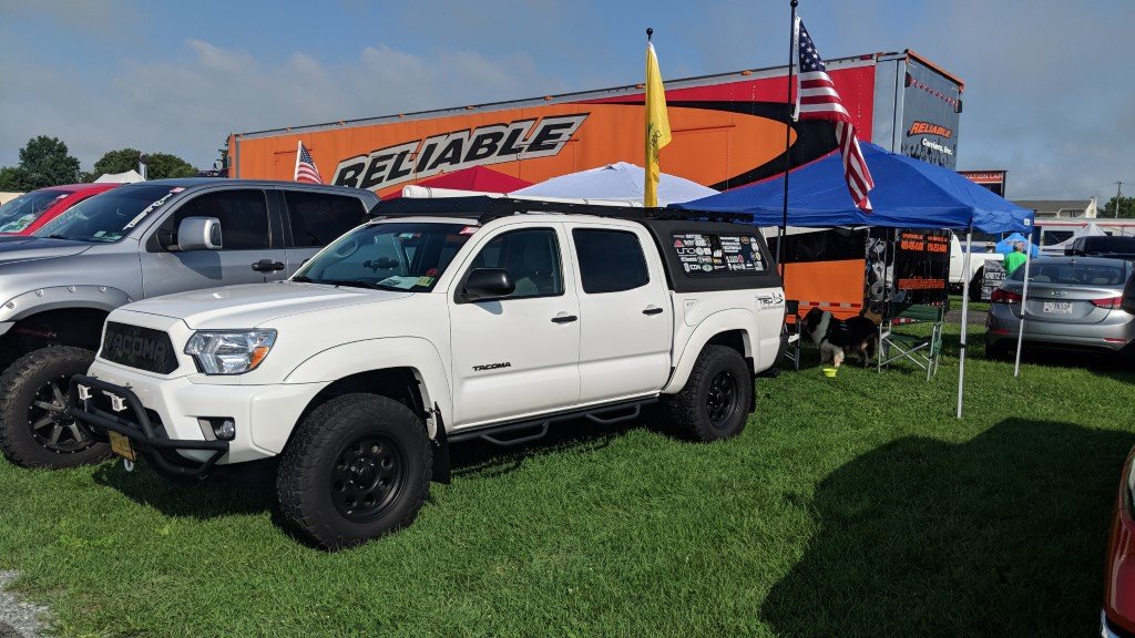

    And when all was said and done, my truck took home its first trophy!
    We went to Church Sunday morning and headed home at 8:00am. Got back to the Old Dominion about 4:00pm.

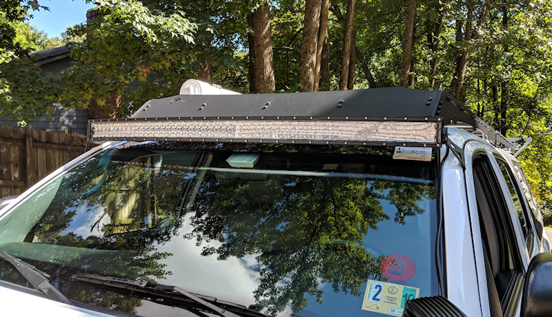

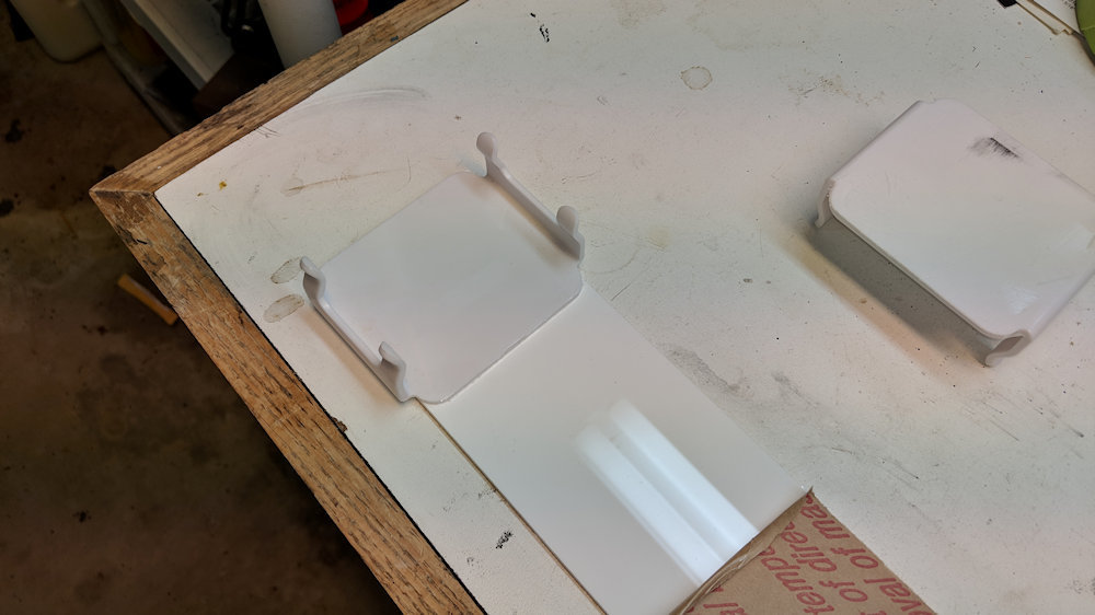

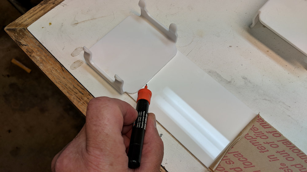

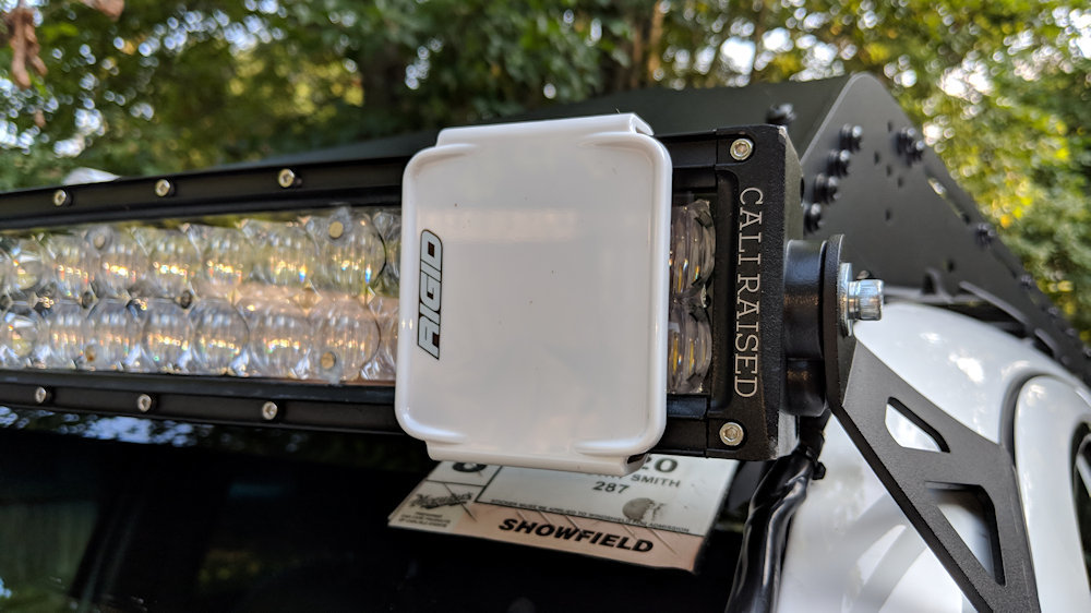

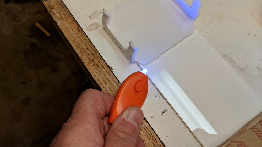

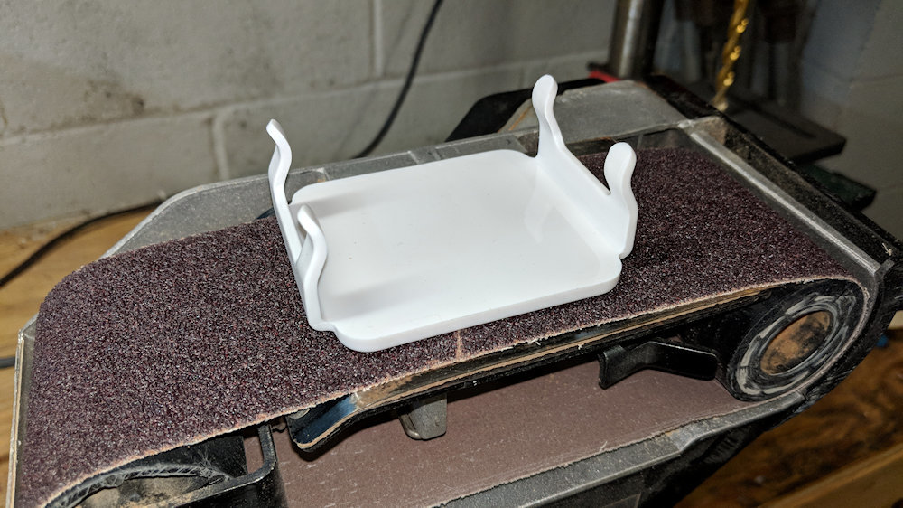

    OK. I finally came up with a solution for a cover for that @CaliRaisedLed light bar. The cover they sent me, which is made by a third party, was a total piece of Brown Stuff.

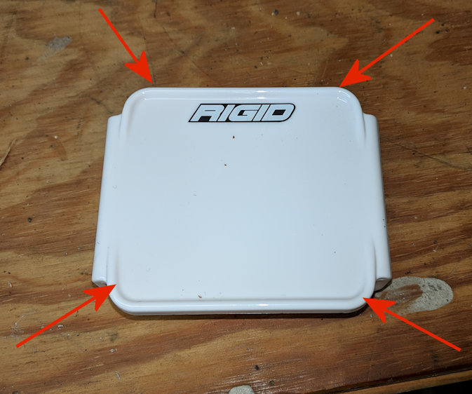

    Shortly after installing the bar I discovered that a Rigid Pod Light cover when turned 90 degrees snapped on perfectly to the Cali Raised bar.
    So this gave me a delightfully awful idea: Build your own light bar cover and use Rigid pod covers to secure it to the Cali Raised bar.

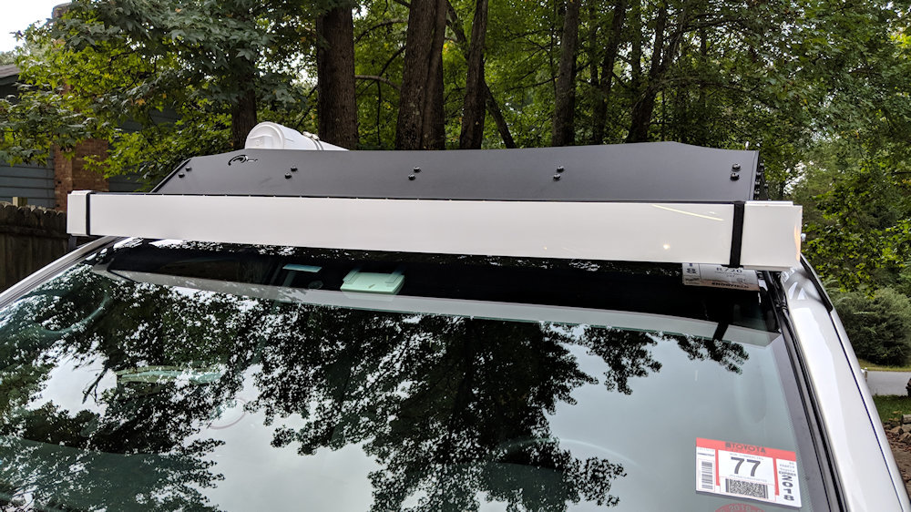

    Since the Internet is my BFF, the first thing I did was look for a place that supplies custom-cut Plexiglas. I found this outfit:
    https://www.tapplastics.com/product/plastics/cut_to_size_plastic/acrylic_sheets_color/341
    and ordered a piece of solid white acrylic plastic 52" x 3" x 1/8th". Had it in less than a week. I also ordered a couple of Rigid pod light covers from the Big-A.
    https://www.amazon.com/gp/product/B007NKQ1N0/ref=oh_aui_detailpage_o00_s00?ie=UTF8&psc=1
    The best stuff I've ever found to glue plastic is this:
    https://www.amazon.com/gp/product/B07DM39WBK/ref=oh_aui_detailpage_o01_s00?ie=UTF8&psc=1
    So I ordered it was well.

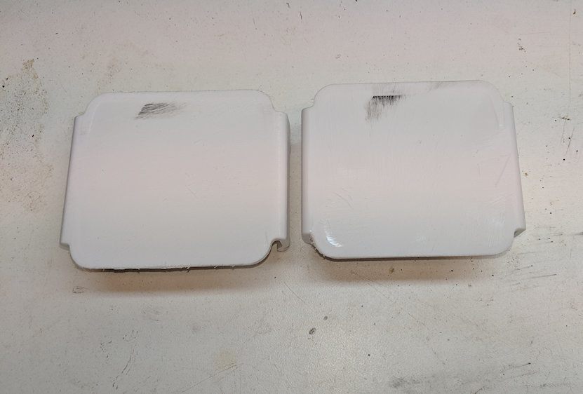

    In order for the pod covers to have a solid contact with with the acrylic strip, I sanded the fronts of the pod covers smooth. Since I don't have a bench-top belt sander, I improvised:
    ...so I could sand the front of the Rigid covers smooth.
    The finished product:
    Now to the assembly. I peeled off about 6 inches of the Acrylic strip's protective paper backing and carefully placed one of the pod covers on the end.
    Applied the liquid glue.....
    And set it with the UV light.
    Repeated this process for all four edges and then attached the other pod at the other end of the Acrylic strip the same way.
    And Voila! The final product installed on the Cali Bar.
    I have a piece of Velcro strip temporarily wrapped around each end to help hold the new cover on. I'm hoping that by having it all sit out in the hot sun for a few days the heat will allow the new cover to shape itself into contouring with the light bar.
    And @CaliRaisedLed, if you're reading this, could you send me a decal so I can decorate it up a little? Thanks.
    Stay tuned.
