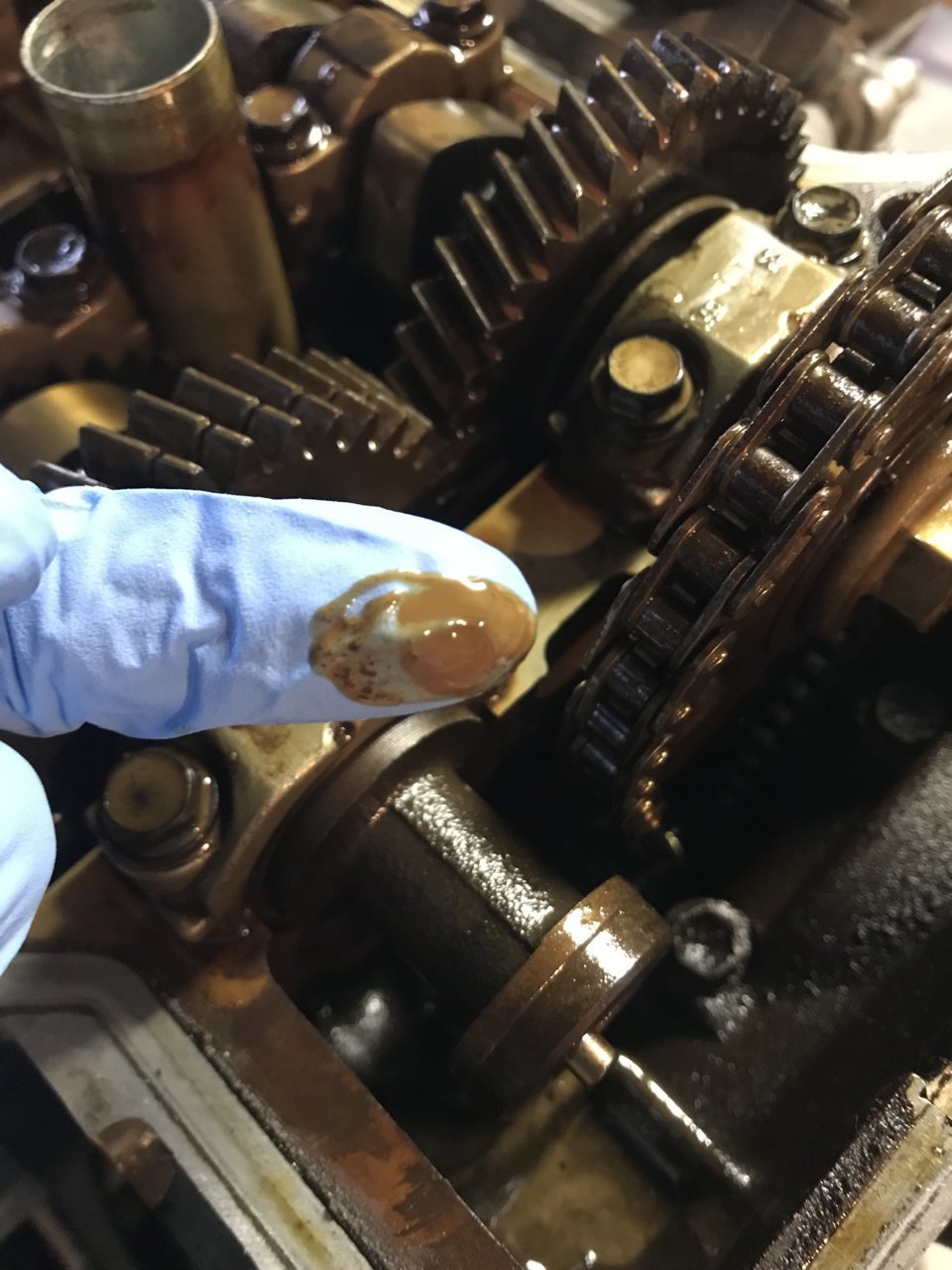

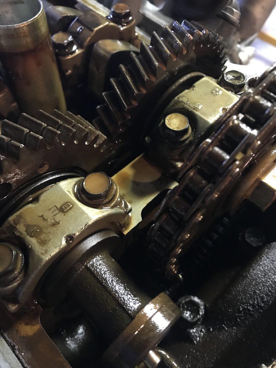

    Well I took the valve cover off and it looks like some lighter colored oil in there sitting on top of the cam bolts. Does this look worrisome? Or is this ok for an engine that hasn't been run in two weeks with no oil in it? I flipped the engine over and got some more oil into the pan, I poured that out into a clear container to see if there was an coolant settling out in the bottom, I'll look later today. This is the engine I got from the salvage yard with 153k on it. The compression was good and the truck drove into the lot with a rear end collision. IMG_9808.jpg IMG_9809.jpg

    The oil looks like it has some water in it. Could be from condensation (not problematic), or much worse, like a cracked head with coolant contamination. I'd inspect the head and water jackets. Might even want to have it magnafluxed to try to ID small cracks not readily visible.

    Oil prob. just has some condensation on top. Check the valve lash since you're there and put it in.
