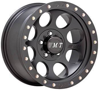

    Have these sitting in the garage waiting for mounting
    17x9 4.5 backspacing
