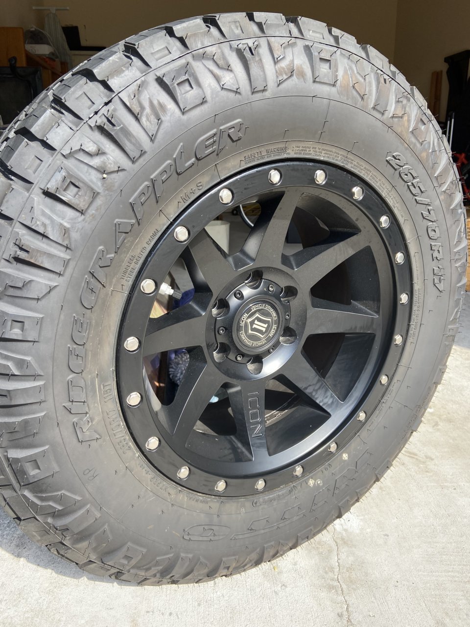

    Standard load tires look goofy when they are installed on wider than factory rims.
    This is an example. You get this bulging effect on the sidewalls, rather than the flat firm look. They are valid for up to 9” rims but I always preferred how they look on 7.5”
    it’s all preferences, just sharing. Buy what you like.
