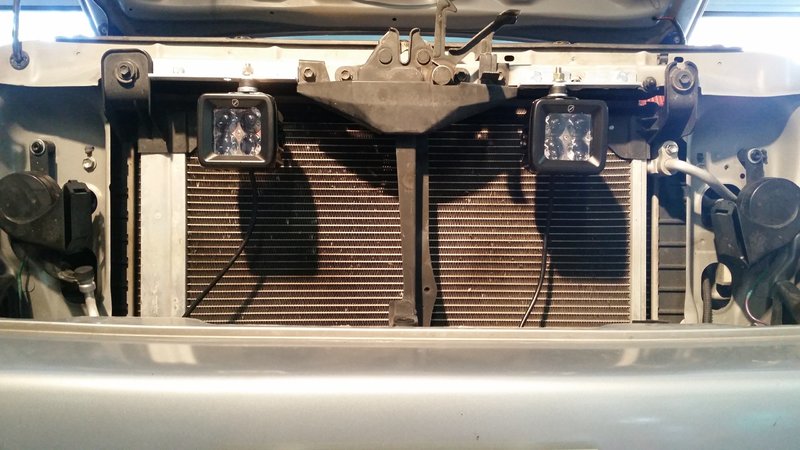

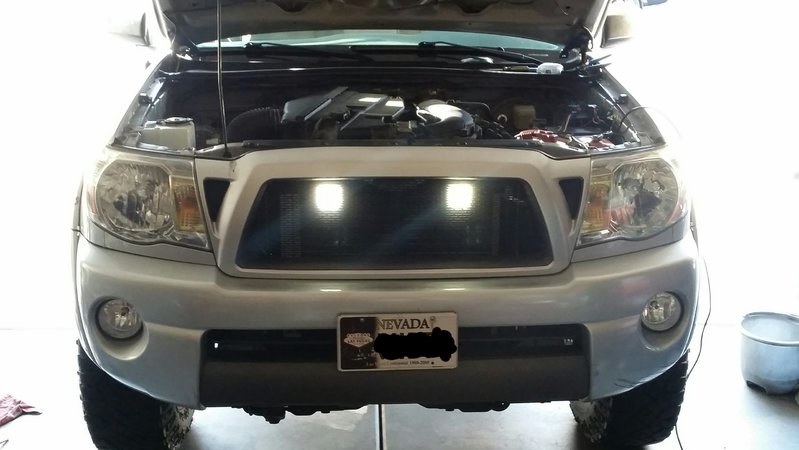

    I installed some pod lights behind the grill
    Light output sucks behind the grill so I will change that soon.

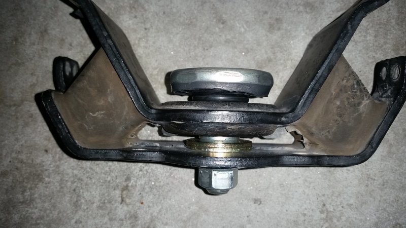

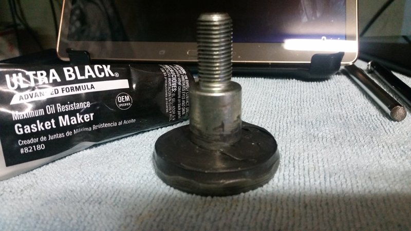

    I made some adjustments on my trans mount...Likely the cause of the clanking I feel through my shifter over bumps. I added some washers to allow for more adjustment and made a bed of gasket maker for more cushion.

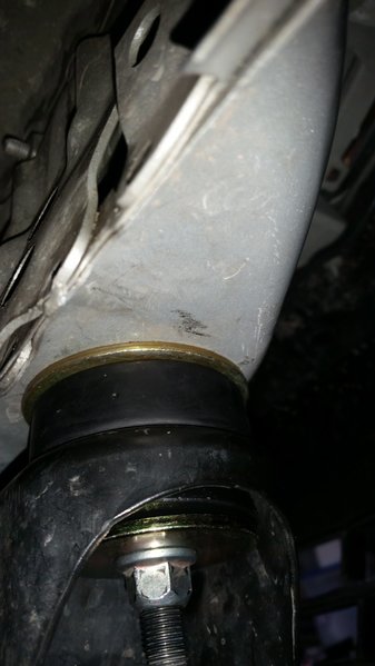

    And today I reinstalled my Energy Suspension core support bushings so that the large one is on top

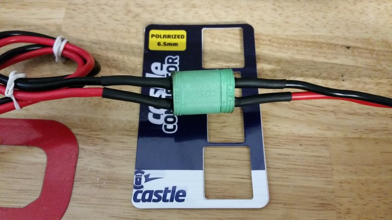

    I did some work on the wiring harness for the air compressor today. I used connectors from the RC world, 6.5mm CastleConnector rated for 200 amps.
    I'll mount it in my Pelfreybilt bumper where the winch would go when I get it installed, but in the meantime I'll just use the compressor as a portable unit with alligator clips.

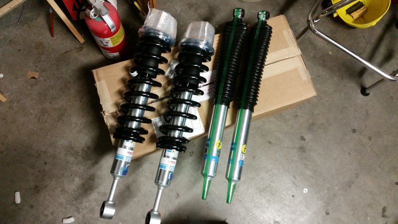

    Arrived today: Bilstein 5100 front with OME 887 coils and Bilstein 5125 rear shocks. Dakar rear springs on the way.

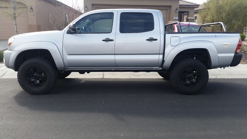

    I installed the new suspension this weekend. Luckily my 70 yr old neighbor came by to see what I was up to this time so I handed him the prybar while I installed the coilovers.
    I worked well into the night to get the rear finished.
    I had this little f'er try to roll up on me while I was laying on the ground.
    I gained about 3 inches of lift all around.

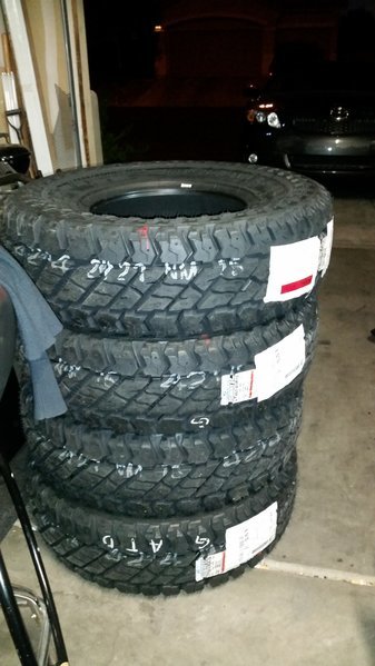

    Tires go on at the end of the week.

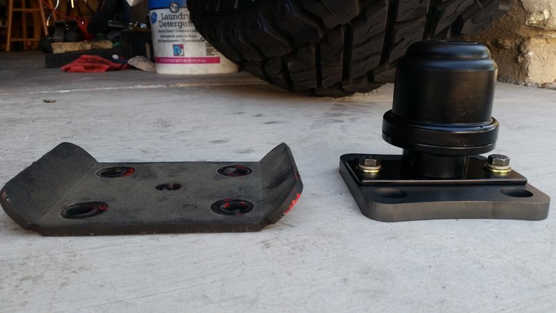

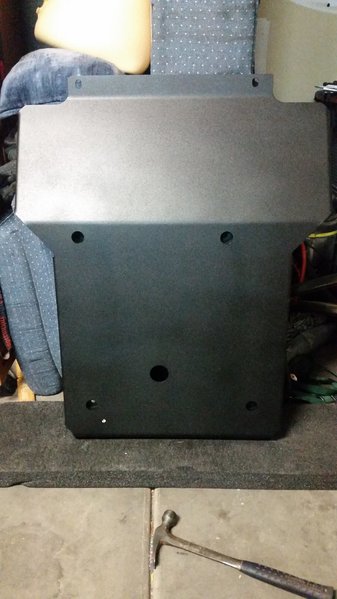

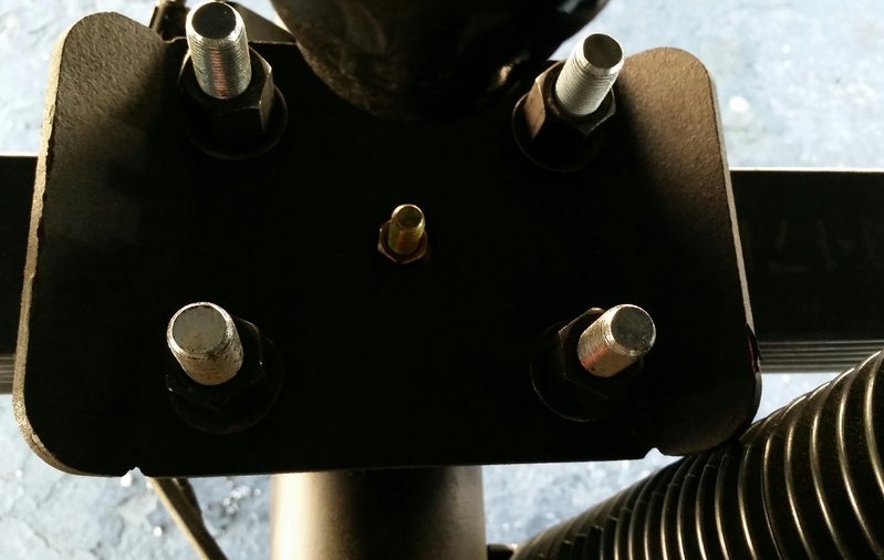

    I have a vibe at 10-15 mph. I'll put a spacer on the CB and see if that takes care of it. I also have extended brake lines arriving today (hopefully mine go on easier than yours). I used the Relentless u-bolt flip kit and it almost hits the shock body on the passenger side so I'm ordering the AllPro kit and Wheelers bumpstops (the Relentless strike plate is massive compared to AllPro). I'll take a pic in a bit. I put the Pelfrey IFS steel skid on the other day and everything lined up perfectly. Can't wait to get some customization done to the bumper so I can get it off to PC. Tires go on tomorrow afternoon, then alignment. Stay tuned for pics. I'm anxious to see how the Camburg UCA's work for you.

    The Relentless strike plate

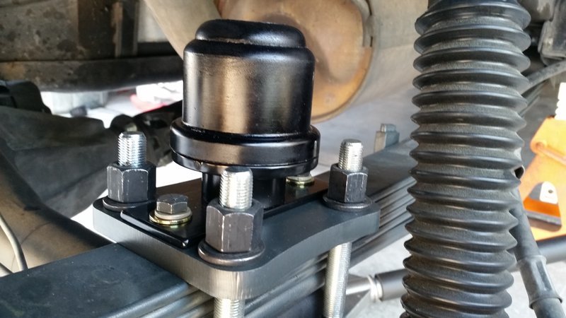

    I swapped out the Relentless strike plate for the AllPro with Wheelers bumpstops this morning.
    No contest.

    Looks great! Nice comparative photo. Good luck on the brake lines. May the truck gods be on your side. :D

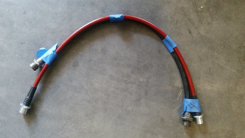

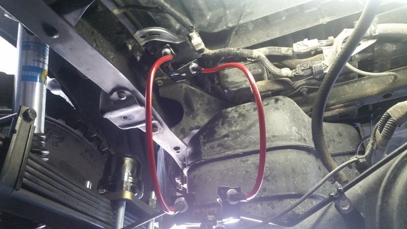

    @Crom ,the truck gods were in fact with me this morning. I didn't have any problem separating my brake lines, but it is a PITA, and I don't wish to do it again.
    Old vs New
    Installed
    ready6delta, omaguz and Crom like this.

    Thanks. They broke loose pretty easily. It was a victory for mankind...If I had the issues you did, bad things would've happened. I didn't even use penetrating oil.

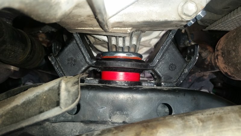

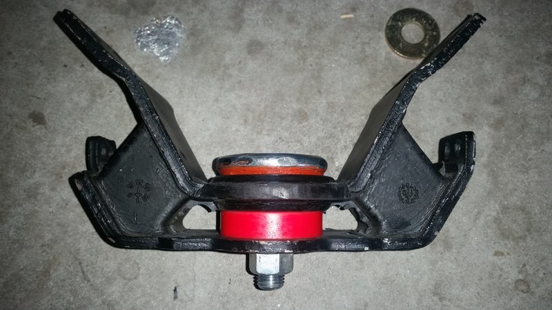

    My semi-solid transmission mount.
    I'm still on a quest to cure a knock in the drivetrain when going over bumps so I ordered another set of bushings to fill the gap in the trans mount. It is incredibly solid, and best of all the knock has been virtually eliminated.
    The extra support is noticeable, and gives confidence.
    Installed.

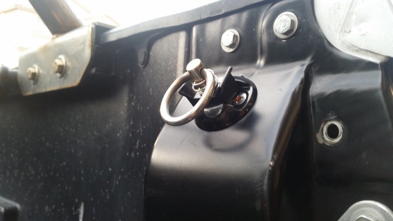

    I added a motorcycle tie down point from US Cargo Control this past week.

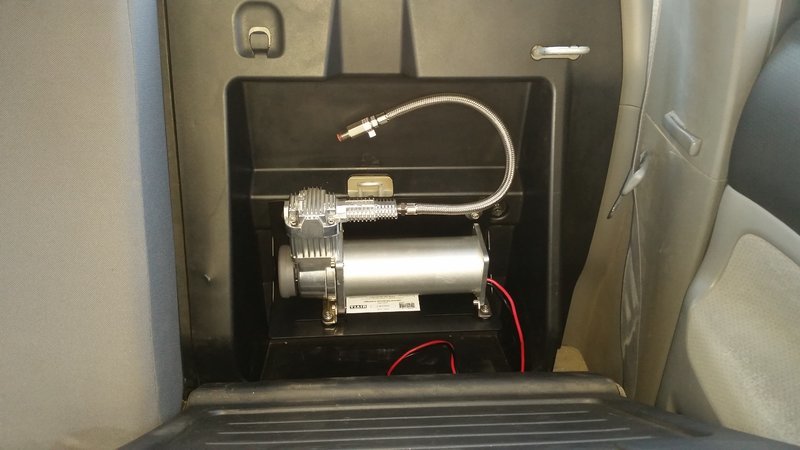

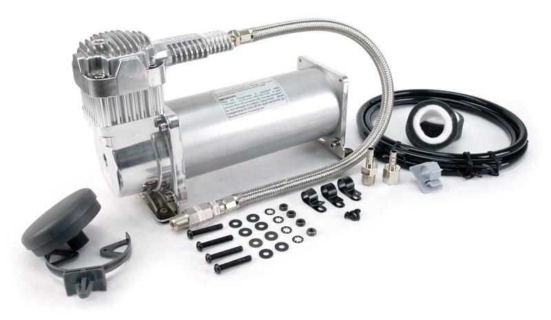

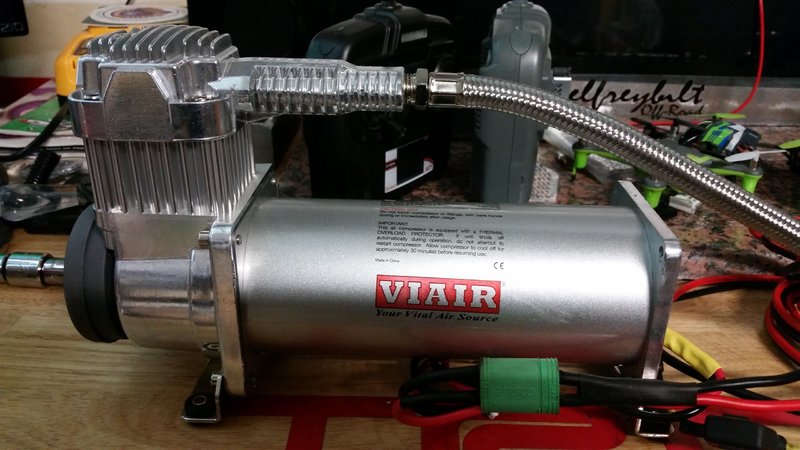

    ...and test fitted the compressor for OBA behind the rear seat. Looks pretty good.

    is this a necessary thing? Just curious never seen one before.
    also what compressor is that? and do you plan on having an external air supply?
