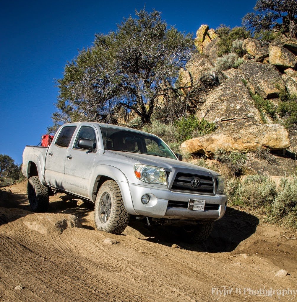

    I purchased my Tacoma used in March 2011 with 25,000 miles. I hadn't planned on buying a new truck, but I became impatient at the dealership while the wife was trying to make up her mind whether to buy a new Camry. I wandered around the lot and found this Tacoma. I traded-in my 2004 base Tacoma that day, and the wife still couldn't decide what she wanted until 2 months later.
    This is my first 4X4. All of my previous offroad experiences were in cars and 2WD trucks dating back to the late 80's, all of which were manual transmissions. I have no experience offroad with an automatic.
    Unlike most people I don't have a photo of her the day I brought her home, but this was taken a few months later while checking out the 4WD system.

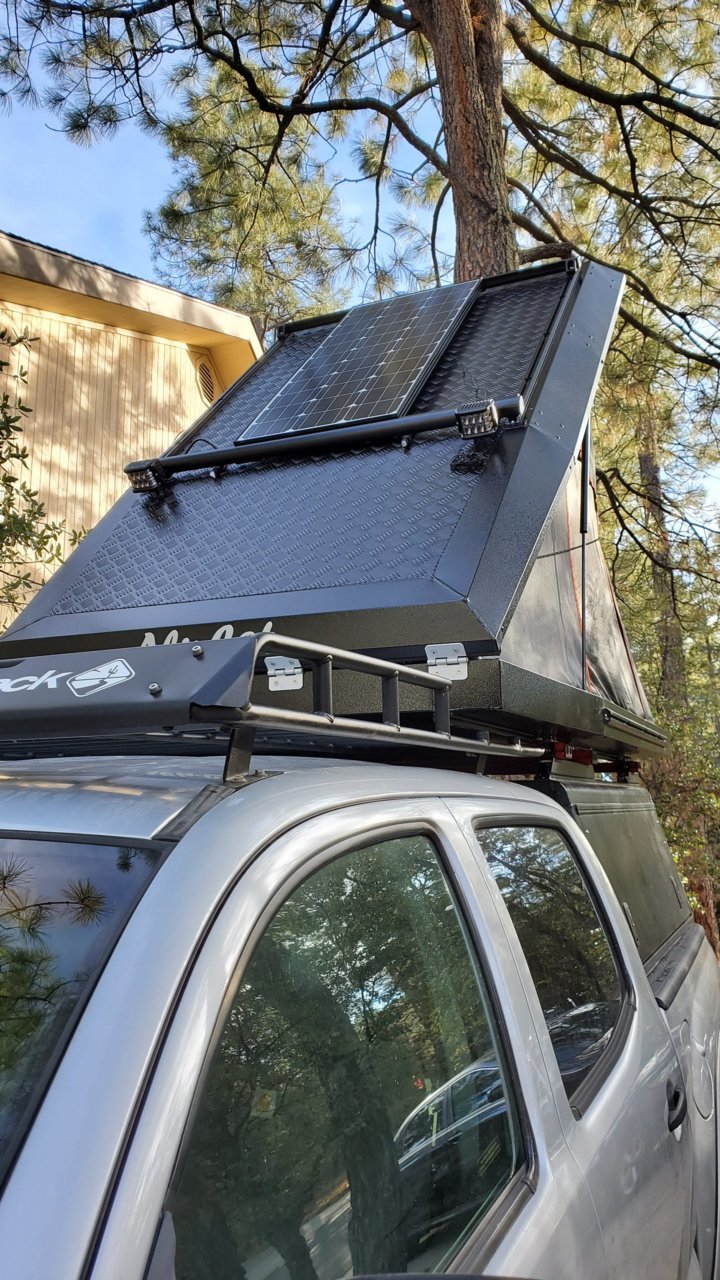

    Camping:
    - AluCab Canopy Camper
    - AluCab Gen 3 Expedition Tent
    - Alucab Shadow Awn with Custom Walls
    - Alucab Shower Cube
    - Tepui 4' Awning
    - Decked Bed
    - Dometic CFX 40 Fridge
    - AluCab Tilting Fridge Slide

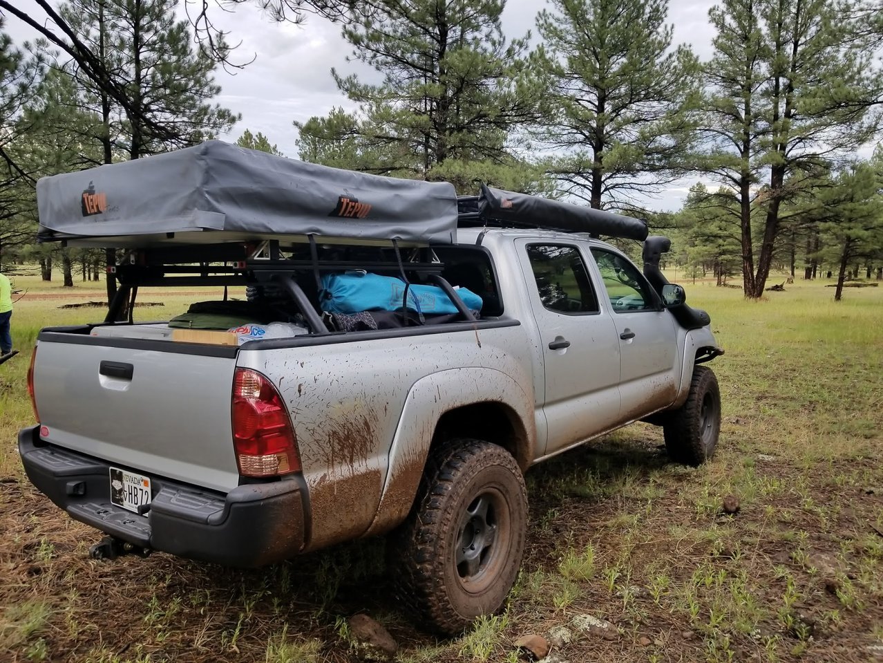

    Loaded up for camping
