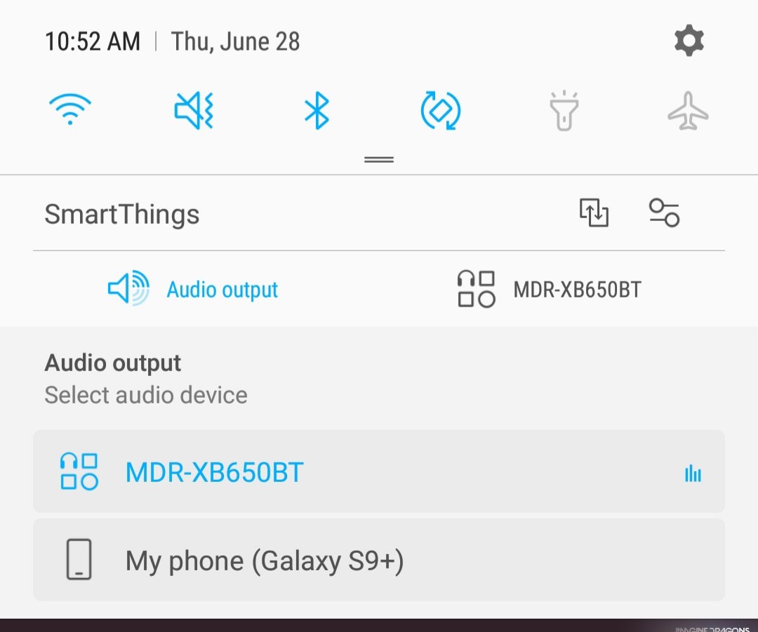

    Check the audio output on your phone(drag down on the notification bar and it should be below your quick settings and above any notifications) and make sure it's set to the truck
    Call audio and media audio outputs are different as far as the S series phones go

    2012 TRD double cab long bed
    I dont have smart things turned on. Am I supposed to?

    no, its for smart home stuff

    You need to change the audio output of Waze to the phone. This is accomplished by swiping down the notification shade when you're in the truck and bluetooth is connected, and it will have an audio output option. It will, ny default, go to the truck. So if you have Waze going and you're listening to the FM/XM radio, its sending the audio to the bluetooth in your radio. Changing what I just said will allow it to play over the phone.
