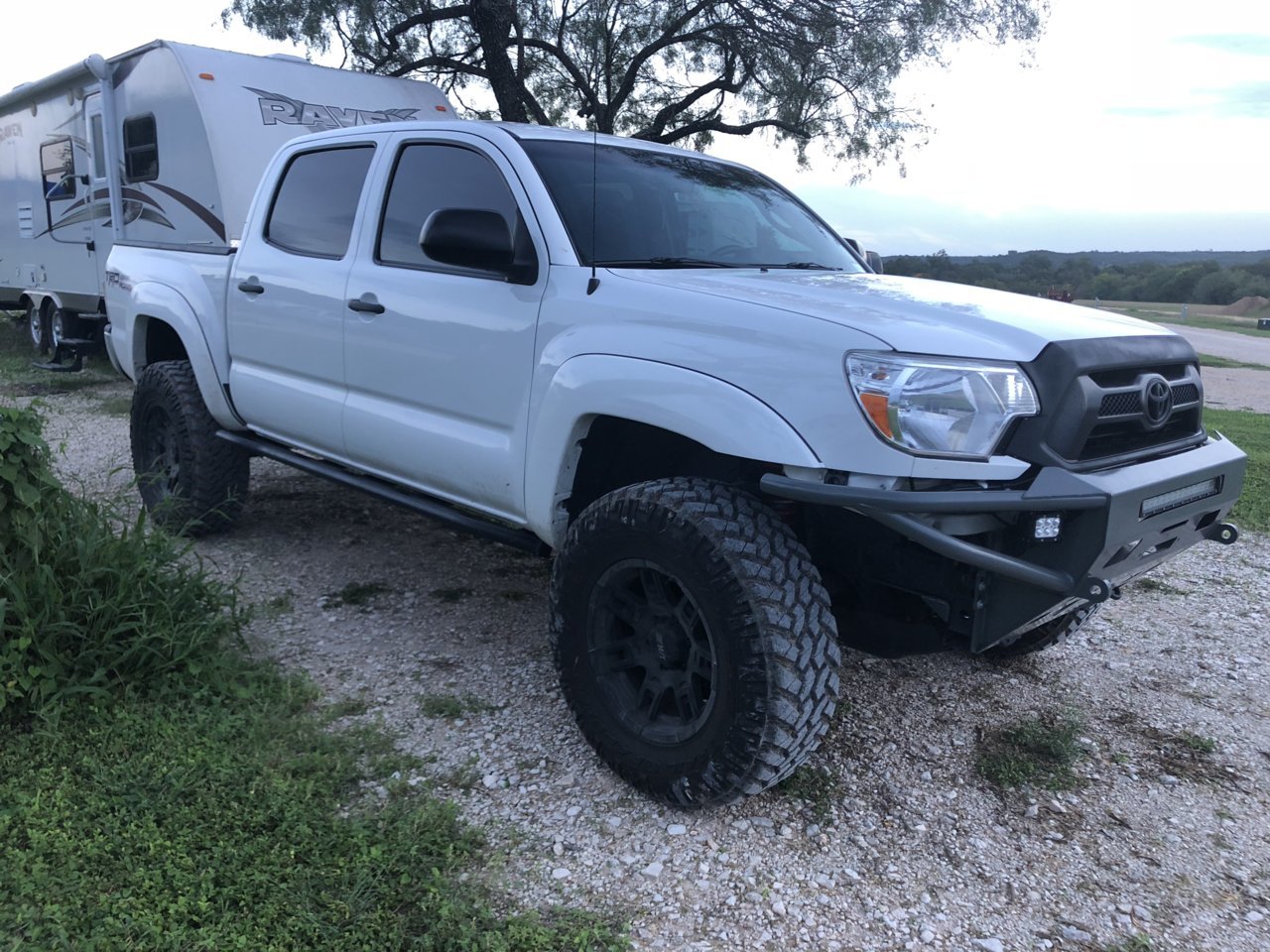

    It looks very similar to where the cuts were on mine
    That high up gets tricky to cut because our second gen fenders have a subtle curve to them. When measuring from the top down, it'll throw off your measurements and your cuts will come out fucked up like a football bat.
    Once you remove your old bumper and flares:
    .5) Verify your level of commitment. There is no going back. Have a beer.
    1) Park your truck on level ground. Shim the front or rear tires as needed to level the bed. I verified mine was level with a 4' level and checked level front to back and side to side on all bedsides.
    2) Use making tape to tape 4" above and below where you'll be making your cuts.
    3) Measure from the top the suggested amount near the taillight and Mark it with a black sharpie. Move forward toward the cab about 4" and repeat.
    4) I used a laser level with a magnetic base to draw a line. Line up the dots in the beam and verify the beam is level. The laser draws a straight line around the curved fenders for a perfectly flat and level line.
    5) Using a straight edge and a black sharpie, trace the line.
    5.5) Triple check your work so far. I recommend doing BOTH sides before you begin any cutting. Take a step back and verify it looks straight. Have a friend critique. A quick cell phone picture and post to TW IS a good idea. Hell, take shots of both sides, crop them and match the lines up. Anything to look at it from as many views as possible.
    6) I recommend making a few practice cuts in the metal 3-6" below the actual cut. This will give you a good idea what it'll feel like on the actual cuts.
    6.5) Have one or more two beers. Adjust for your personal tolerance.
    7) Using a NEW 4" cutting disc, proper eye protection, ear protection, and your preference in loud music (I prefer metal for this kind of work), carefully cut along the line.
    8) Using a NEW flapwheel, make a quick pass perpendicular to your cut to remove any burrs. I always go in the opposite direction I went in when I cut.
    9) Spray the cut with some clear coat to prevent rust.
    10) Repeat steps 7 - 9, 6.5 is optional.
    11) Once both sides are cut, remove the tape and mount your flares with all available hardware. You want it to move as little as possible and sit as natural as possible. Using a single piece of tape, match the cut across the flare.
    12) Take a step back and verify it is straight. Use a small level to verify it is level across the flare. Triple check.
    13) I used a Dremel tool with a new cutting disk to make the cut along the bottom of the tape.
    14) Using a mid grit sandpaper, buff the edge to de-burr.
    Some people say to cut 1/4-1/2" lower on the first cut. I disagree. Like completely disagree. Measure twice, cut once. If you do and you mount the bumper and find you need to trim, it's a real bitch. The metal will be much more floppy and it'll come out not-so-good. There go your perfect cuts. Just do the practice cuts well below your actual and do the actual cut ONCE per side.
