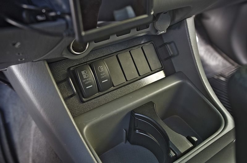

    It's not incredibly difficult. I run mine on a SPDT three-way switch. I can flick em on manually, turn them completely off, or have them come on automatically with the factory backup lights.

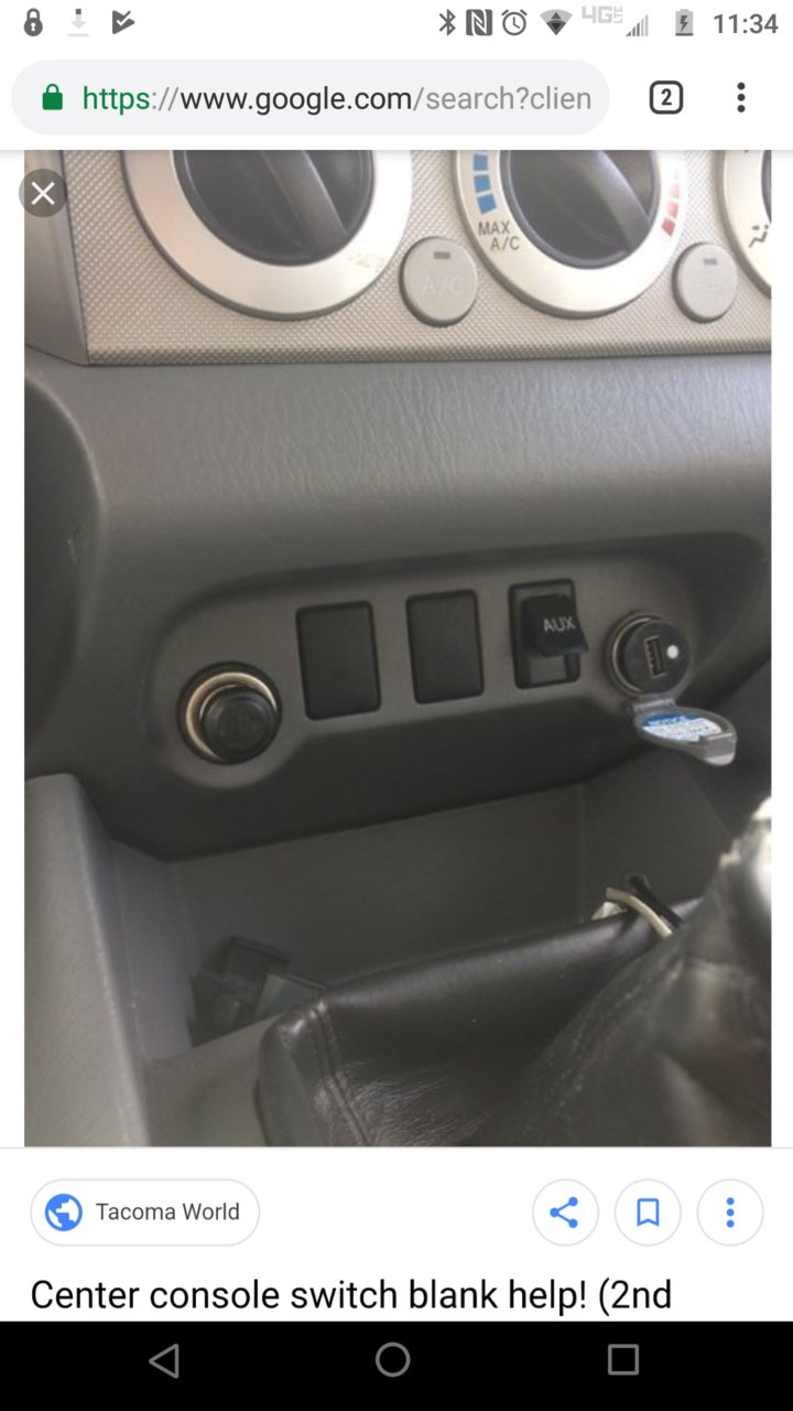

    I want this ran out of places to put switches Screenshot_20181031-230446.jpg

    I've got the materials and the majority of work done to make one of these
    I just need to dedicate some time and energy to completing it.

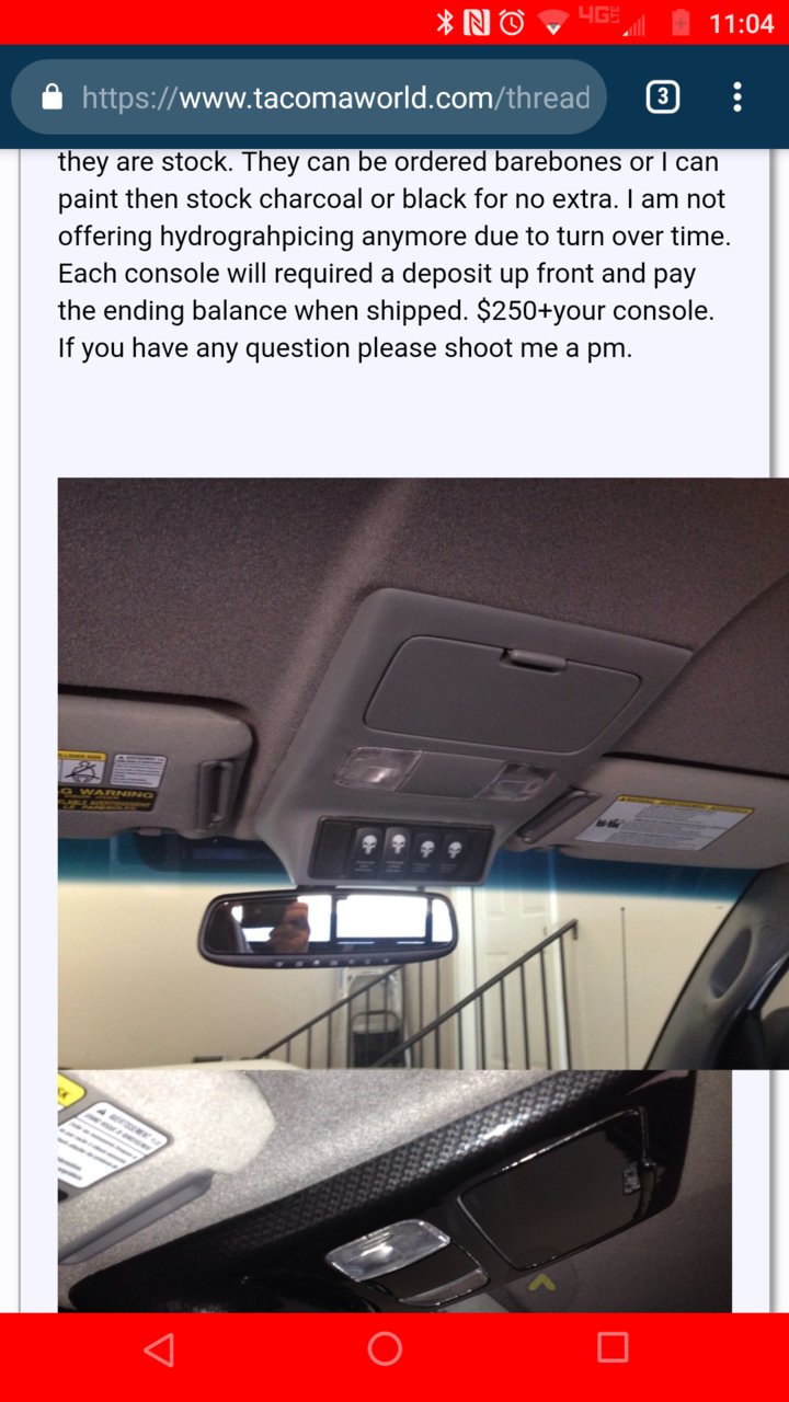

    Also stalling because I think meso is working on one for up to six switches in the factory second gen overhead.

    I'm going to look for the lower dash with blank switches first before I start modifing things

    Sort of
    I have most of the six-panel harness pre-wired but a lot of it I can't do anything with until install.
    I was certain I had more and better pictures than that one but that's a bit of the six-panel.

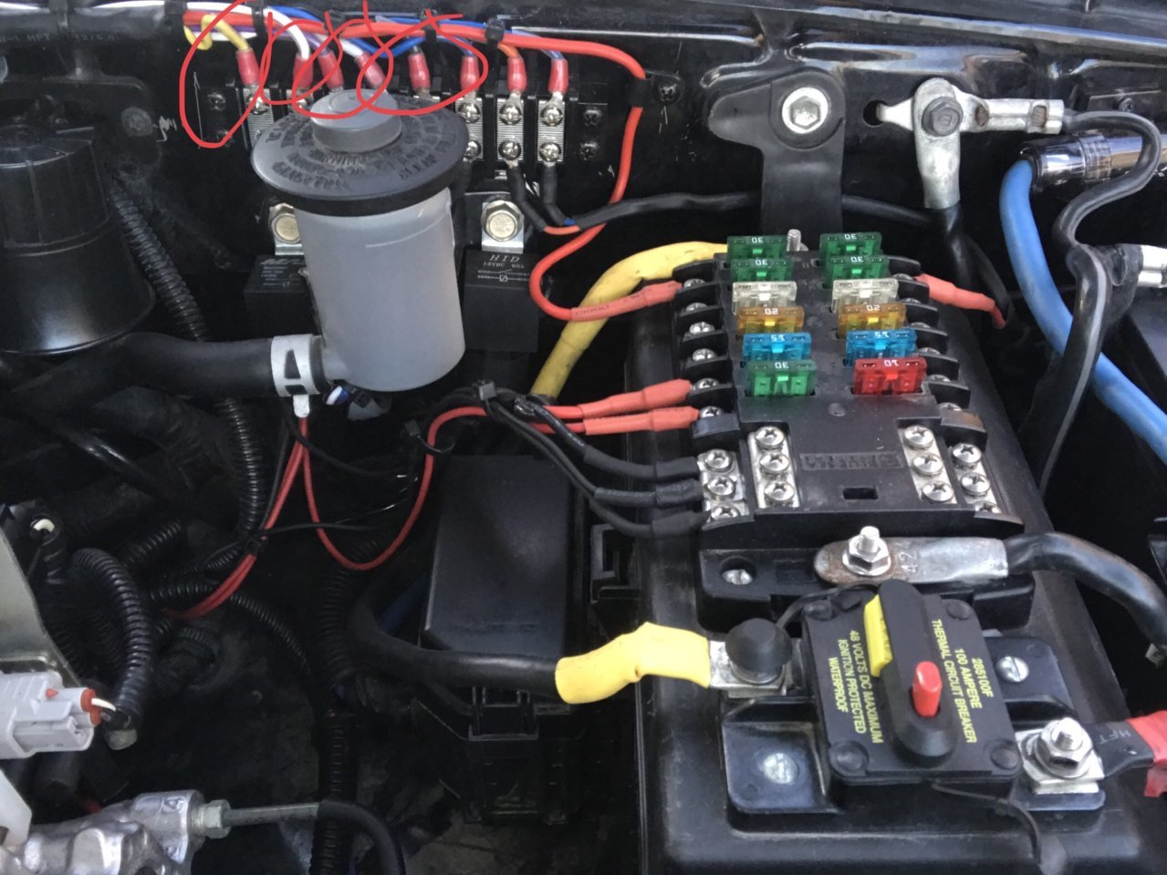

    Went from
    To
    With
    I moved the factory fog wiring harness to the center switches and the A-TRAC switch to the factory fog light location left of the steering wheel with the locker button. All traction control buttons are driver side access only and all the auxiliary lighting is center.
    And I'll be adding six more circuits eventually.
    It's a PITA.
    But I enjoy it.

    Nope.
    I'm a pilot.
    And an OCD perfectionist.
    It's a curse.
    The circled wires piss me off every time I pop the hood but fixing them means at least a day's work and replacing entire lengths of wire for fractions of an inch.
