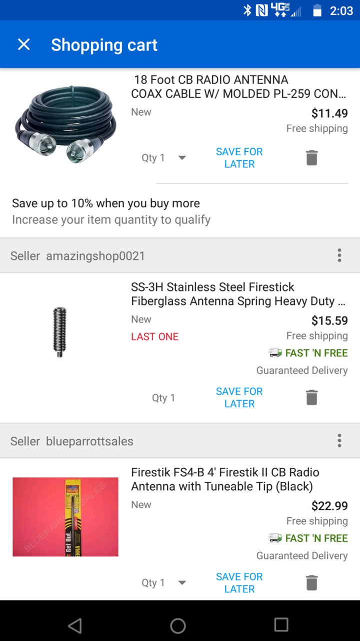

    18ft is a lot. I had a few extra get at my center console with 9'.

    I'm going under the driver seat from passenger fender

    So maybe 12'

    That shouldn't require too much. I did the same on mine. Ran it through the passenger fender where the Factory antenna grommet is. Ran it behind the glove box, and under the door sill trim on passenger side. You can transition from under the door sill, to under the floor and come out under the seat where the airbag wiring comes thru

    I have power from the battery under the seat already cause of my amplifiers

    So cb just has power ground and antenna does it use a remote wire to turn it on and off with the key

    Or is it better to just turn it on and off using power knob so I can use it with the vechile off

    Kinda depends. It would be okay to use it on and off with the power knob if you could remember to turn it off. Otherwise you may end up with a dead battery. Also something to be aware of is that you could potentially have some parasitic drain on your battery if you go the hard wired route using your amp's power source. If you use a keyed power source, you can turn the accessory on and be able to use it without the truck running, but still not have to worry about accidentally leaving it on and it running down your battery

    The only way to have it do this is to use a fuse tap (or some other keyed power source) to have it turn on when the key is on. I can show you what you need and how it works if you want tomorrow
