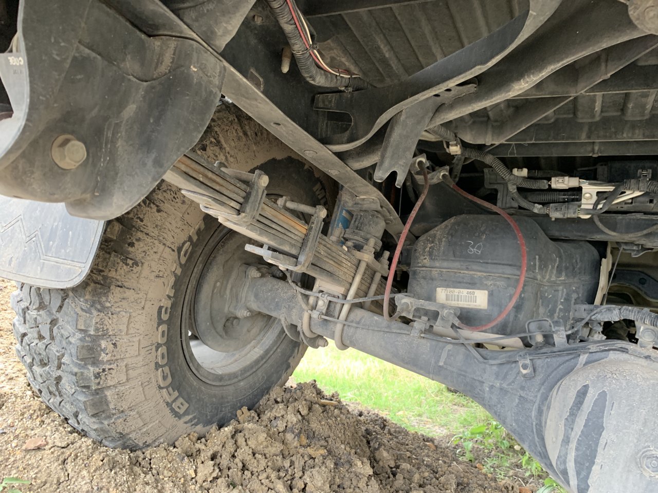

    Sounds like a nice setup. The limit straps are a good idea. The other day when I was getting those pics for Matt, I don't think I overextended the shock but I know I was getting damn close. I'm concerned if I lift a rear tire it'll happen. Limit straps are great cheap insurance and peace of mind.
    Have you seen that setup with SUA? Link?

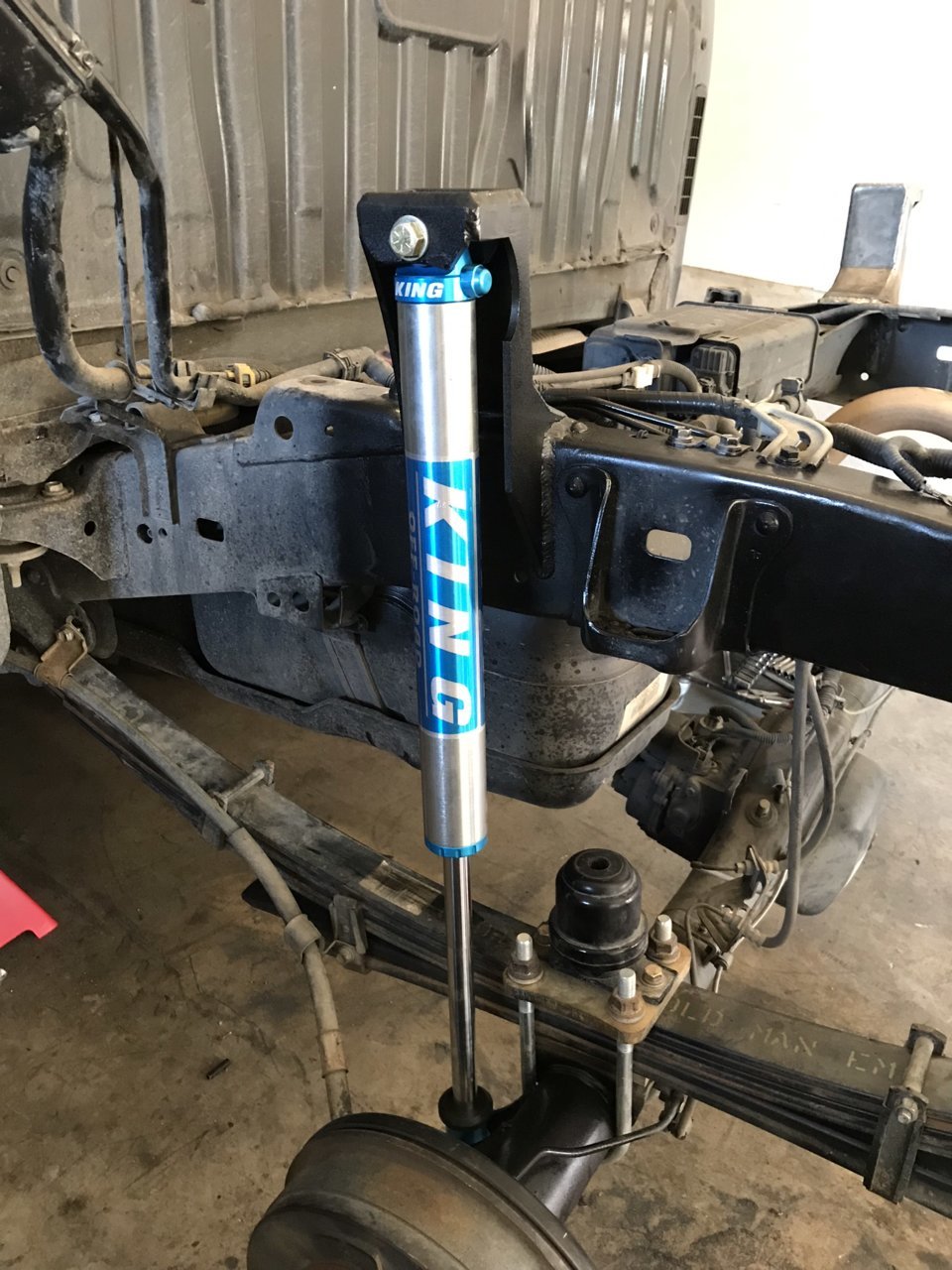

    You very well could do that setup one step at a time. Towers and Bilstein or even King smooth body shocks with limit straps will hold you over for a while. If you still wanted the resi's and clickers sell the old shocks and upgrade. You can also add resi's and clickers to the smooth body shocks to upgrade them. I don't recall if you need to remove the bed to install the TC mounts for the bump stops. My gut says no, if that's true you can add them later when you go full SUA. Piece it together little at a time, you know? Just my $.02.
    The BAMF towers are great! For the money, you're not going to find a better setup that won't have you cutting up your bed. Hell, you can even keep the fender liner in, trust me your want that. Unless you don't mind every tiny pebble sounding like gunshots and muddy water running out your fuel door after every puddle.

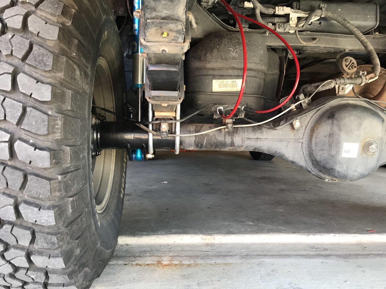

    Jerry confirmed you can run a 14" shock if you burn on the lower shock mounts low enough to fit the longer shock. Personally, I'm on the fence about this. After a bit of math, I think the 12's are the better option because you're going to get about the same flex (until you go SUA) and you're not going to be sacrificing that sweet, sweet ground clearance.

    Much better ground clearance.
    You can fit 2.5's with resi's. Jerry was thoughtful enough to notch the towers where the fitting and hose would run for zero interference.
    You can see the notch here.
    As for the smoothies, I'm very happy with them. They are simple and seem to perform well with everything I use the truck for. The rear is very stable and the ride is still much better over stock with the bed empty or with it full. I've done everything from slow trails to hauling ass down a tore-up beach; the shocks handle it all very predictably and very smoothly. If I had the money for resi's with clickers when I originally purchased, I might have done it but after riding on these socks for, what, two years now, I won't go that route unless I'm getting a killer deal and need new shocks.
    Lemme know if I can help out with any pictures or further details. If you go to that setup you're going to love it. It's a great design and it works well.
