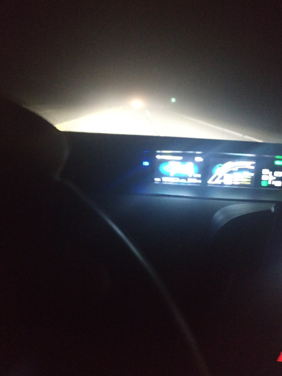

    So foggy I can't see your speed, so watch it. End of flat Earth is some where North West of Loretta as I recall!
    You will have some light rain and drizzle with you most of the night, so don't text and drive.

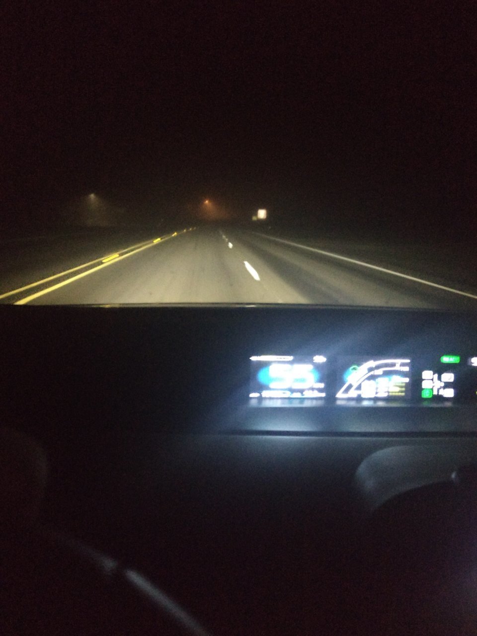

    Explain to me why I can see better without headlights onIMG_20190222_214757998.jpg

    OK, in low fog, your headlights cause glare, and return the light to you. Drive DIM not brights. If you have fogs, use them. They may only operate with headlights on - use them and slow down to improve your response distance.

    I posted sooner than I wanted, if you have no fogs, the LED DRL you have are "lower" that headlights in aiming. So, they won't reflect as much light back at you. Slow down, and just use DRL when it's bad, and you will see better. LED's also have a different "wavelength" (which is too long to explain) than Halogen or HID - the result is that their beam will go further!
    So for you, if BAD, use DRL . When better, headlights back on.

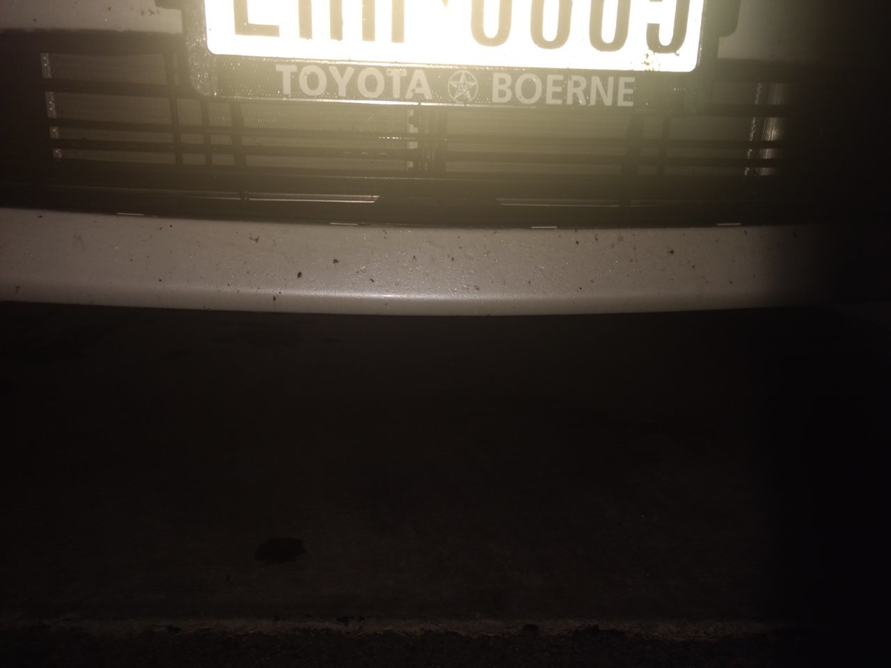

    Good, that's a big 10-4! so, drizzle and fog for you all night. You drove with DRL only when fog was bad, and it is better - YES? Because they are really aimed low, and really throw a long beam. Under the fog.
    When you turn your headlights back on, you get the light reflecting back.
    So, thick fog = DRL. Not bad = headlights. Rule 2 - never overdrive your visibility.
    End of lessons for tonight, but yes, your Prius might really like a yellow fog anytime mod!

    I used a variety of "C" clips, without screws, and let frictcion work. My truck, and sons old 05 Prius had same eggcrate at the bottom, so yes, possible without destroying any plastic.

    I measured it it's 18" across 4" tall so 10" or 12" slimline yellow led bar would fit

    it can. you want to do it without wrecking the grille tho. Even behind the grill. But yes.

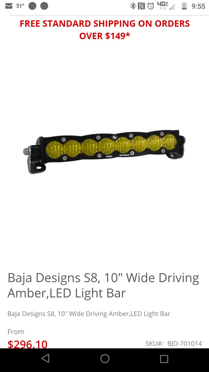

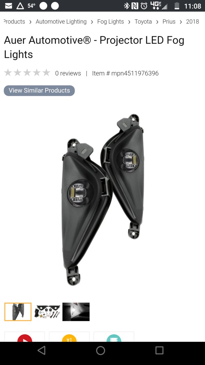

    But don't order anything that expensive. Lots of other choices. Amazon won't cooperate unless I load you, but you have a 2018 Prius Two, correct?

    There's room behind the grill
