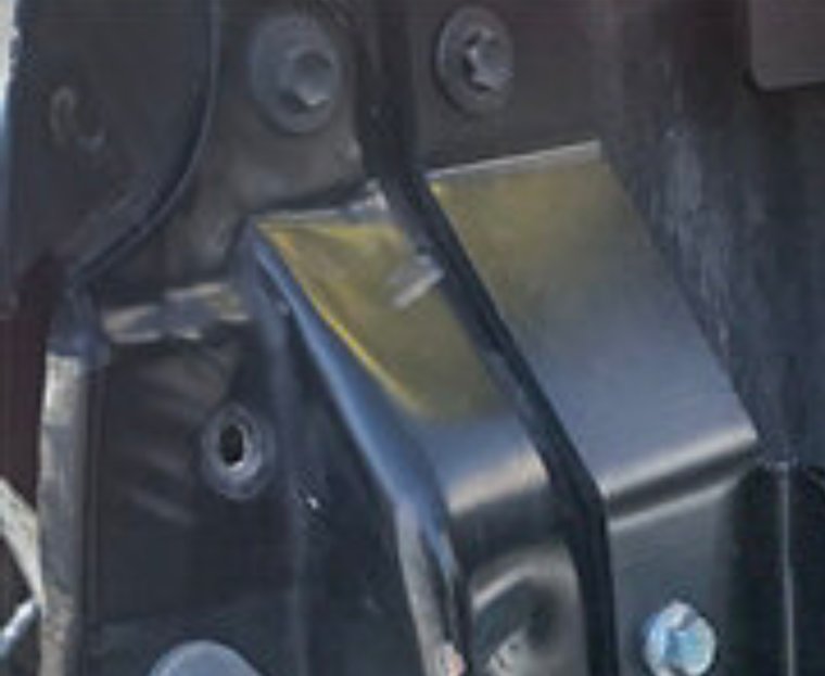

    Bracket is stainless steel I used the 2 bolts inside the bed Screenshot_20200120-000801.jpg
  12. Jan 20, 2020 at 1:03 AM
    Beretta4x4
    Beretta4x4 What makes the green grass grow? TTC#0114
    Jan 20, 2016
    #175568
    30,285
    Josh
    Temple, TX
    6-speed death mobile
    Sand/grind some paint off and see if it improves your ground. Check to make sure that area makes contact with the frame ground under the taillamp.
