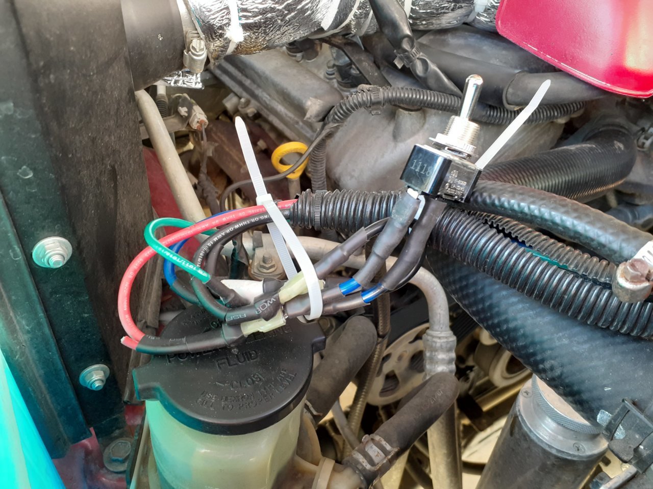

    Well I said I was...
    Here's the temp fix.

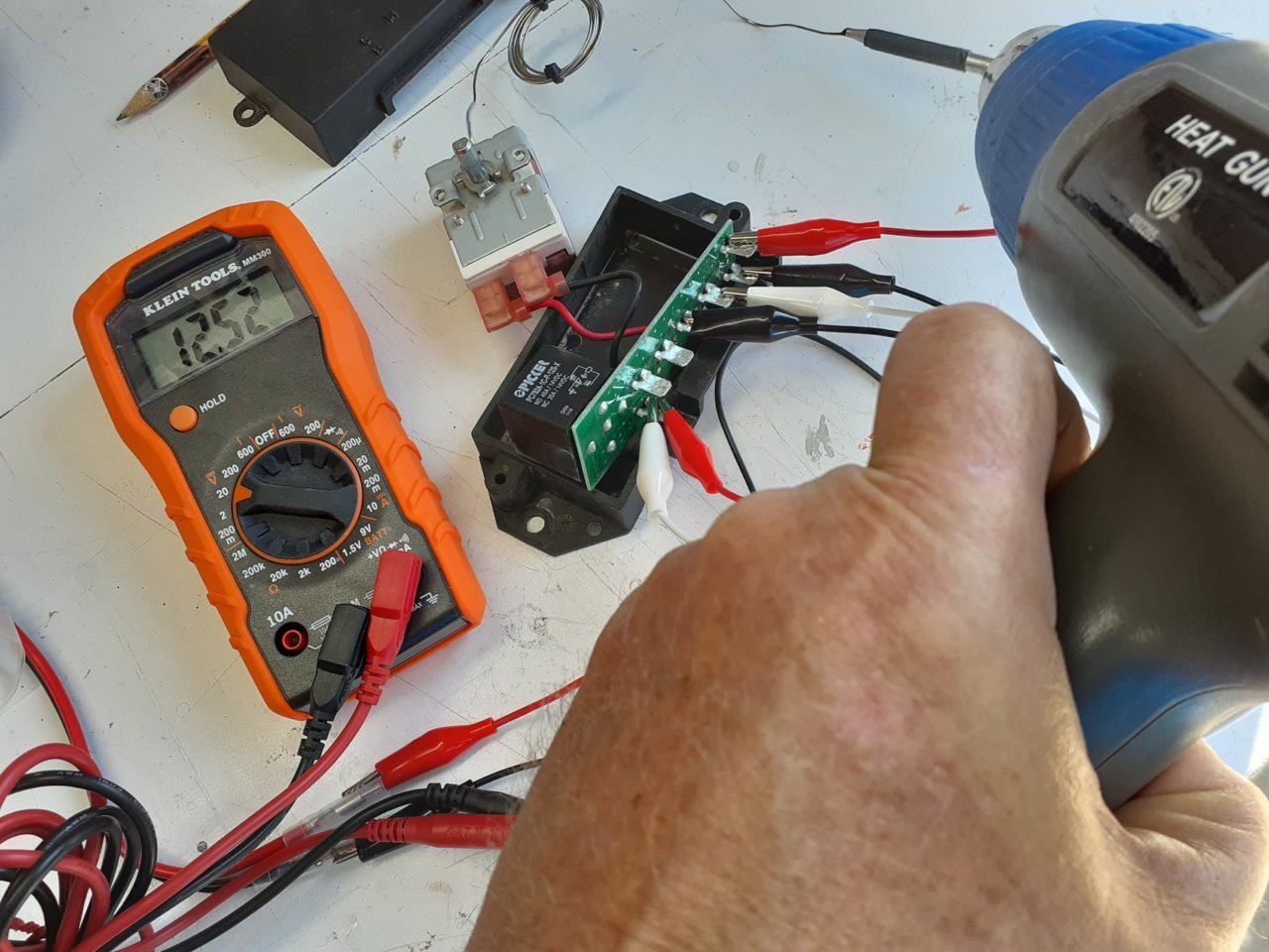

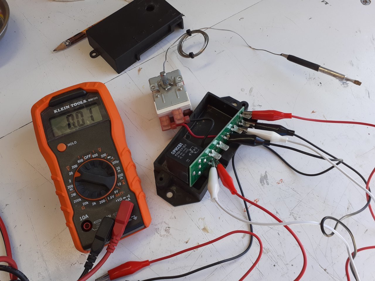

    Here's the old controller on the bench. I made it work. since I havent heard back from Jeggs this one going back in. The board sort of flops around so I added an insulator.

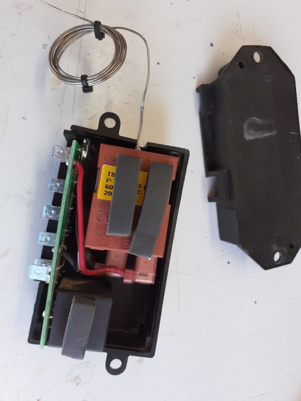

    Alrighty! I laid in some silicone to help keep the board in place, stuck in the plastic insulation, and stuck some foam on the control pot. I'm guessing it made intermittent contact between board and metal pot case.

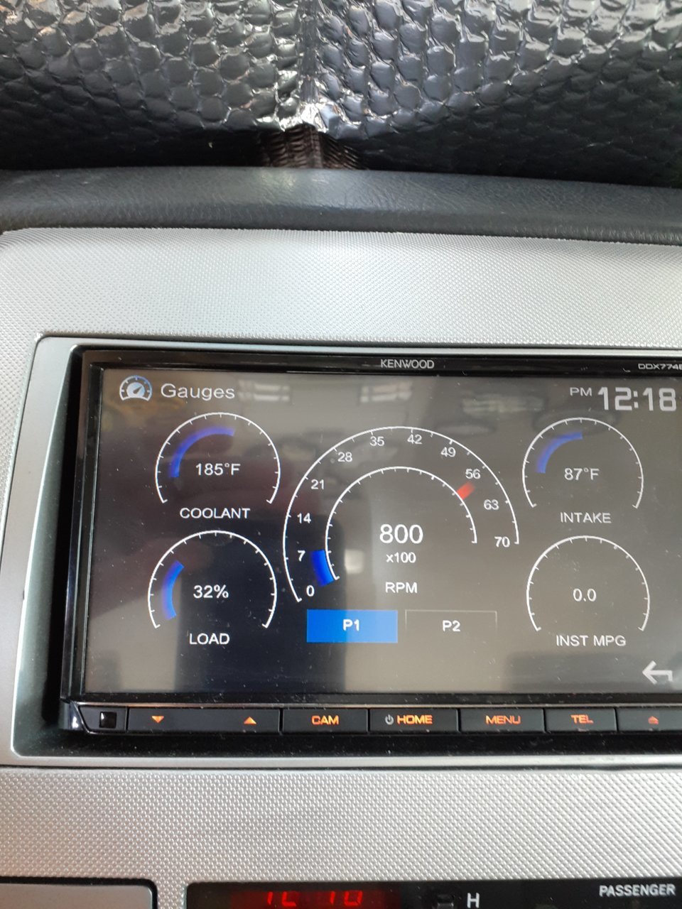

    Stuck it back in there, got a waiting beer for LBR to come to temp, set my display to gauges and....
    On the fan came at 185!
    I tweaked the control up a bit, I want it at 190. And just like magic!
