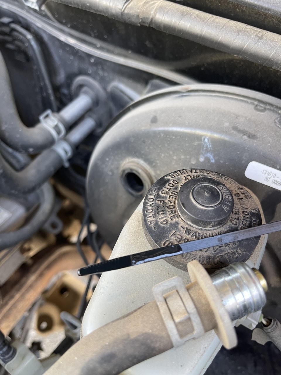

    No leaks al all, dry as a bone. I checked all the lines and junctions. My reservoir was low so I topped it off and pumped the brakes but they didn’t firm up. The fluid level dropped a little while I was doing that but I still don’t see fluid anywhere.
    Could be the master cylinder or booster. I don’t know where the fluid is disappearing to though.
    Maybe I got air in the lines.
    You don’t just get air in the lines all willy nilly though, I mean to my understanding that is. So there’s got to be something else going on right?

    Check the bleeders on the calipers and pull the drum and look there. Another possibility is that ur master failed and is leaking and the fluid might be in the booster.

    Or a leak could also be at the abs pump too. One thing your could do is get a tech stream dongle and run a test using the abs.

    The e-brake seems to function properly, I checked the cables and didn’t see anything out of order.
    Stuck a zip tie in the booster, came out wet.
    I’m guessing the seal between the master and booster kicked the bucket. The booster checks out, it’s holding pressure and seems proper. I don’t know what affect the brake fluid would have on the diaphragm though.
    I guess I’m going shopping, any brands you all trust or recommend?

    I would run centric. Could upgrade to tundra one.
