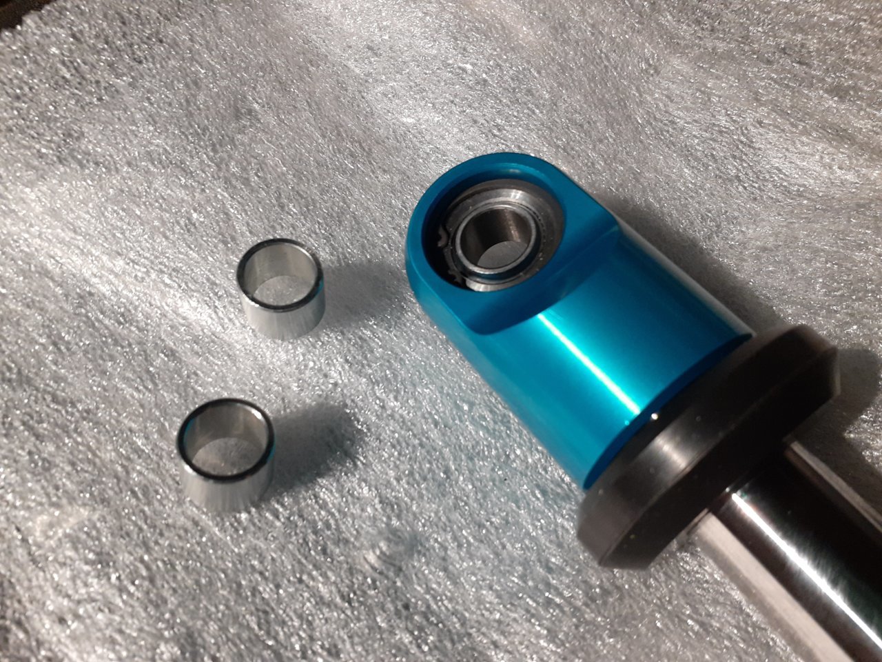

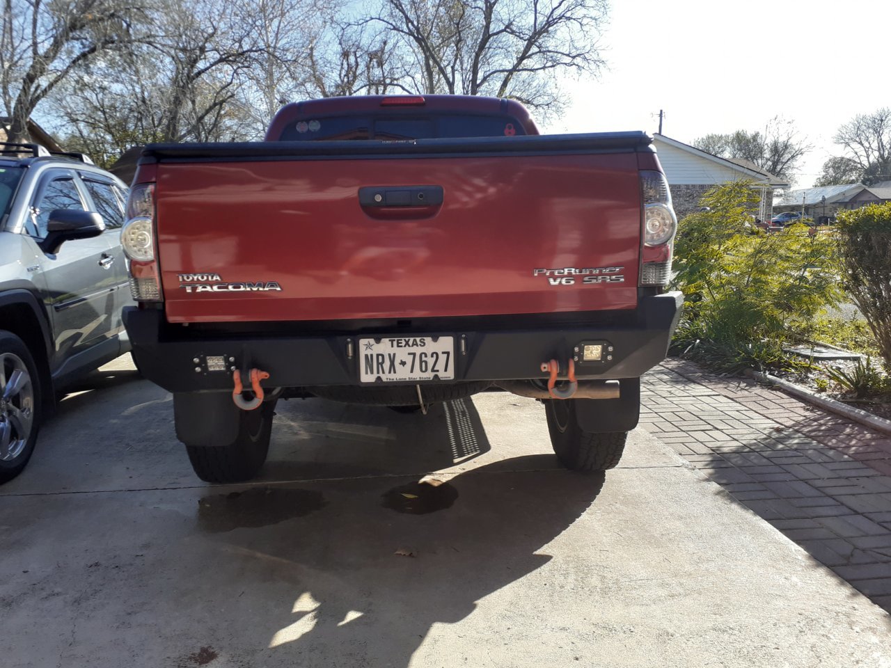

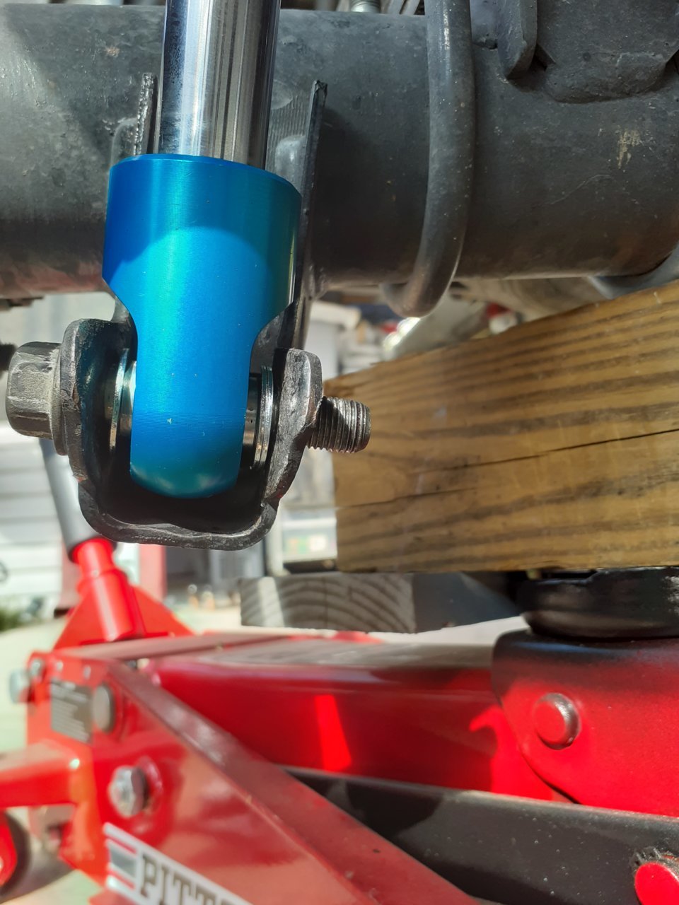

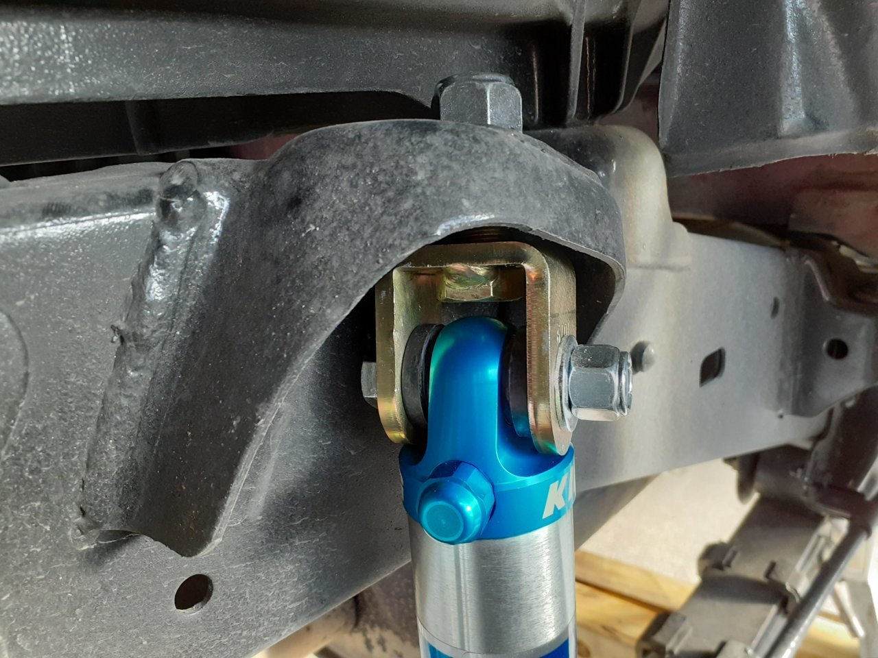

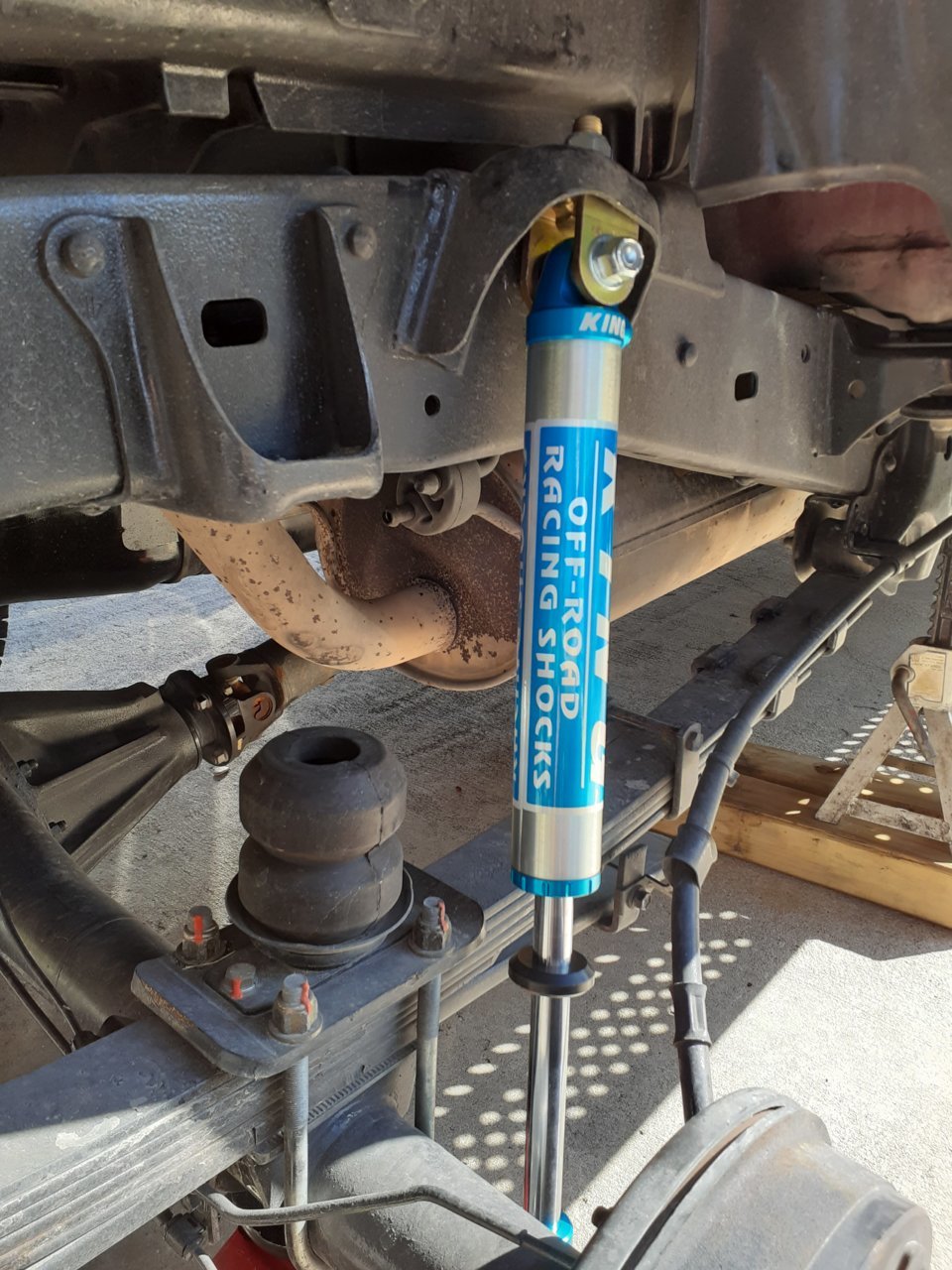

    I'm calling one done "good for the day!" As always, it was a compromise of visions. Cut all 4 spacers, impossible to work with otherwise. Added 2 bushings outside, 1 inside, that did the trick.
    Here we go.
    And, I have exactly one adapter worth of lift on that side!
    No point in pushing my luck on Christmas eve!! I go clean up now, have a beverage and Eve munchies! Merry Christmas everyone!

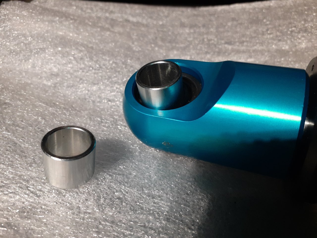

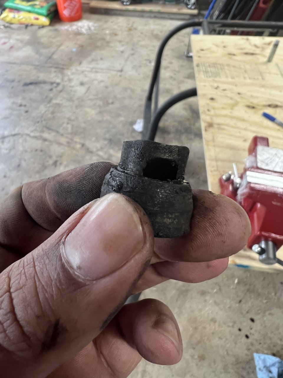

    That last pic you posted those aren’t the correct misalignment spacers you need I redid the front tho. Your rear setup is way different that my rears and what I’ve seen. Looks like you need a misalignment spacer nine the less. I know this because I just rebuilt the lower bearing put a new spherical bearing and figured I could reuse the misalignment spacers but they were trashed. Trying to get some new ones has been a pain. Should look like this just not thrashed

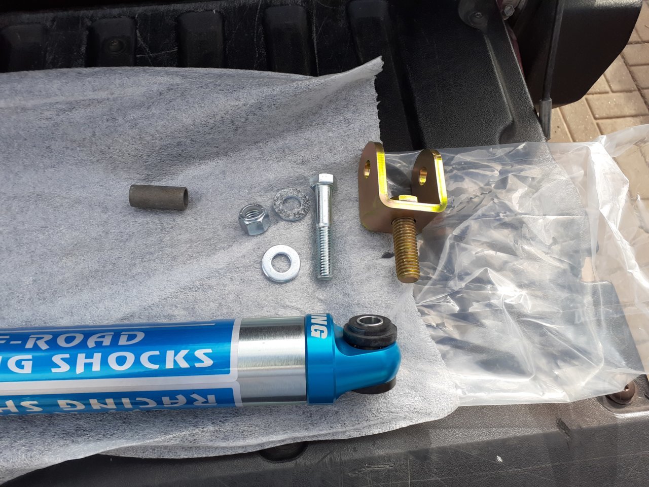

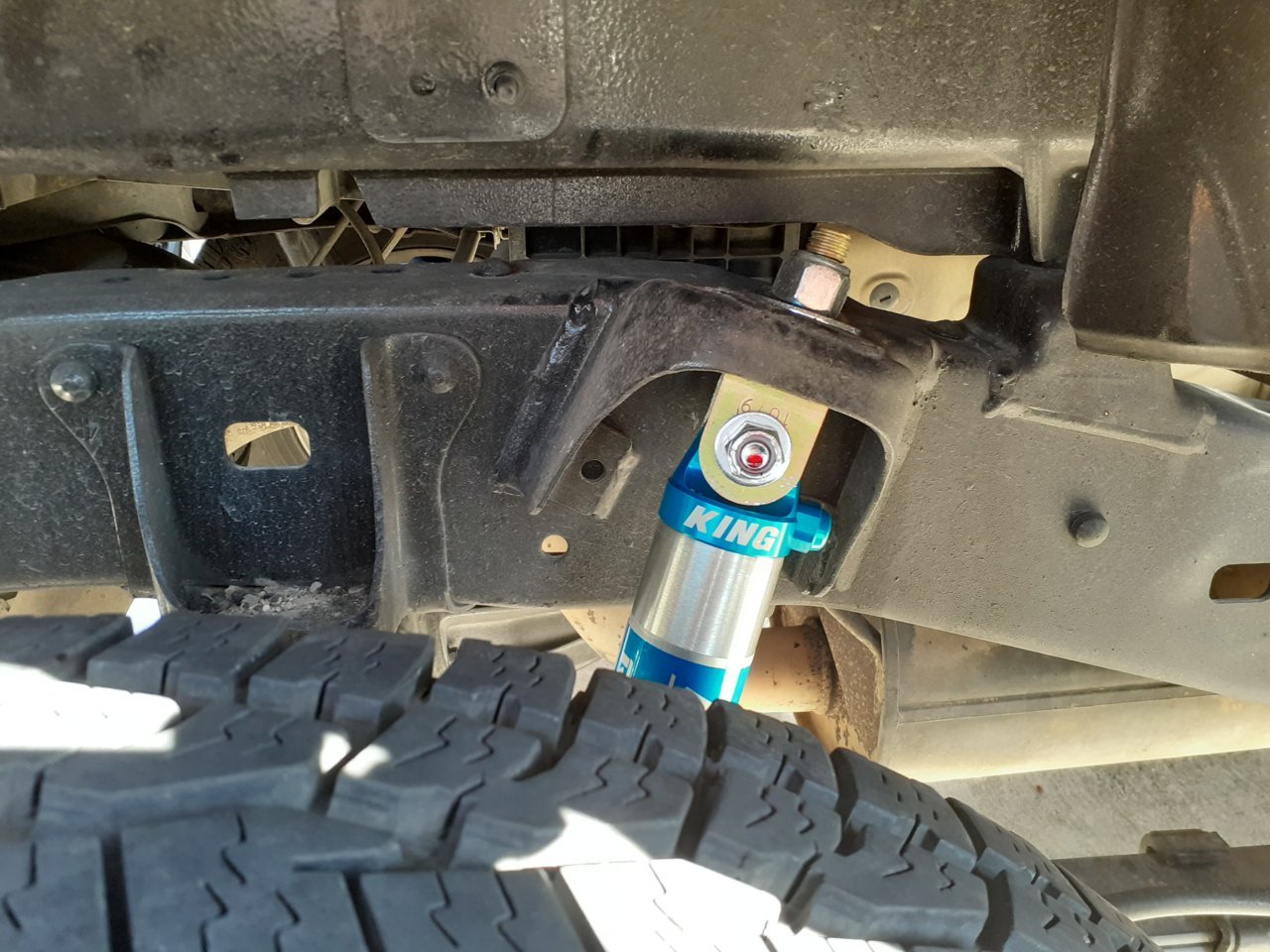

    After all is said and done, what comes to my mind is that they should have supplied me with, or at least included, the SAME bushing/insulator that was on the top.
    Then the bottom would look the same, instead of this
    But, that's not what they gave me. So I did what I did. Might send a note with pics to Down South after Christmas.

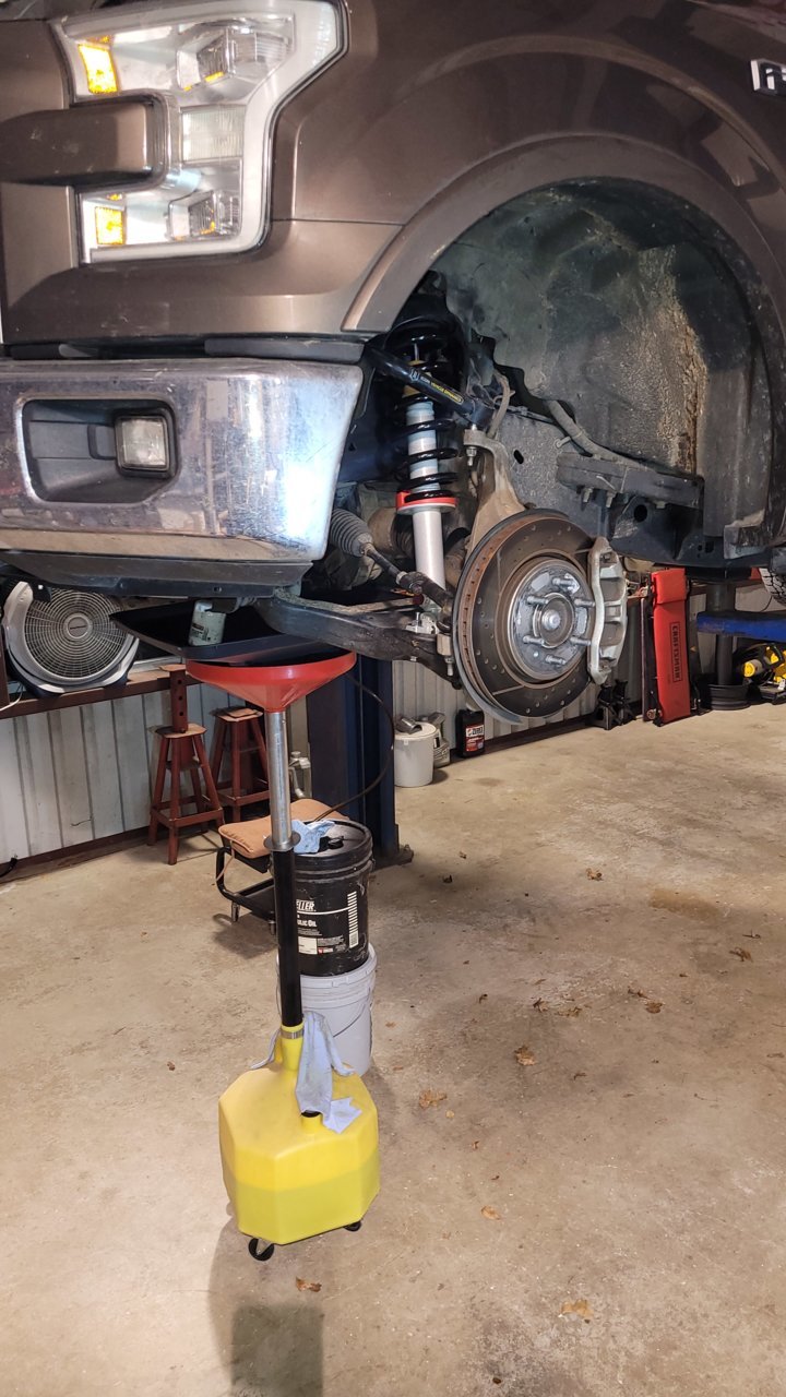

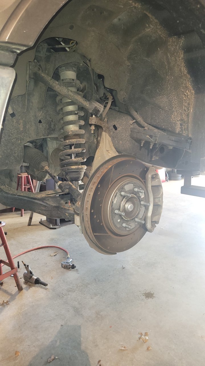

    Out with the leaking icons, in with the Ranchos. Oil and filter change as well, maybe plugs tomorrow.
