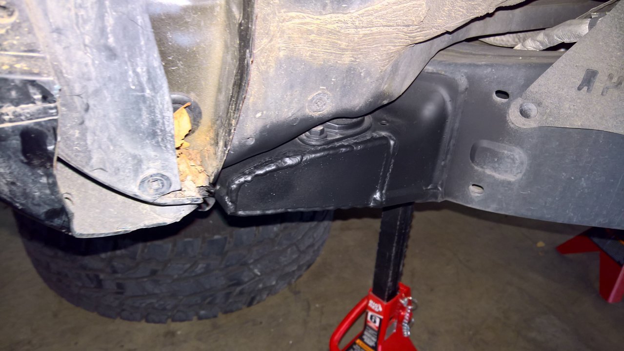

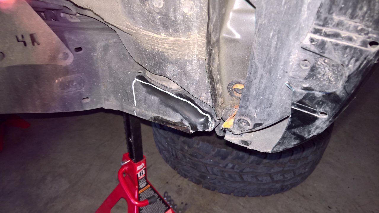

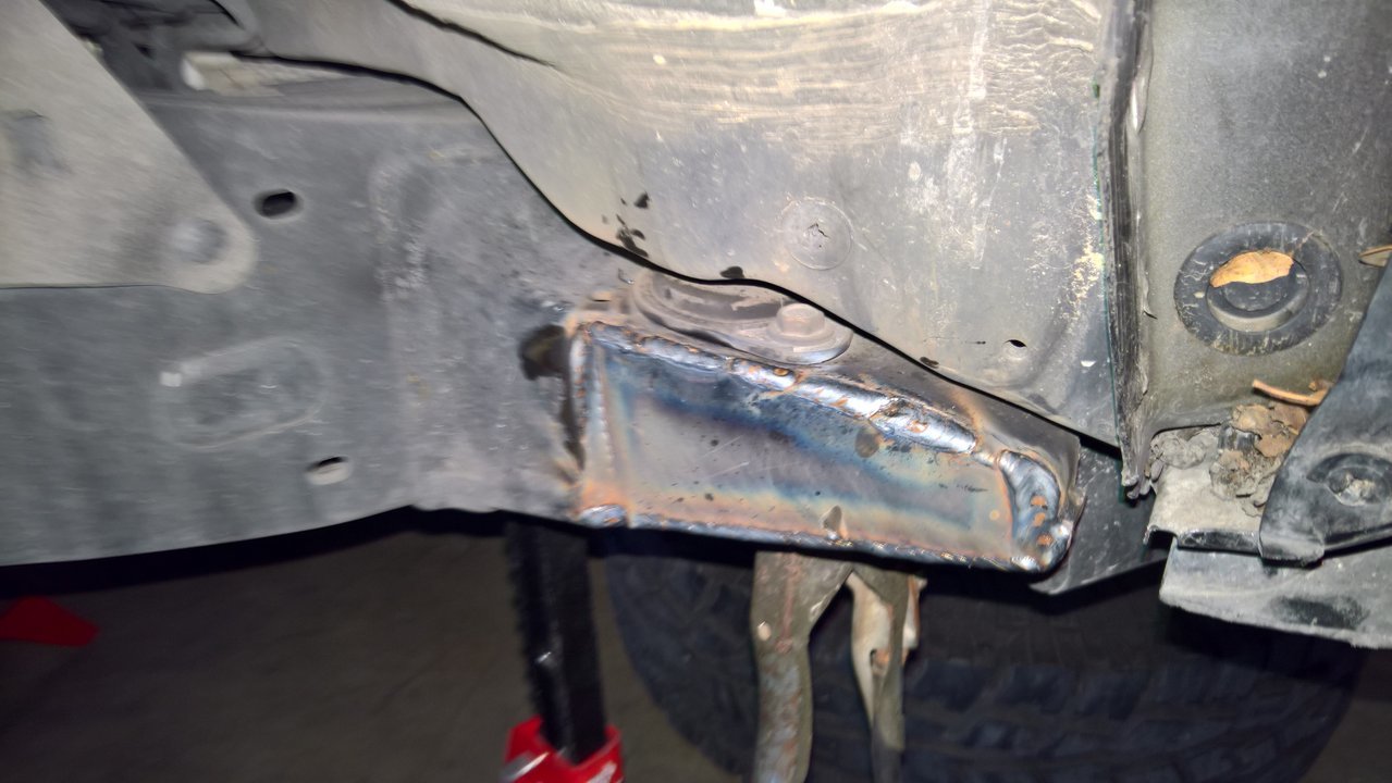

    I've done a few, different styles as well. Let me know if you do it yourself, I can give ya some tips. Or you can bring it out to my place and I'll melt ya some plates on.
    WP_20180113_08_58_49_Pro.jpg WP_20180113_09_41_01_Pro.jpg WP_20180113_10_10_31_Pro.jpg

    Don't use a plasma cutter on the cab mount, that bushing will light on fire. Angle grinder works just fine.
