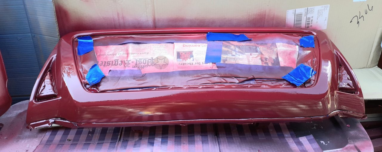

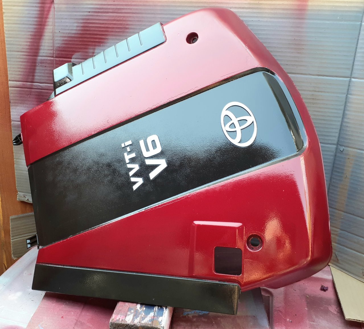

    Hola, SA! Mowed, got my third Clear coat on the project parts, cleaned underhood, and me and a beer are going here...
    Shiny. Not tan...

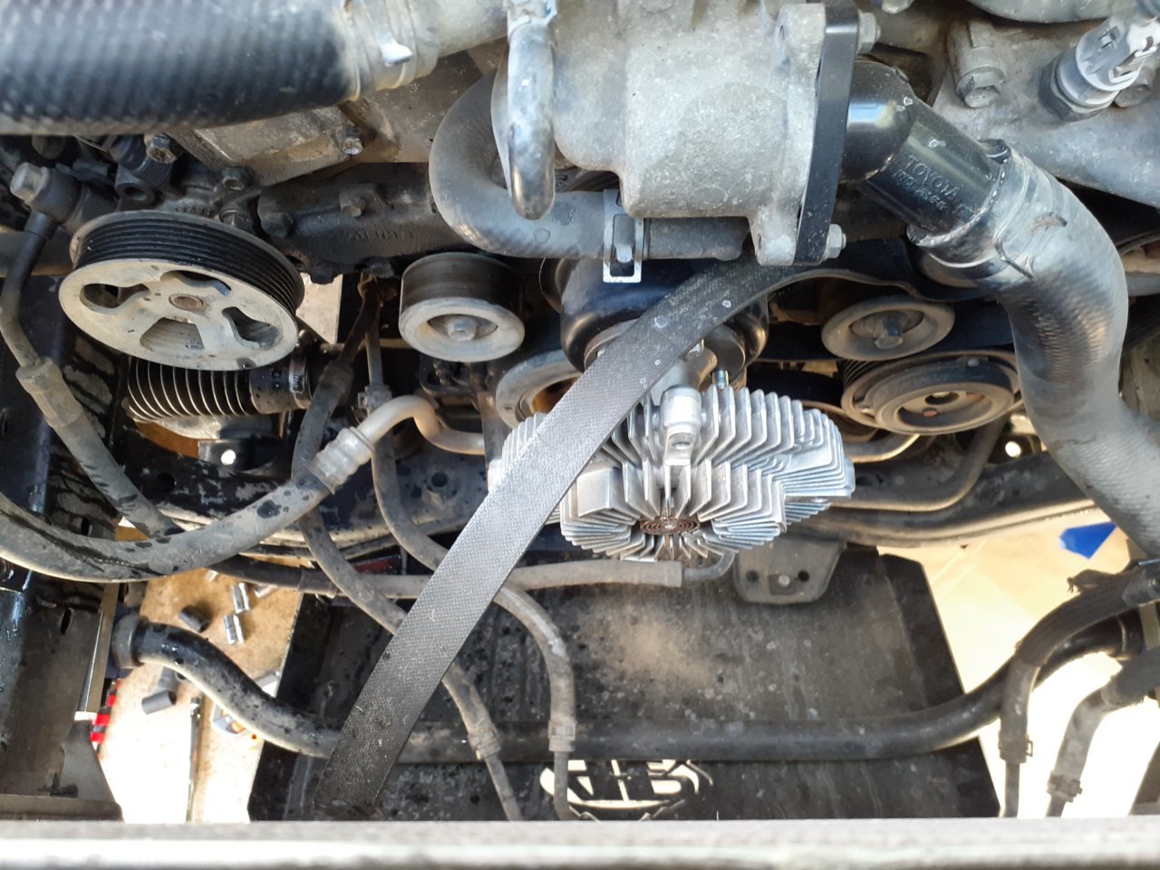

    :pccoffee: Good Morning SA!! Welp, kind of a lousy weekend. Wife decided to run errands a little longer, so I put off going to the Lockhart airport fly-in Saturday morning. Too hot on the tarmac when she got back. Decided I would pay a bill for her, and wash the honeydew off the truck after a quick stop at the store. Truck blew up there in the parking lot. Smoke, stink, would not run. Finally got it to start, and made it home quick as I could; no power steering, no alternator (light on), and temp pegging. So, figure I threw the belt. Ran and got one for Sunday repair - spent the day fuming.
    So Sunday, the best way in there is from the bottom, removing the skid plate. Get front four bolts - two in back refuse to take a size identity! And my pinched nerve comes back, making it just painful to even get in there and out. Give up. Go from the top, I will. Shroud loose, fan clutch bolts off, and "the fan pulls right off". No, it does not! Bang, pull, Blaster, not moving. Painfully removed the fan from the clutch on the front, and get stuff out of the way. So what broke the belt? Idlers good, alt and ps seem OK, but the water pump feels like a pepper mill with the last too big corn in there. It's puked.
    So, watched some videos, messaged a friend who gave me some confidence, ordered the parts, and that's what I'll be replacing this week.

    That job is not too bad just don't lose those nuts for the wp pulley. Put some cardboard on the backside of the rad so when you reinstall it'll protect the fins.
