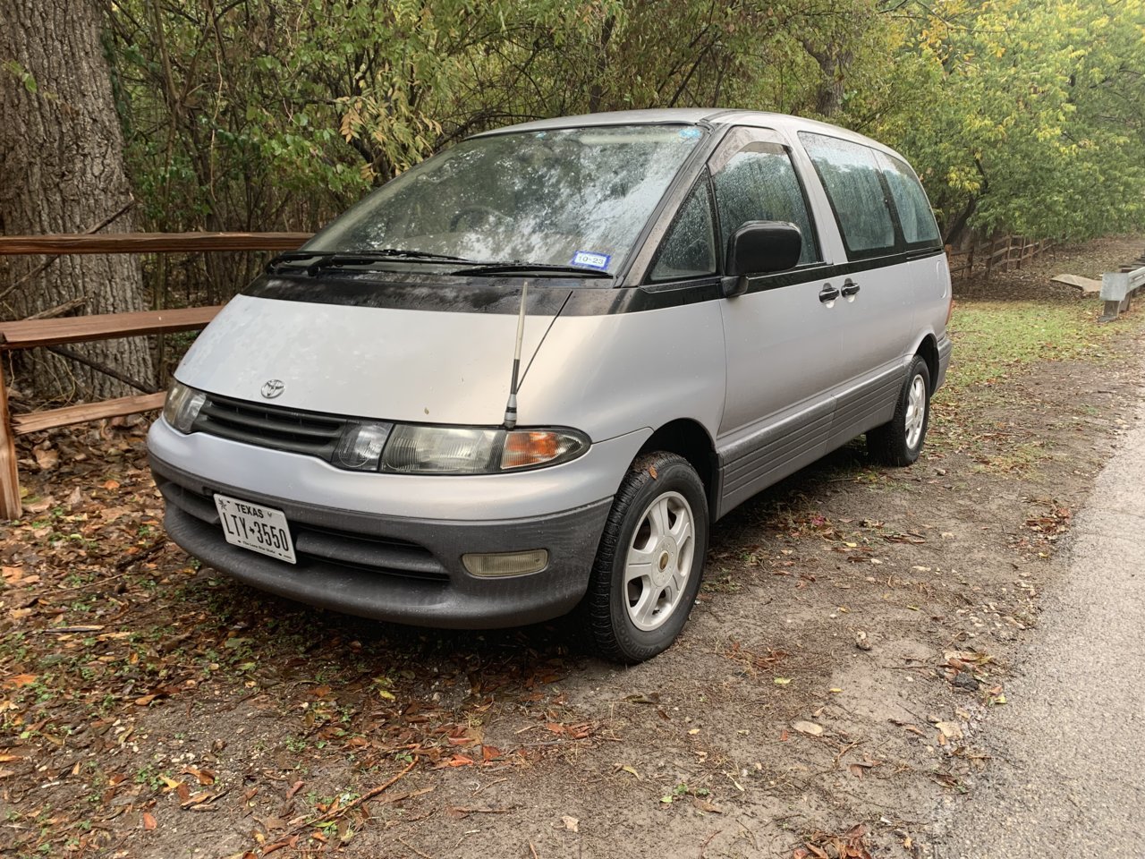

    Hey guys. I’m in a rock and a hard place.
    Got my 1993 Toyota Estima (2.2l turbo diesel) running again after being out of town and spending weeks finding somebody to work on it and change the fuel filter. It ran fine for about 50 miles, then it sputtered, lost power, and stalled on me. Managed to make it home.
    I’m really screwed. I drive for a living and now I can’t drive my vehicle. Spent the last of my money getting it “fixed” and now it’s out of commission again. I’m pretty sure I’ve narrowed it down to a fuel/fuel system issue since changing the fuel filter got it running again, but I really don’t have the mechanical knowledge to start taking the fuel system apart on my own.
    I spent all of my money going to Washington for a month to help my parents out, then spent the last of it getting the fuel filter replaced. Now I can’t return to work and I’m really screwed.
    Is there anybody here that would be willing to help me fix my van?
    this photo was taken literally a day after it was “fixed” and a couple hours before it broke down again. Shit is soooo aggravating…

    You most likely have air in the fuel system. Gotta get the air out.

    Turns out the mobile mechanic didn’t prime the system after installing the new filter!
    But would air in the fuel cause black smoke with the loss of power/sputter? If so I might actually be able to fix the issue myself…
  10. Nov 17, 2022 at 7:47 AM
    Spencerk
    Spencerk Redneck gun nerd
    Apr 19, 2012
    #77218
    166
    Spencer
    San Antonio
    2004 Honda Element AWD /no more reg cab 4x4 :(
    I’ve spent the last few days using google translate on foreign forums trying to find the issue. I think it might be air in the fuel lines. I talked to the mechanic and he didn’t prime the system using the plunger on the fuel filter cap. Gotta wait til my apartments employees/manager are off site (we aren’t even allowed to change our batteries on the property) but I’m going to attempt to prime it and drive the estima around my neighborhood to see if that solves the issue.

    Yes. I would ask for some money back since he did the job wrong it's not hard.

    @Spencerk you might have to crack the line going to a fuel injector while it's running to get the air out of the system. This is how i've bled fuel systems on a 5.9 cummins and Ford diesel tractor in the past.

    Most likely yes. You can try the plunger and sometimes that's good enough but cracking the injector will eliminate doubt that fuel is get to the injectors. That's all you really need.
