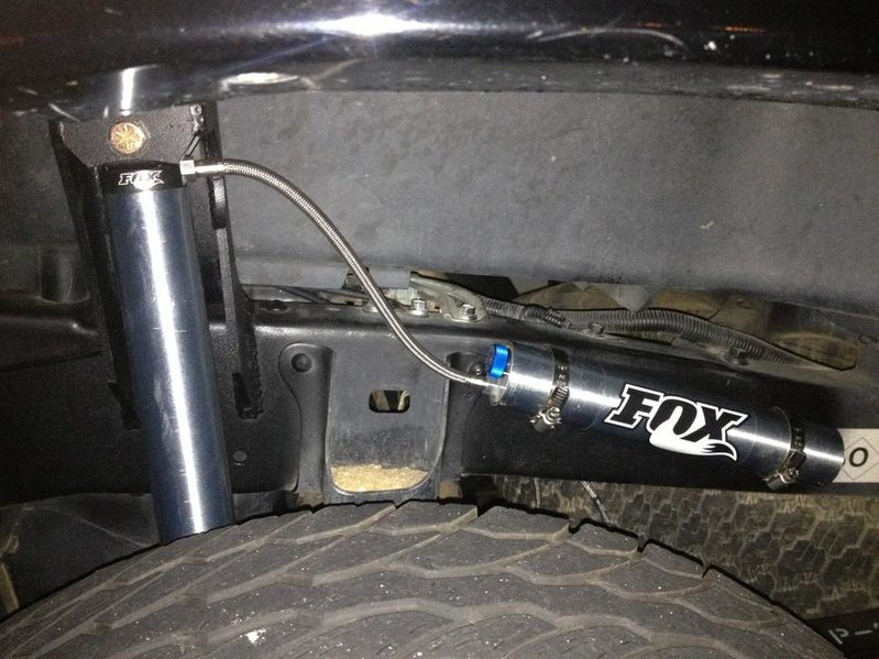

    Now I just need some hydro bumps to get the rear completely done :)

    hydro bumps? no you dont

    Well, getting some Superbumps for now...to at least replace the stock bumps...

    jeff why the F do you need to replace your stock bumps? The stock bumps for what youre doing will be fine, your not a LT or trophy truck, dont waste your money.

    To he honest, because I'm getting a camper shell and recovery gear, and a bumper from Tyler, so enough to weigh down the rear enough that high speed bumps will have me probably hitting the bumps. I'm not buying anything yet until I test out the current setup and see how the rebound is off the stock bumps.

    using a hydro to make up for the shocks lack of performance is not the way to go.
    Shocks are everything btw

    again, go towards shocks and not hydros, make the shocks do what they are designed for before thinking about bumps

    i some how doubt you're doing a high clearance with a tire gate, so the weight will actually be pretty close to stock. Even with a camper shell and recovery gear you should be more than fine. I mean Im rocking a hc rear, heavy ass tire gate, 10 gallons of fuel, and a high lift, and the coup de grace.... all on a stock 3 pack with an aal!! Save the cash and put it towards something else.

    My rear bumps are getting a serious workout. All because shocks are too soft, once valving is set on shocks i expect the hydros to be there mostly for the hard hits. I'm all up in em right now tho.

    as a point of ref, my mid set up used all stock bumps, I carry alot of weight and an Expo trailer, and never had an issue, you've seen the vids, that was because I made the shocks do the work they were intended for, and pissing off my tuner...ROFL!

    jeff i have vids with OMD leafs, king re-valved oem replacements and 400+++ lbs in the bed, plus 3x gas cans, hilift, 178LBS rear bumper, icechest, its in my sig.
    Stock bumps but right valving.
