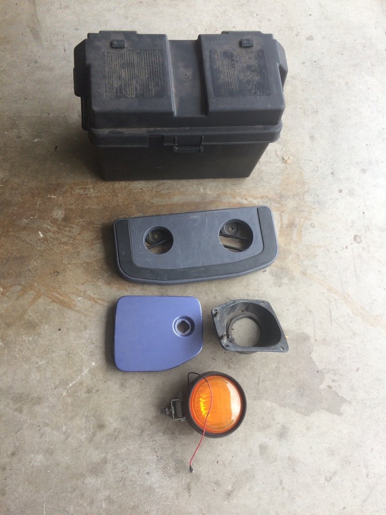

    Some more free stuff if anyone wants it. Muffler back is still available too
