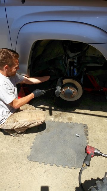

    Got the alignment done and the toe was off, all good now (for $69.95). Well, I hope so... because he did try and get me to pay $100 for a diagnostic of my front diff and right bearing he said both sounded bad!? I told him no thanks, I have a mechanic (Jason/ Speed Freek)!
    Speaking of Jason, I went to him after the alignment and got new brake pads installed... Thanks Jason!

    Thank you again for your business David! And thank you so much for those Baja books you gave me!!
    Both your wheel bearings checked out, no play or notchy feeling during rotation. And your diff being bad, I have no idea how he came upon that diagnosis, especially without a test drive! The sound you are hearing is 95% going to be your front tire wear as I saw some slight cupping on both front tires.
    If I was shady I could make so much money on tire noise, lol. Just rotate the tires and tell the customer I replaced both front wheel bearings!!
    Unfortunately A lot of shops will do that without blinking an eye, one reason techs can get a bad wrap, that kind of stuff really pisses me off
    If it still keeps making sounds after the tire rotation/balance bring it back and Ill dig into it some more for you and I'll figure it out for you.
