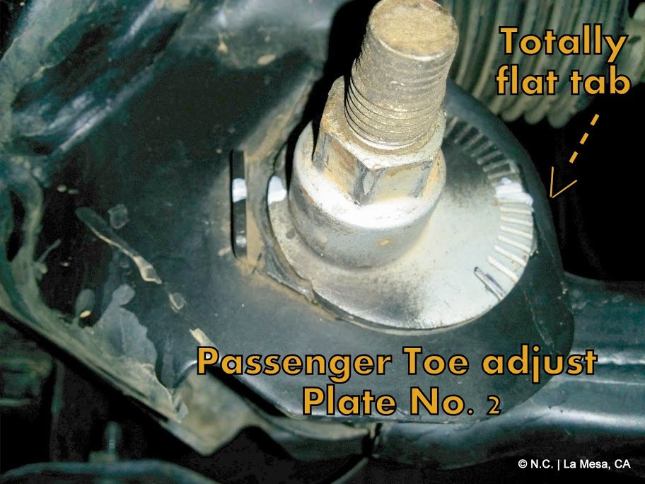

    Sorry if I sound stupid, what do you get out of upgrading the cam tabs? Does it allow for more alignment?

    It's a reinforcement because the soft thin factory sheet metal doesn't hold up and tabs get flattened out pretty easy.
    Here's mine before Jeff fixed them up for me.

    What Crom Said, the stockers are super weak and the upgrade will assure you never ruin or break your stock ones. I have seen techs ruin them during adjustment even...

    Most of them get damaged DURING alignment adjustment as the tabs are weak and break when the cam bolts are turned since it uses that small sheetmetal folded edge to lever off of when its rotated.
    The other ones get damaged from shearing the stock ones if your suspension takes a hard lateral hit in extreme circumstances.

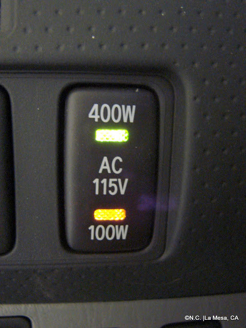

    Are the words are visible too?

    I don't know man. It's just a button. This is what mine looks like.
