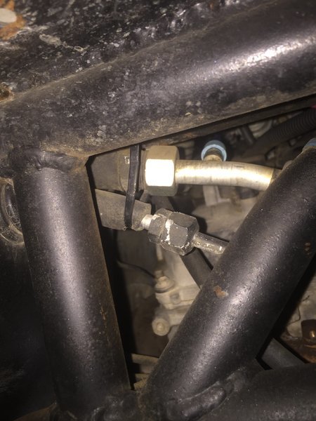

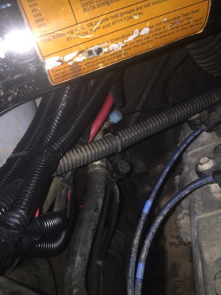

    Well looks like my truck is never gonna have ac again. Will not take a charge what so ever....
    @Speed Freek you do a/c work?

    will not take a charge as in the low side port is not letting the freon in?

    Yep, is it just leaking out, what have you tried so far?

    Okay so when I got the truck the ac worked great for a long time, but the conpressor squeeled loud for a minute. So when I did the motor swap I left in the new conpressor. Like a retard I put my battery to far in and it was in the way of the ac lines. I bent them down slightly and figured these line usually snap right in half if they break. Vacuumed the system down and held -30 for a hour. Awesome. Charged and and the ac was great for about a month! That was in May. Checked last month and completely empty. i replaced the shraeder valves and drier. Vacuumed it down and it held for 15 hours. Went to charge it and the freon absolutely will not go into the lines. Tried to re vacuum and the pump sounds differ t this time. Removed the valves and didn't see anything odd.
    Also got uv dye everywhere during this process

    I NEED my ac. I've spent so much time working on the system there's no way I'm willing to give it up.

    That's what it seems
