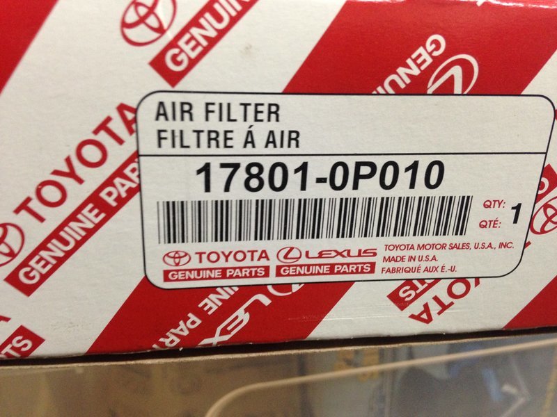

    Cleaning out the garage today and came across a new/unused air filter for 2nd Gen 4.0L engine. So if you're local and can use it, it's yours just swing by and pick it up in the North Park area.IMG_2652.jpg

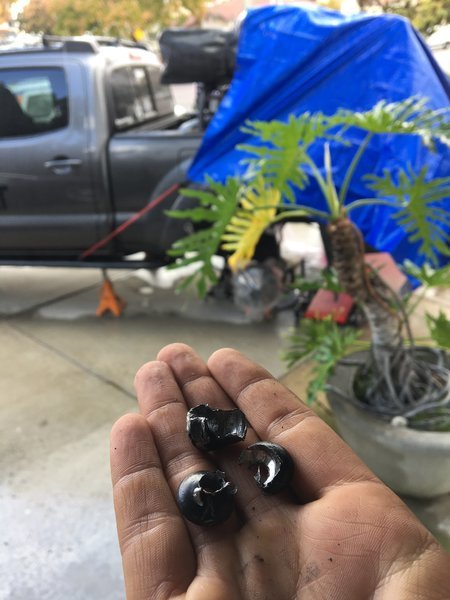

    Okay boys! IMG_0383.jpgOne side is done! Gunna work on the other side!
    Got my method kinda down:
    -grind flush all four rivet heads
    -go from inside the frame and pry bar the hanger off to expose more rivet
    -grind all those flush again
    -drill out 1/4
    -drill in with 1/2 barley
    -use 3/8 bolt and vice grips with a 4lb hammer and wedge it inside the hole and then beat the living shit out of it!
    -for the bottom two I took my floor jack and my drill to make a ghetto drill press and then went to down drilling the bottom ones out till I have enough room to beat them out!
    I'll keep everyone posted if I need further assistance. Just sucks working in rain
