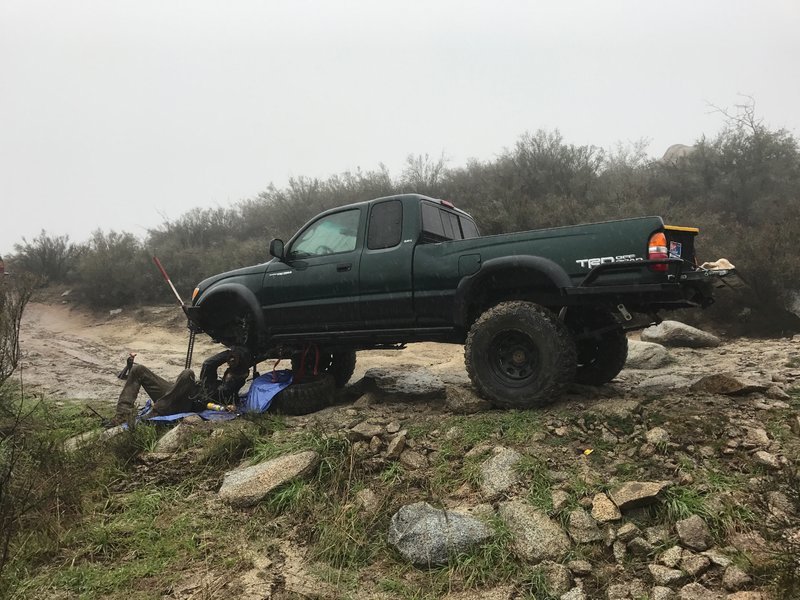

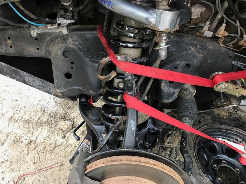

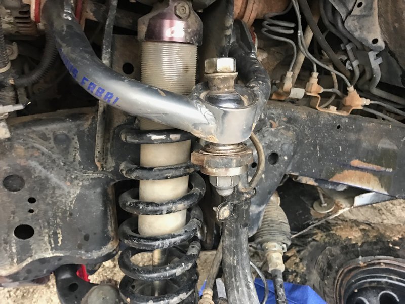

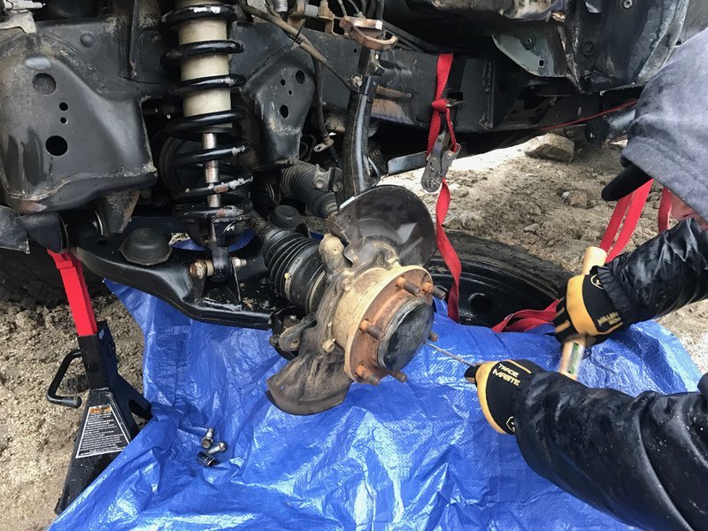

    Yes after hours of hunting a friend of a friend had one with a wheel bearing off his 99 SAS 4Runner. Picked it up, grabbed some parts and went back with a buddy. Pretty easy job minus the rain and mud. The brake caliper was tricky to get on as was seating the new spindle into the uniball slug adapter. Total fix time was about an hour and a half. Got off the trail, aired up and drove home. I'm getting a grinding/scraping/squeaking sound now from the drivers side which I believe is the dust shield self-clearancing against the inside of my wheel, however the sound comes and goes with speed and turning, it also doesn't make the sound when applying the breaks. Could be the pads also.
    IMG_0038.jpg IMG_0041.jpg IMG_0039.jpg IMG_0035.jpg IMG_0037.jpg IMG_0031.jpg IMG_0042.jpg
    Sorry for the photo dump. Oh and I came home to a nice present in the mail!
