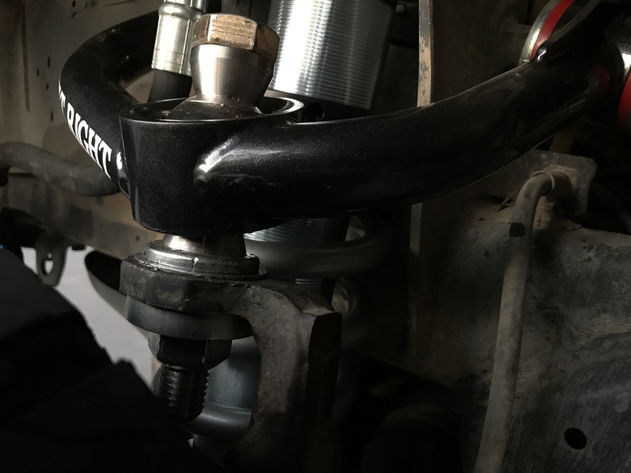

    Ahhh yes yes. Result is a black finger nail :rofl:
    Actually that happened the day prior. I tried to salvage a circlip for him, smashed my finger, circlip didn’t seat correctly which put him in last nights position haha.
    Forgot to update the thread, we fixed it! Lol.

    Sorry, don't have solution to offer however when I was looking at your photo it appears that your are using a coarse thread bolt which is pretty unusual. Generally you want a fine thread bolt that you can torque tighter and does not create as much " slop " if/when it does loosen up. I've never seen a kit with coarse hardware ?

    It’s @Titus94 ‘s truck.
    Good to know, I was unaware of that. Thanks!

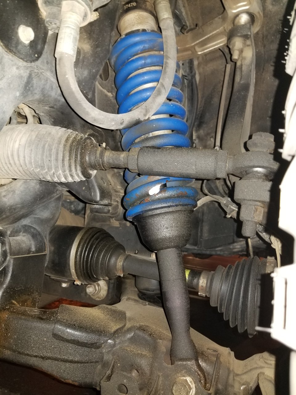

    Yup.. that's a King 800lb coil spring that just snapped on me.. on pavement.. at a parking lot.. while going over a speed bump. After all the wheeling I've done with my truck in the 2 years I since I got these coils on, the spring decided to give up over a freaking speed bump at 5mph. I got the springs from @Downsouth Motorsports brand new.

    You act like that’s a bad thing. Be happy it wasn’t on a trail and leaving you stranded.

    Looks like a good amount of preload too. Look for a longer replacement and into linear or progressive springs too. I’d replace both sides at that point.

    I don't think it is preload, he has a drop bracket lift kit on the Tundra so those a re longer CO's but since it is still stock travel just a normal length spring.

    That makes sense.
    I’d still stake advantage of a longer replacement that gives the coils more room on compression.
    The super bumps can also compress more than stock bumps, maybe they need to be extended too to prolong the new coils life.

    Kings doesn’t use the best spring material... maybe switch to an eibach spring check out their catalog they should have something to fit your needs. Their springs are made in the USA
