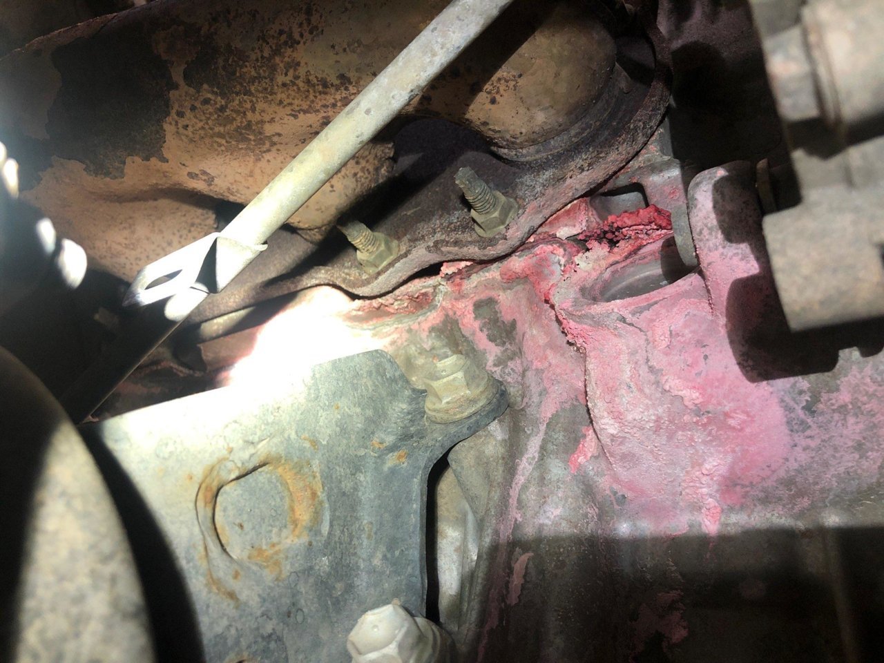

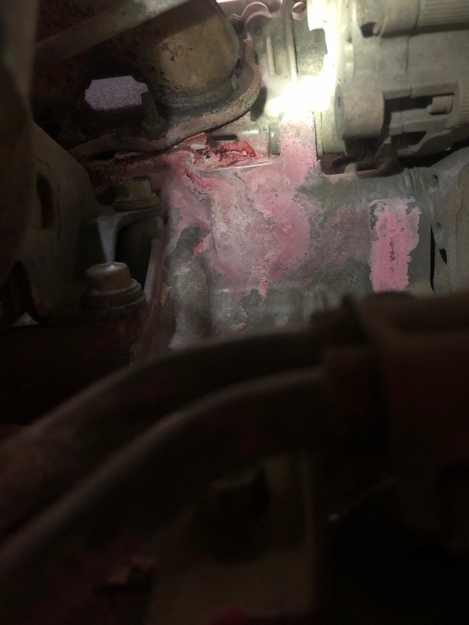

    Friend sent me these pics. 2011 4.0 92k miles. Dealer says HG and I agree but he has no codes or misfires. I told him to have a leak down test before he spends the 4K. Any thing I may be missing?

    Waiting for better pictures. I can’t tell where the leak is coming from.

    Make sure its not the freeze plug first. Wont show misfire since its an external leak and not affecting compression, just my .02
    Run a coolant pressure test and see where the drippy drip comes from.
