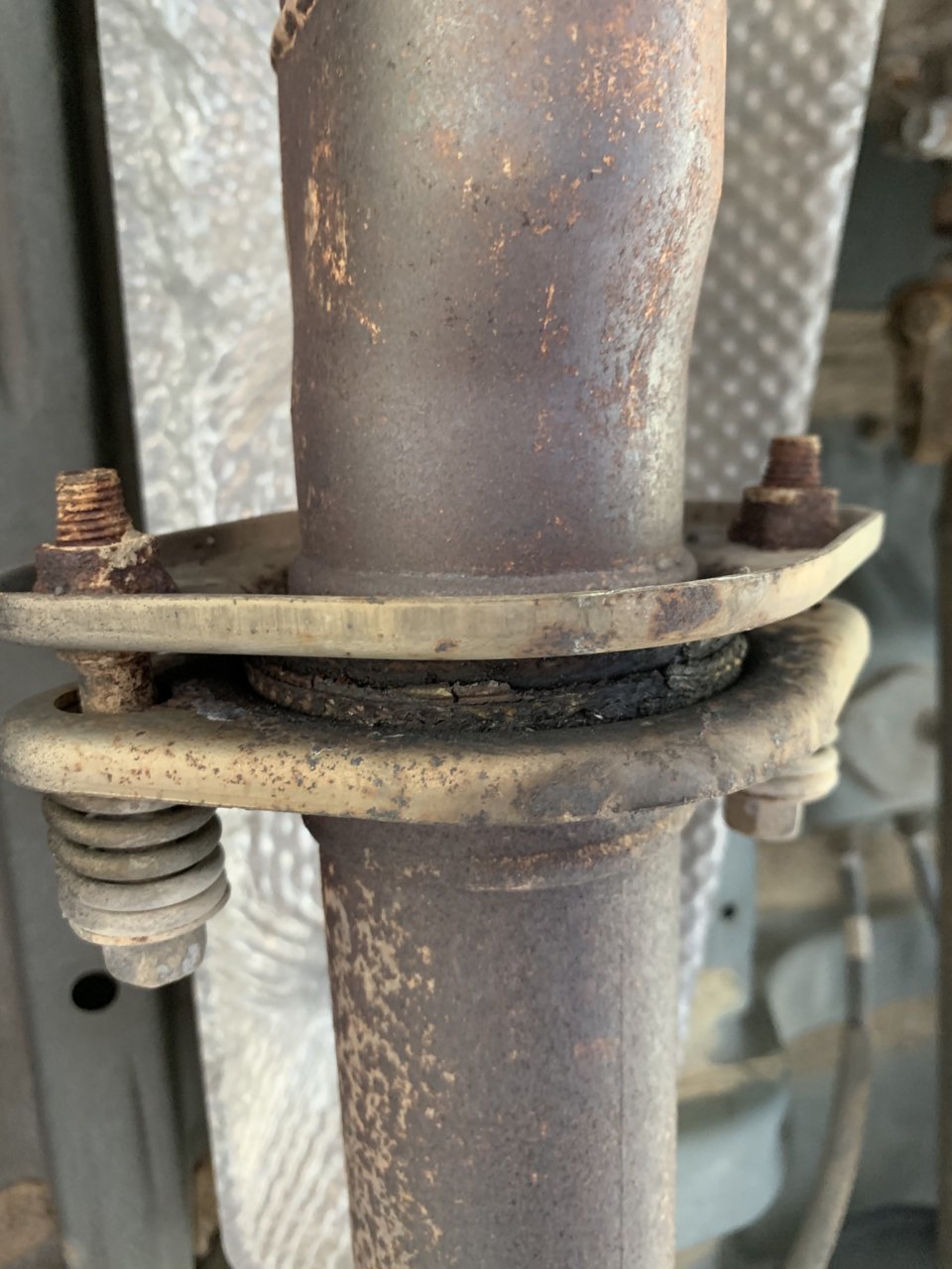

    Go and check right now. Turn the truck on, get under it and hold your hand up for any air leaks around the flange.
    I’m talking the front flange right after the exhaust drops from the engine, not the muffler flange.

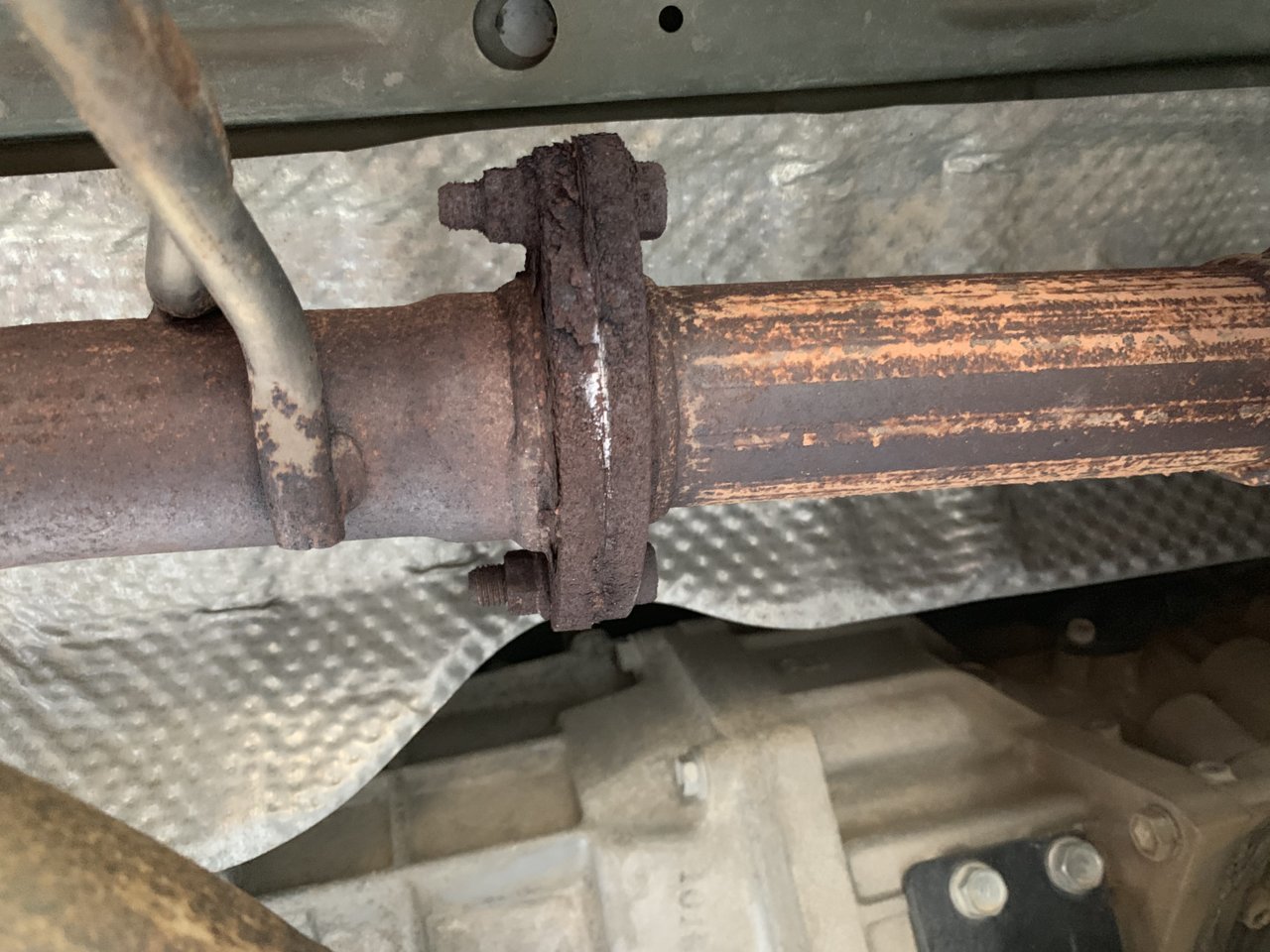

    This one right? I didn’t feel any air leaking, but I did see a video where it said that aside from any air coming out, that to look for “black soot” and although there wasn’t much here. I did see quite a bit on another part..ABA4A52F-CE4D-49FF-8EAE-A2B0D90C24F2.jpg
    On here. Not sure if that’s another part that could be the cause, but again, I didn’t feel any air.

    Yeah, the first pic looks like the one. No air? Interesting.
