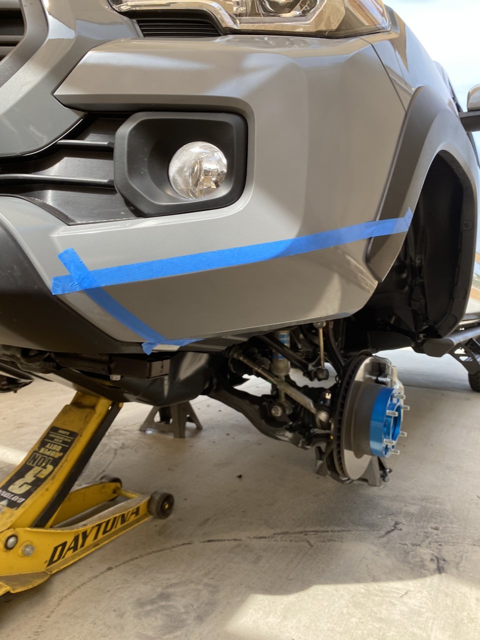

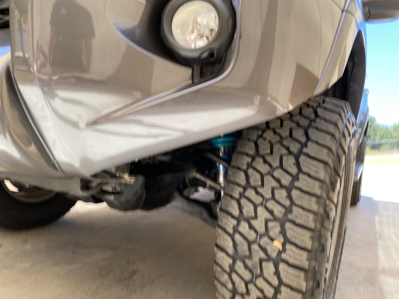

    Been doing a lot of Viper cuts lately and they look pretty good for such a simple mod, as long as you are good at cutting at straight lines!! Also helps ya avoid that stupid rubbing in the front with big tires.et

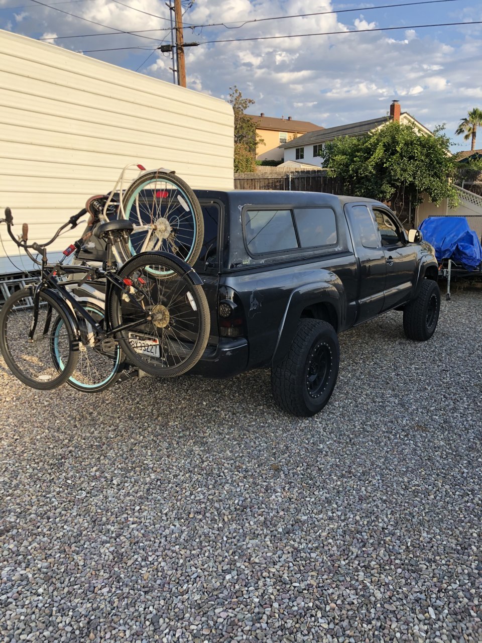

    Well shit, I took pics of the after but my phone lost them!! So I provided a crappy unfocused pic of a 4R instead, haha...dang.

    I got you fam. Haha, thanks again for squeezing me in last minute. Much appreciate it. The CMC and Viper Cute is exactly how I want them. I will definitely hit you up for future installs.

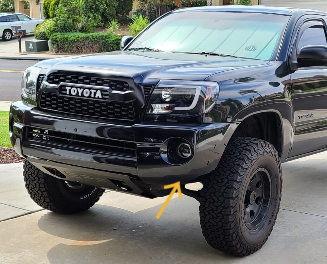

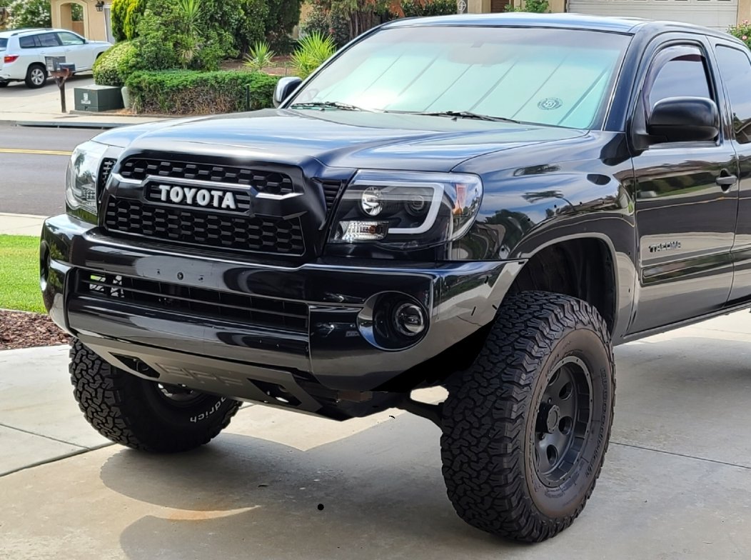

    Nice, Those look great. What did you use for a weapon? I want to use a jigsaw to help with straight lines.
    I'm planning on doing mine soon. Here's a visual.

    Well if you want a straight line the first thing I would recommend is to NOT use a jigsaw blade as its very small and will wonder worse than anything you can imagine, In order to make sure my cuts are laser straight I use a 5" cutting disk (thin) on an angle grinder, and once I make the initial cut I put on a flapdisk in order to do the final trimming up to my tape line, then afterward I take a file to remove any flashing. You want to use an angle cutter rather then a bladed tool for straighter cuts. I also use the same angle grinder in order to do high clearance rear bumpers to cut the bedsides.
    Also take the time to make darn sure that your tape line is correct since that is your template.

    Anytime, I don't mind helping people out if I can. Especially easy advice... hope it goes well for you, just take your time and measure 5x ad cut once.
