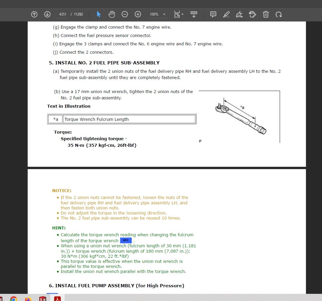

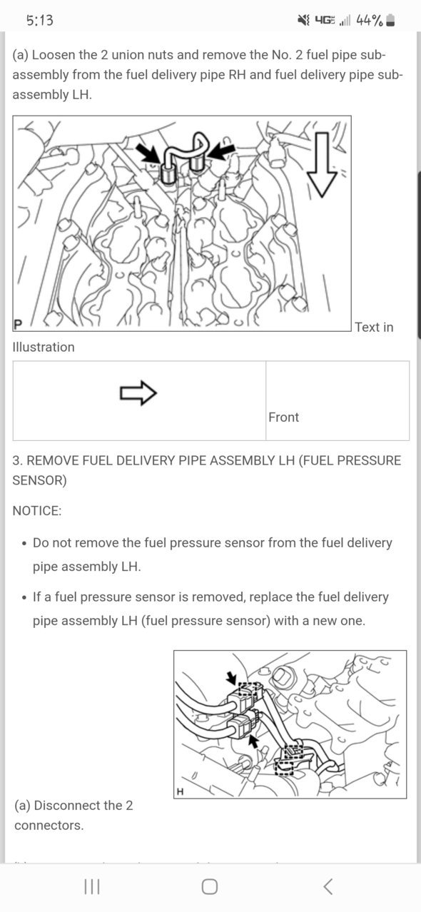

    Hey guys, I'm new to this thread. I have a 2018 taco. A few weeks ago I had a rodent get into my fuel harness and I was able to get some help from my girls father to solder that back together. Now I basically took over of putting my truck back together. But I then noticed I had a fuel leak. It was coming from the fuel feed line ( see pictures ) now I can tell the left one is slightly off its not centered. It's so difficult to move. I can't see to loosen the other one to be able to get that one in. I'm basically looking for help. And just for that line only the rest I have figured out. I really hate to ask for help. And I'm on here because I'm a single mom And can't afford to take it to a mechanic. I can shoot 50-100 bucks the most, buy you some food. I'm kinda desperate. I've done what I could on my own. If anyone knows anyone willing to help. I live near poway off the 15 fwy. Please no hate

    See I was told i shouldn't remove that sensor, and no one please come for me but I was using an adjustable wrench to loosen that nut. Cause thats whar my girls father used. But I wasn't able to get that other nut loosened. I bought some crowfoot wrenches and still wasn't able to get it off.

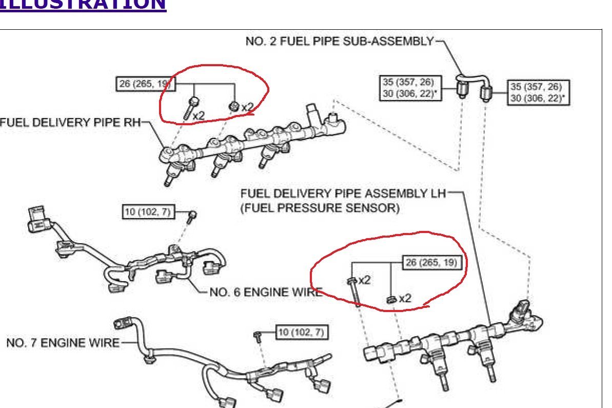

    Not sure if you looked thru the FSM. HIGHLY recomend that when messing with fuel. . You can loosen up the fuel delivery pipe bolts and nuts to give you some slack. Also it calls for a 17mm wrench on those unions. High pressure fuel lines are not fun. If that part is pretty beat up you might want to save up for a new one. Truck fire would be no bueno.
    FYI the manual also says that pressure sensor is a 1 time on/off thing. Those aren't cheap. Be careful what someone recommends unless they can quote a manual.
    https://www.tacomaworld.com/threads...-availability-pdf.485229/page-9#post-24156911
    fyi page 4343-4352

    Yes I read that not to remove that sensor. Also that line is like $50 at toyota I checked so it's not too bad if I need to replace it. I'm just looking for someone to help with that line. So if anyone again knows someone willing to help.

    I'm busy this week, but if someone wants to tackle it you just need to loosen these bolts first so the hard lines will match up.fuel 2.jpg
