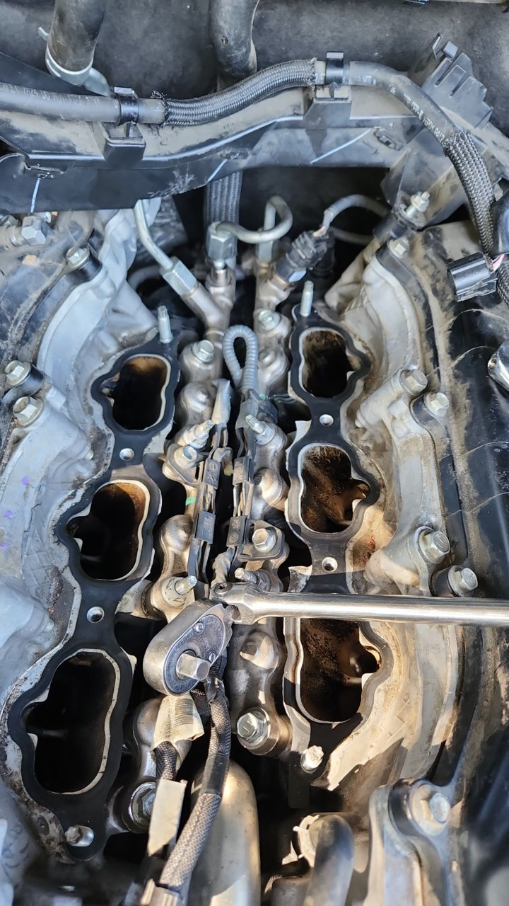

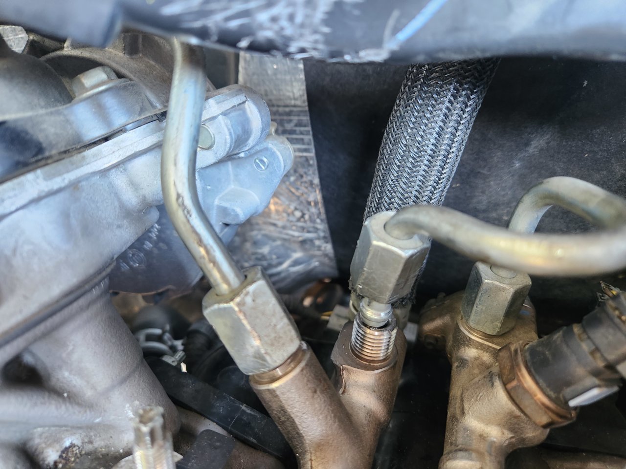

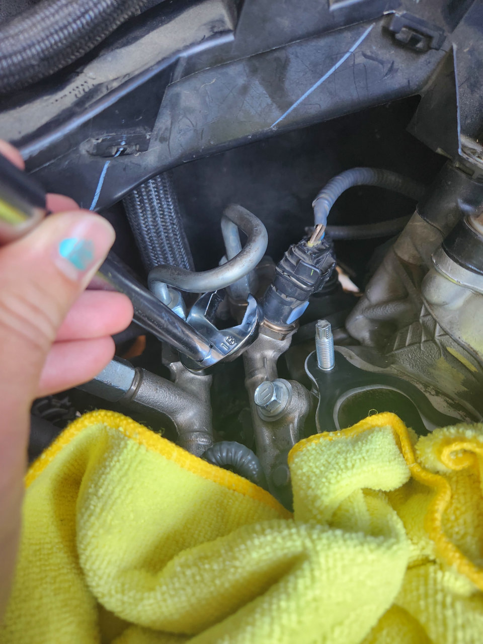

    So as I was saying yesterday that if you can loosen that rear nut on the line it should be loose enough to allow enough movement with some pressure to get that tip back into its orifice, putting a small bit of lubricant can make it easier.
    And I see you have a crow's foot you are trying to use for that rear nut you said the sensor is blocking, it looks to me like you can use a normal open end wrench, not that crowsfoot to get that nut loose so you can wiggle them back into place.
    If you try an open end wrench there I'm pretty certain it will work fine, looks like there is plenty of space from the pictures posted.
    I'm happy to help but don't do mobile work unfortunately, but from the looks of it I think you can probably get it done using the tips posted above hopefully.
    Edit: Also you can at least unplug that rearmost sensor and without the plug in place you will have even more space to get to that nut with a 17mm.

    Mike actually came out and helped with that line. So now I'm putting everything back so hopefully that fixed that. But I definitely have some more questions about my truck that I hope you don't mind that I ask you. Appreciate everyone's help. You guys are awesome

    Sadly it's still leaking, so hope it's just the line now that needs to be replaced
