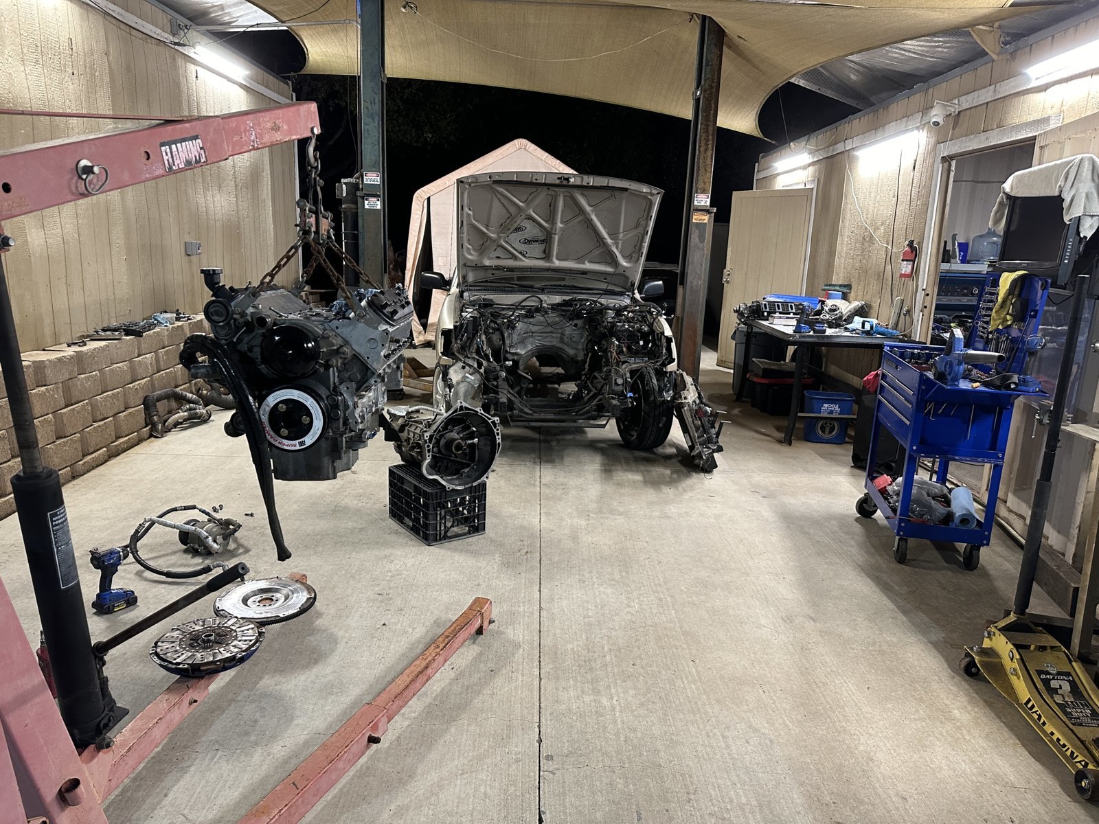

    My typical Friday night for this week anyway…I don’t get out much since I’m always working, usually until about 12am lately.
    About to put the clutch on the crank, pop on the transmission and then I can stab the entire assembly as once piece since that’s how I built this setup.

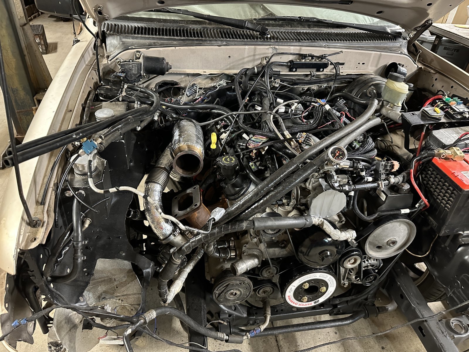

    It’s running again finally! But now as a 6.3 instead of the original 5.7 and the displacement was added by using a longer stroke crankshaft and honing the cylinders to the new bore dimensions with a completely forged rotating assembly.
    it was running on 7 cylinders due to a cracked spark plug shorting itself and refusing to spark in the proper place and one of my rear water vent line fittings got damaged and has a pinhole in it.
    Getting the new plugs today and new fitting tomorrow so I can start getting it all buttoned up and the dash fabricated (using a Holley Pro-dash for instrumentation) so that will be pretty awesome.
    Once that’s done I can achedule some dyno time and then I can program the ECU and see how it goes! Can’t wait to have it done”ish” since I still have to convert to AWD eventually, that’s going to be rather tricky.
