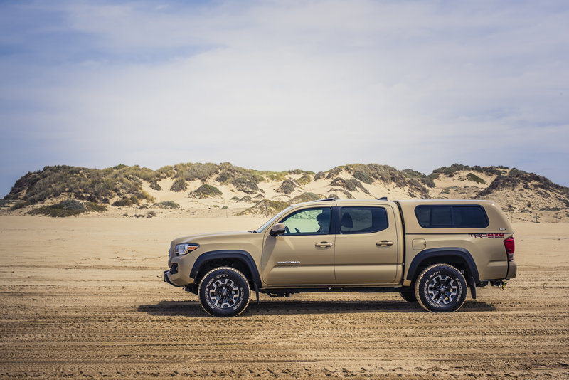

    Here is a photo from my recent trip to Pismo...spent the whole day there...windy with some sand in the air...ran the whole beach and some light dunes and soft sand...edge of the ocean with both wheels in...no issues and then off to Moab for four days in the red rock stuff...the only thing that I would add is that the fuel filler door area inside does collect "dust" and I wipe it out before opening the fuel filler cap...if the cap were off or ajar it could suck in some debris as the fuel sloshes around and is consumed...
    Spare Parts, 0210 and TacoJonn like this.
