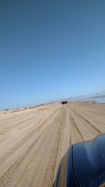

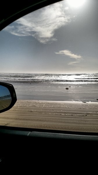

    Digging through my pics, hopefully this will help those understand how little water exposure it was.
    See where it starts to get wet from the incoming waves crashing on shore? When j turned around the pass side of the truck was on the very edge of that area. If it wasn't for a slightly bigger wave than the rest I wouldn't have gotten wet.
